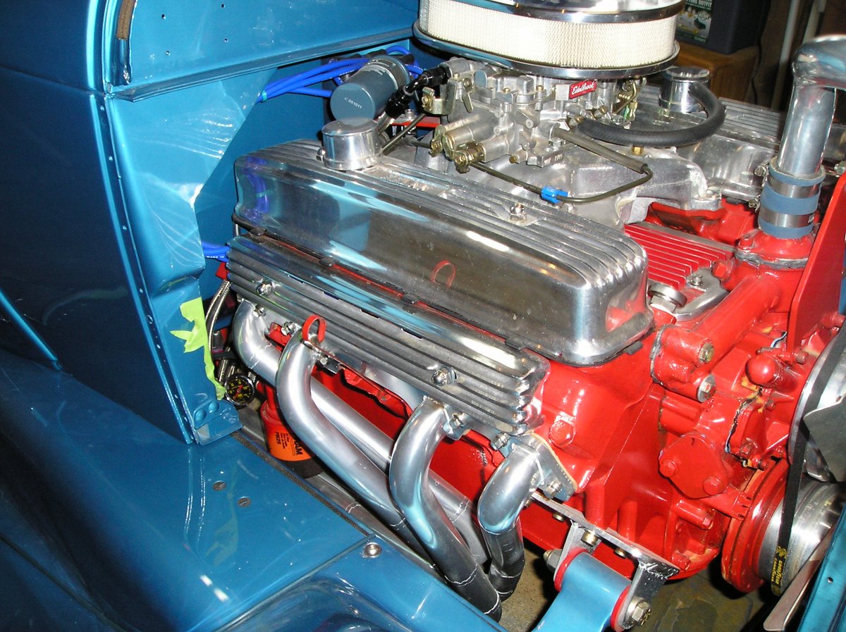

    I have a custom set of headers on my 401 nailhead. The tubes are 1& 1/2 ins diameter
    on the primaries with a transition section from the the square exhaust ports.
    These tubes feed a 3 ' collector. I'm replacing the 401 with a 425 bored .040 over.
    I'm told that my primary tubes should be 1&5/8 ins. I see that Sanderson headers for
    the 401-425 primary tubes are 1&1/2 ins. My question is " can I run my exhisting headers
    on the 425 or should I builds a new set using 1&5/8ins. tubing? Any advice you can give
    would be greatly appreciated P1010002.JPG .I don't want to burn the valves.

    If this is just a cruiser, you will be fine with 1 1/2.

    I wouldn't spend the money if its not necessary. Run what you have for now. The 401 and 425 all have the same size exhaust valves (1.5''). My personal opinion, the exhaust valve diameter combined with duration and lift (based off cam lift) of opening wont flow more air than what can fill a round 1.5'' pipe.

    Makes zero difference, run what you have

    Keep what you have and enjoy it . If you at full throttle all the time you may or may notice a difference . They type of headers you are running are really not noted for performance gains . Nice car and I love Nail Heads keep it alive and enjoy it

    I use headers based on the exhaust valve diameter.... Yours are perfict.. . ;):cool:

    If you ever do have another set built, I'd have them use 1 5/8" minimum (I'll be using 1 3/4" on the 425 in my '33 pu) and make sure the finished ports in the header are the same or slightly larger than the ports in the head.

    Keep what you have your not going to gain anything by going to a 1-5/8" tube. The 401 and the 425 both use the same heads and you can only pump so much air through those heads.

    1 1/2" is absolutely fine for a 425, they don't spin a lot of R's so it's fine. And Fram filters suck. Ha I said it.

    You will get better low and mid range flow, so they should help you where you do most of your driving. You would have to go to redline pretty much all the time to really utilize a 1 5/9" pipe. 1 1/5 inch primaries will support up to 325 HP reliably. Are you making that much power?

    Joined: Jun 15, 2020
