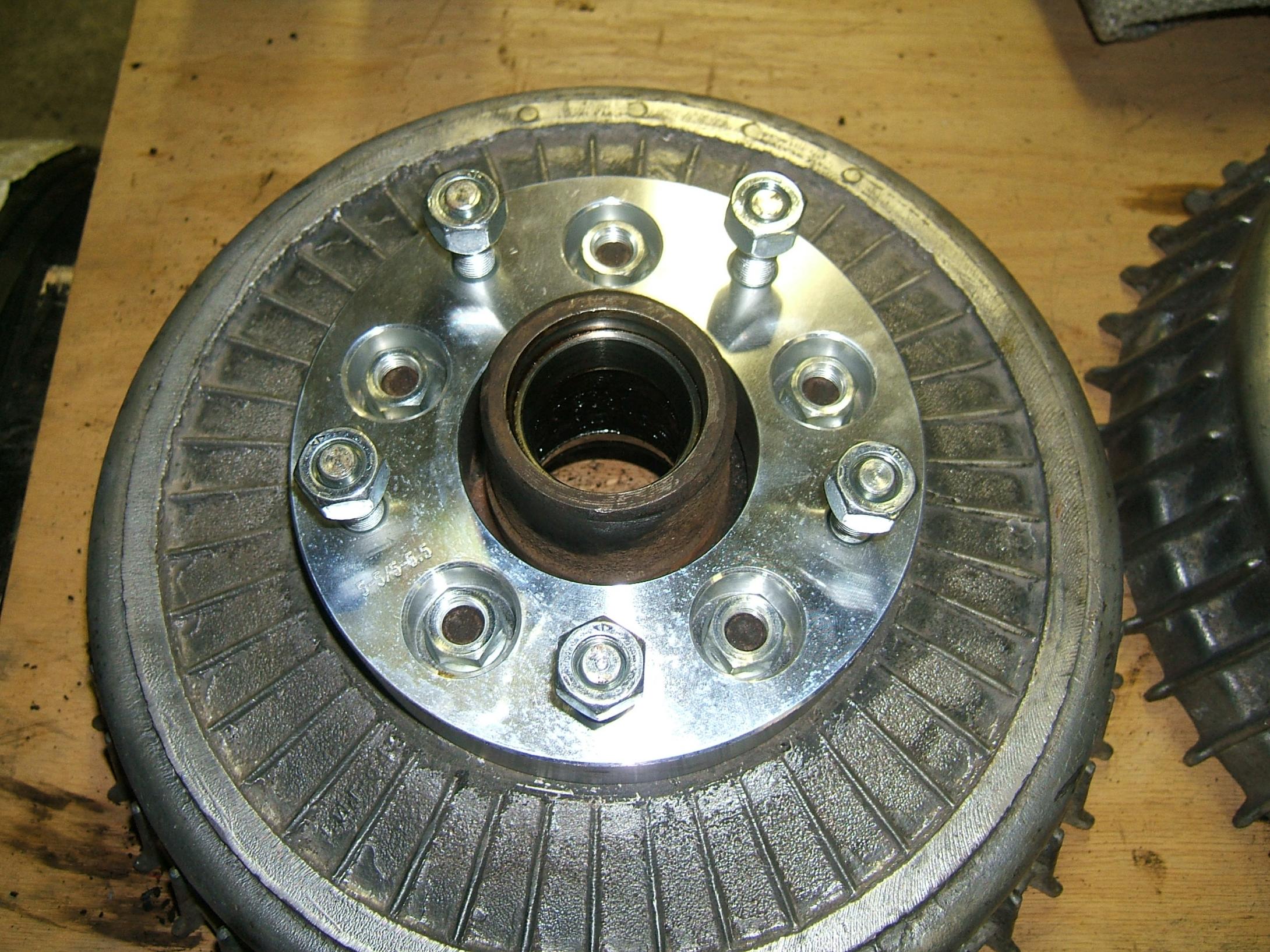

    I used 29Rat's adapters with my set up. Stock A spindles, my own adapters for adapting the 3 bolt '61 Buick backing plates to Ford spindles clocked 90* for the best fit.
    I wanted to run all Buick brakes and hubs and with his adapters I have been able too.
    BloodyKnuckles
