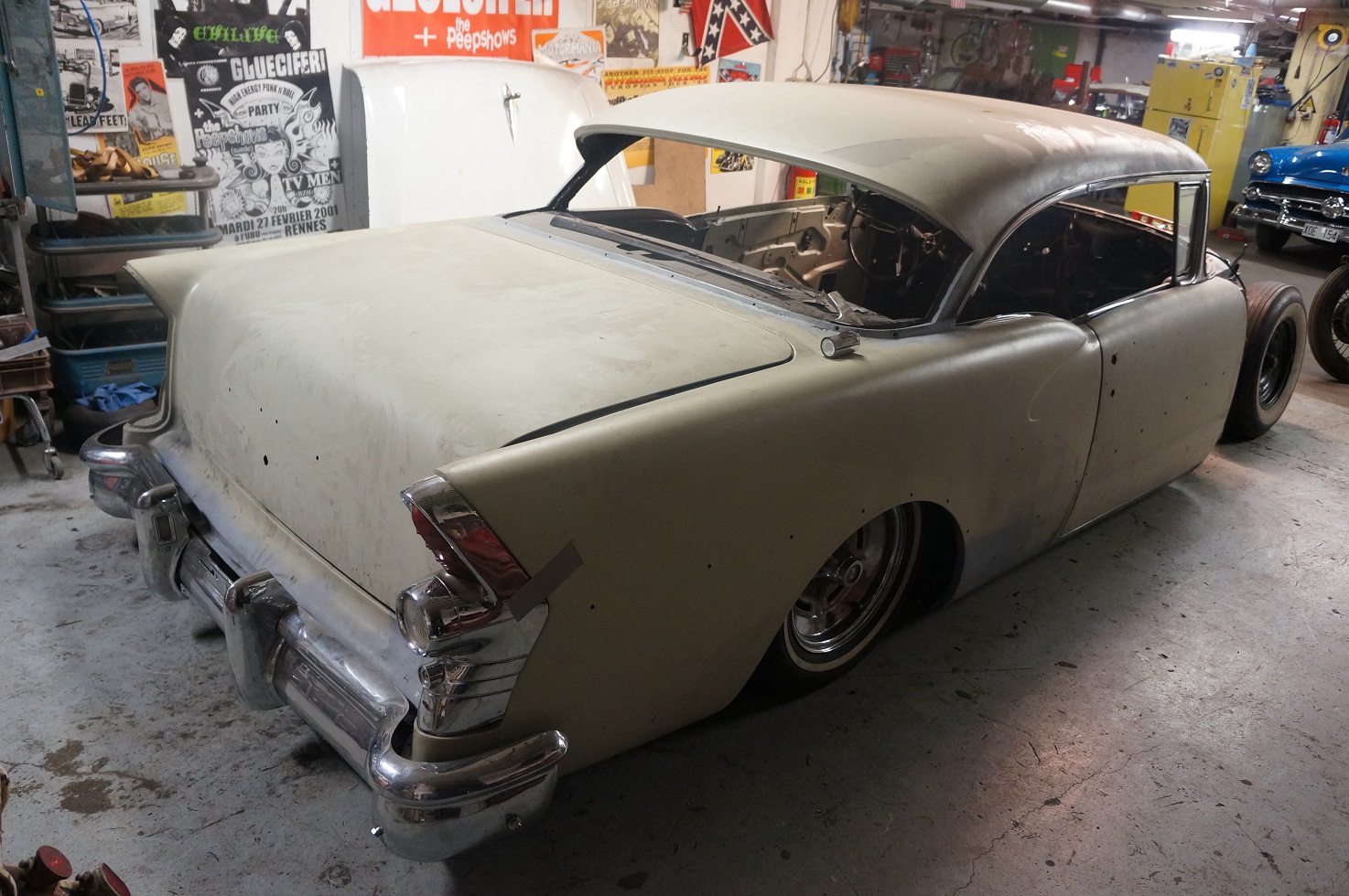

    So i was thinking maybe i should start a build thread here so here it goes :)

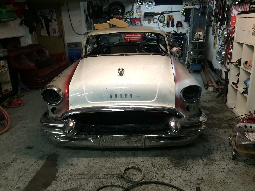

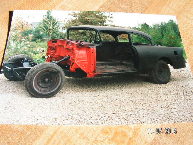

    Got myself a little project a while ago, a -55 Buick, dont really know why cuz i never looked at these models before but i stumbled on an ad and it was located pretty local so from there it was :)
    The plan from the beginning was just to make it roadworthy again, but over time i really started to enjoy the car and i was raising the bar a little higher and thought why not build something little more than just a regular -55 that no one notices.. So here comes a bunch of pictures of the build, still tons of work left on the "todo" list but hopefully it will be on the road next summer. / Josef
    First off some pictures how it sat when i found it and when it arrived in my garage
    1.JPG 2.jpg 3.jpg 4.jpg 5.jpg 6.jpg 7.jpg 8.jpg 9.jpg 10.jpg 11.jpg 12.jpg 13.jpg

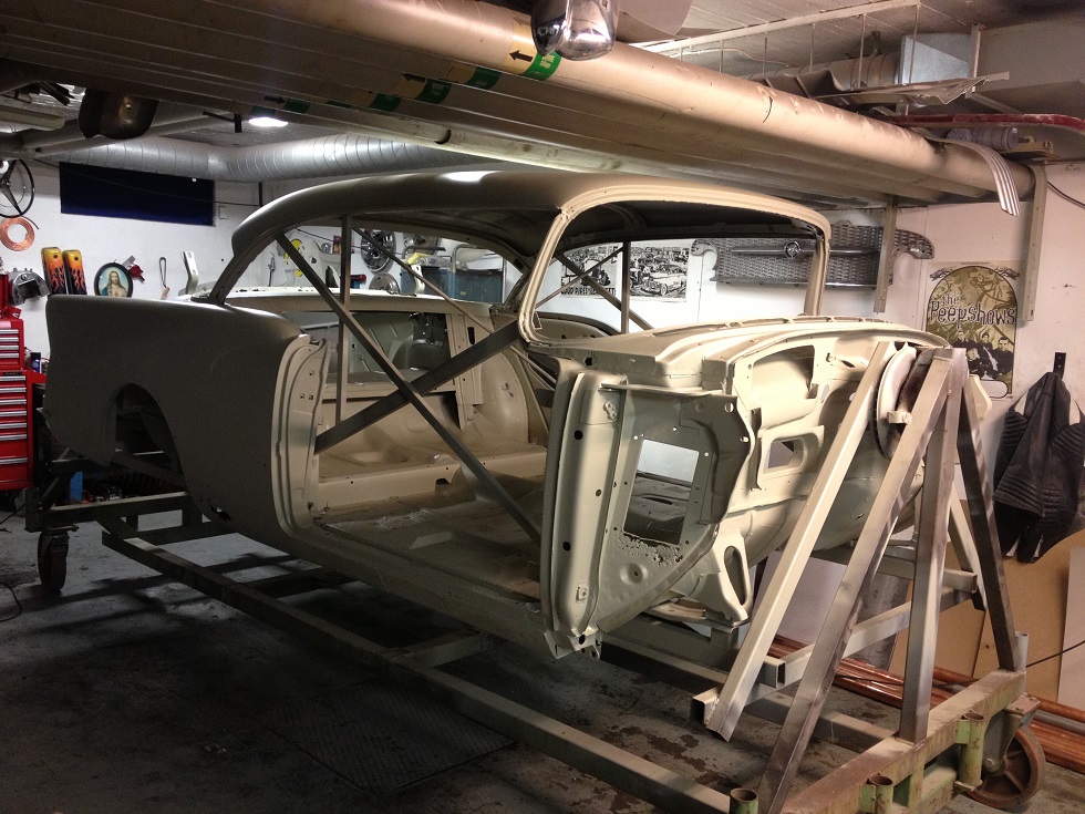

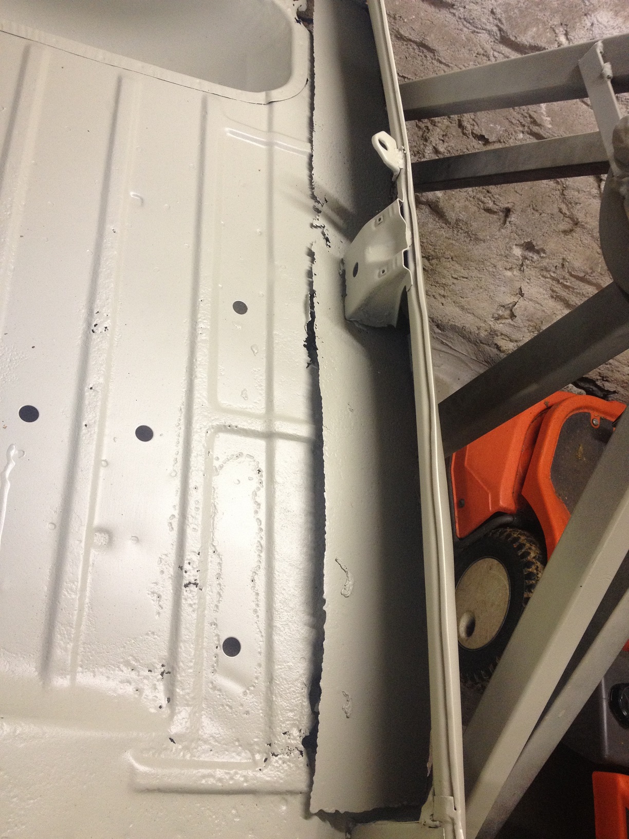

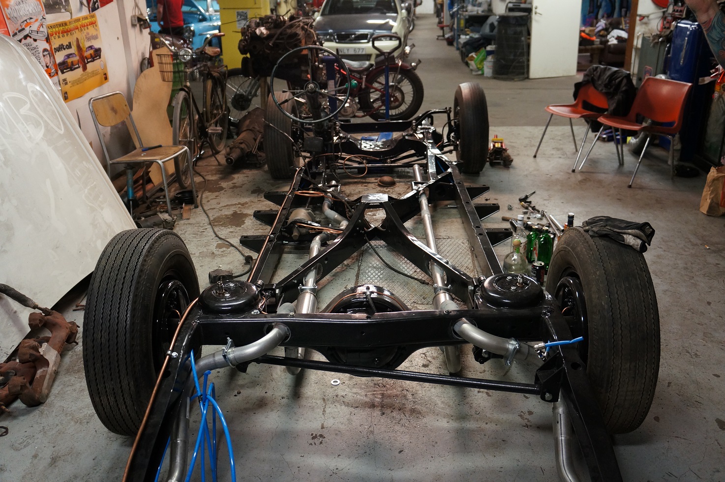

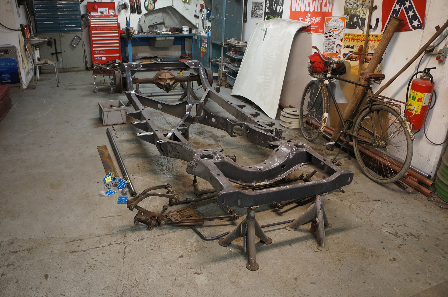

    Now to some of the chassieworks, the frame is boxed and i did a small c-notch in the rear so i can lay frame, its hard to see but i added some reinforcement to the c-notch which isnt in the first picture but you can see it in the picture before paint, the exhaust goes inside the frame to make clearance
    19.jpg 20.JPG 21.JPG 22.JPG 23.JPG 24.JPG 25.JPG 26.JPG 27.JPG 28.JPG 29.JPG 30.JPG 31.JPG 32.JPG

    Bought a pair of dropped spindles from gambino, they were way off so i had to make the upper arms adjustable 33.JPG 34.JPG 35.JPG

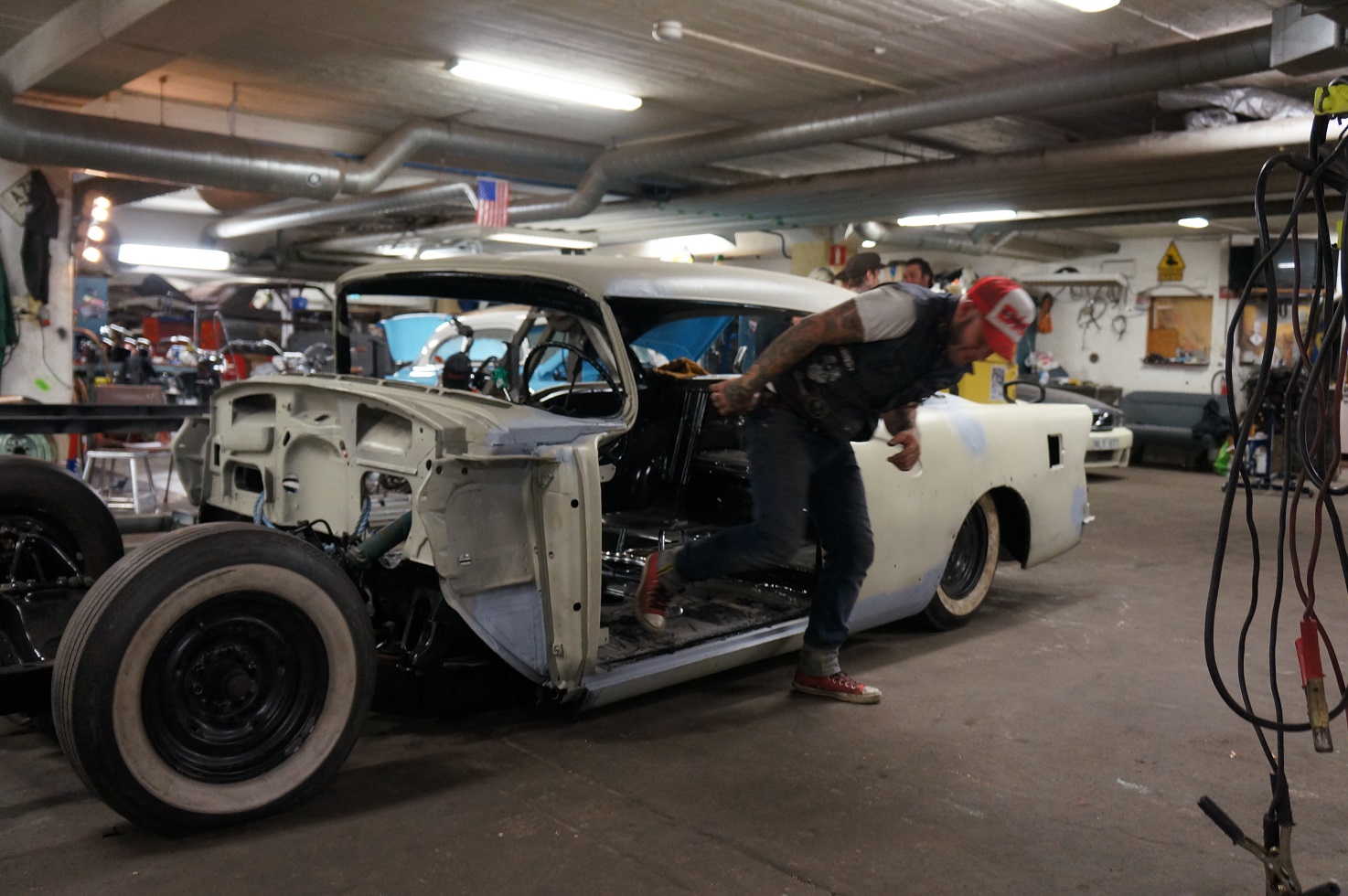

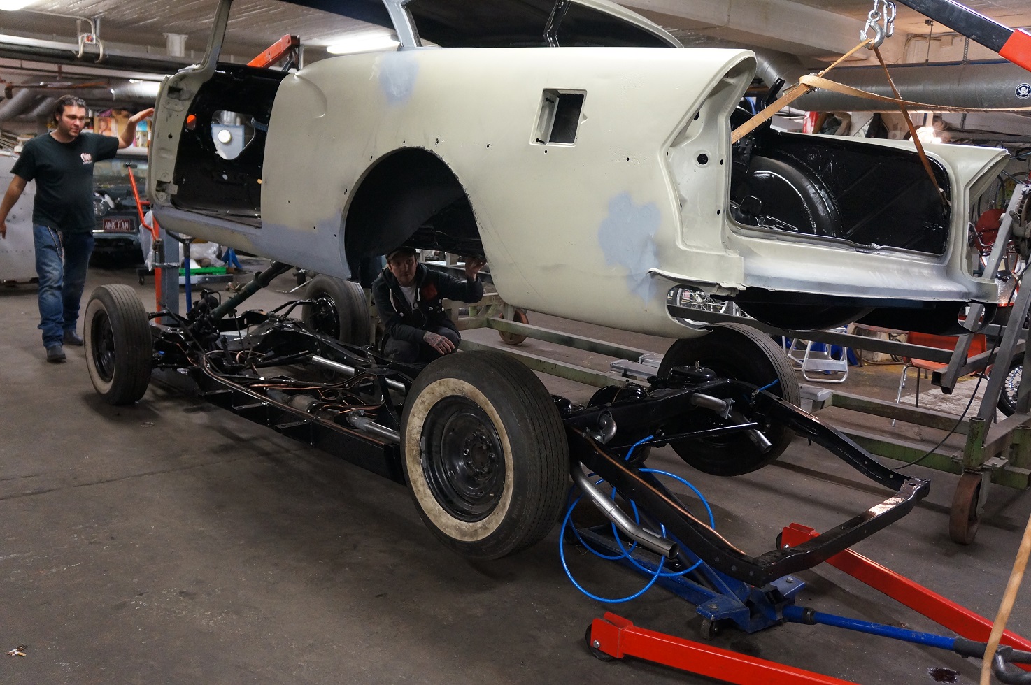

    Now to the marriage, everything went fine besides i have to modify the bottom of the trunk for the exhaust and the floor to make clearance of the drive shaft

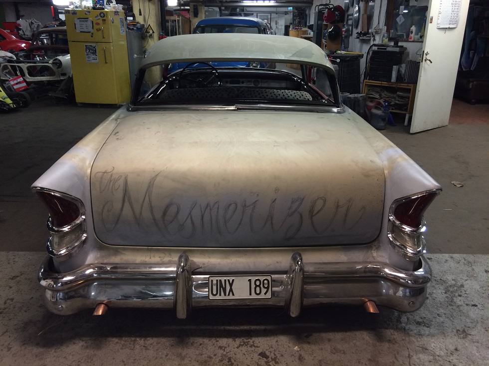

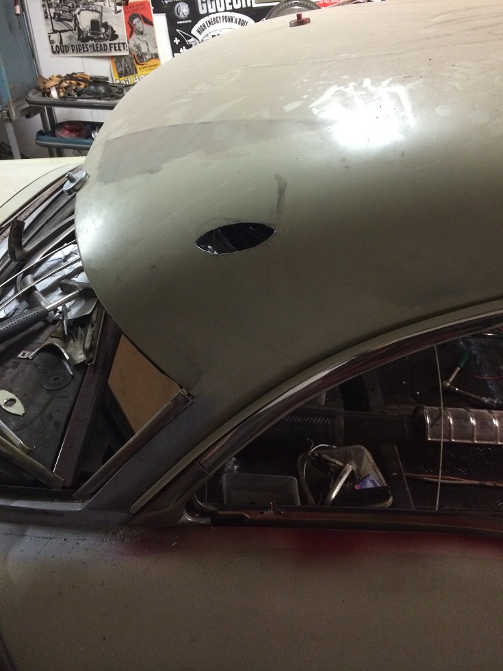

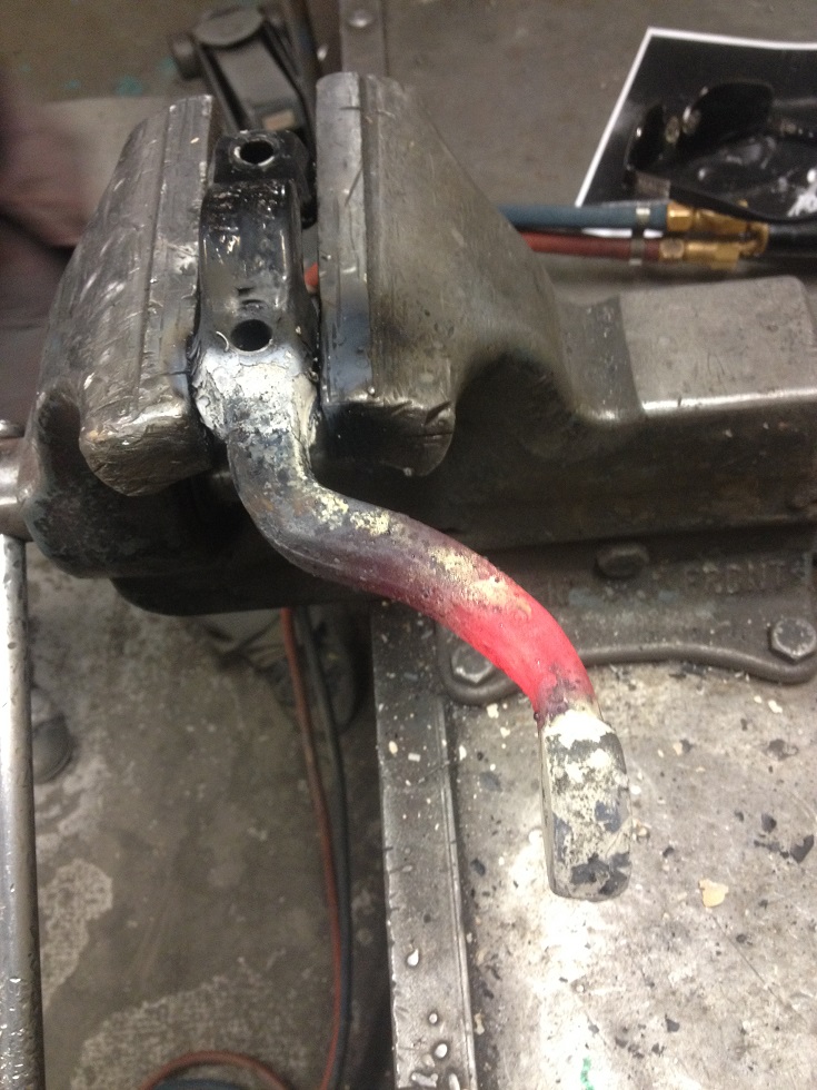

    Removed the doorhandles and cleaned up the trunk, starting to look like a car again:) also did a small surprise for future archeologists behind the fuel lid before i welded it shut :)

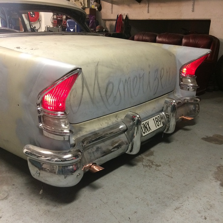

    A kustom gotta have those dual sunken antennas, but in my case i have to settle for dual horizontal ;)
