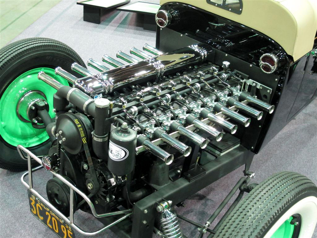

  5. Pietro
    Joined: Mar 31, 2010
    Posts: 22
    Pietro
    from Moscow, Id
  6. csimonds
    Joined: Jul 24, 2009
    Posts: 546
    csimonds
    Thanx Pietro, but I'm looking for exhaust manifold splitting
    Chuck
