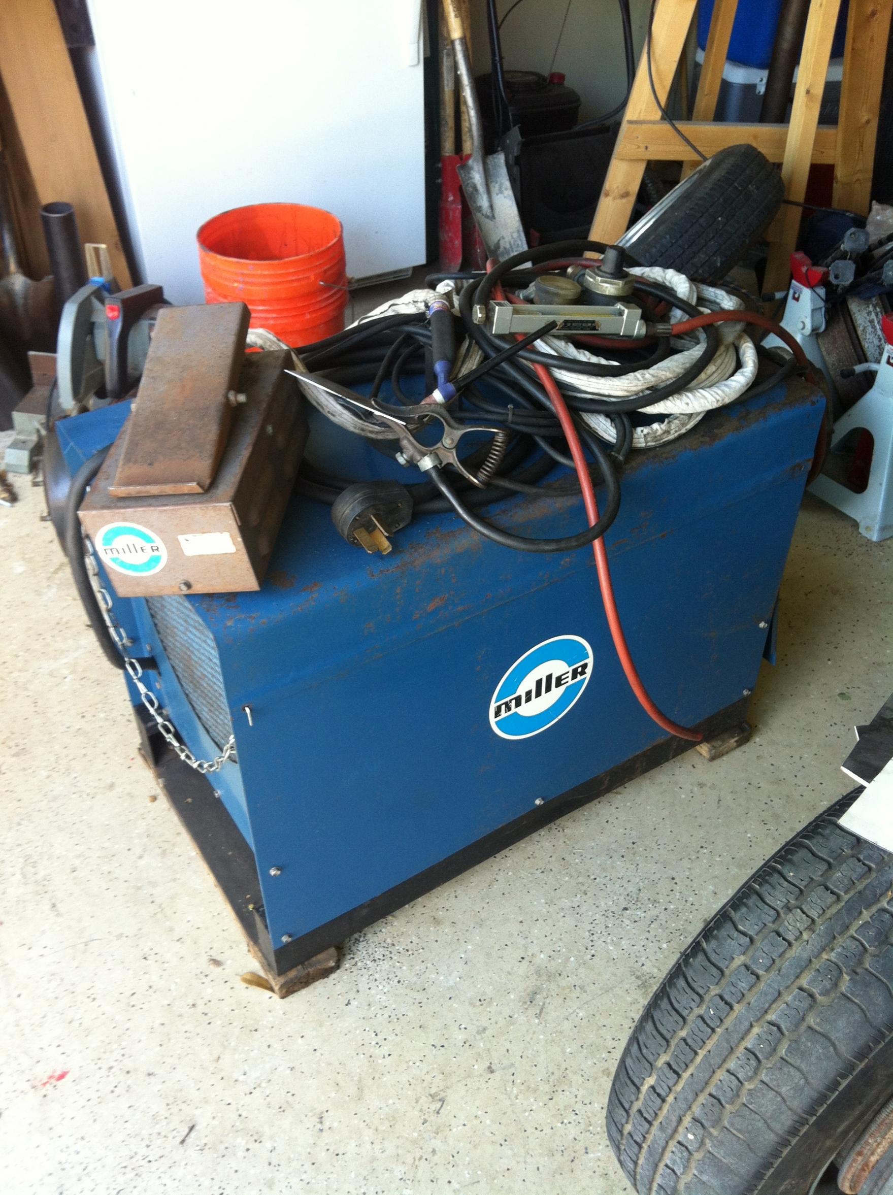

    30 year old miller dialarc with hf... laying beads for $1200 once i bought the welder, argon bottle, water cooler... make sure you get one with foot pedal torch and all dont try and piece it together... here is how mine came for $580
