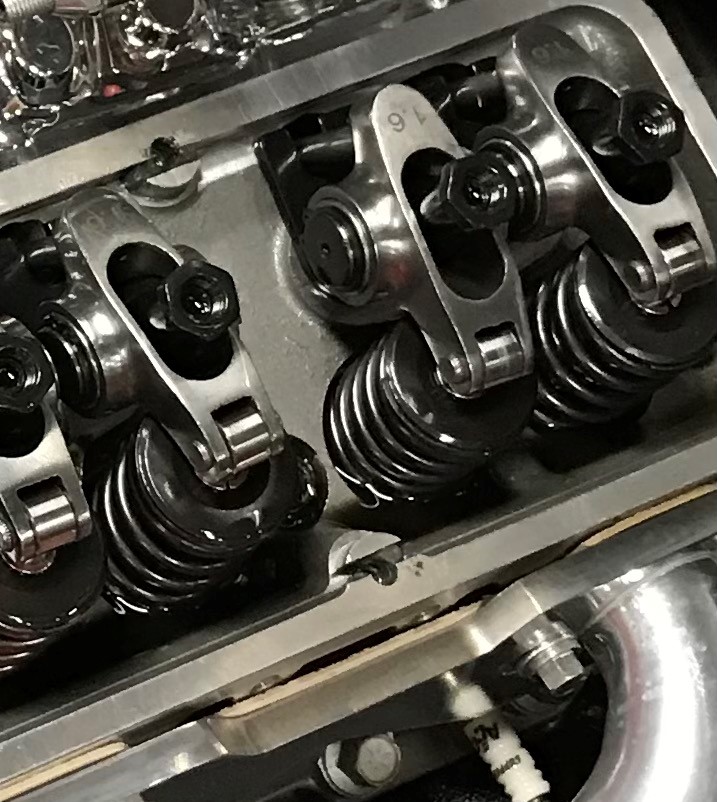

    I had a similar problem when I ditched the Pep Boys valve covers on my coupe and installed the older style Edelbrocks. A significant amount of oil was coming out of the valve cover hold down bolts and getting on the hot headers. Lotta smoke. I bought some good Fel-Pro gaskets and some studs, I put a fillet of silicone around each stud before installing the gaskets and a little more on the valve cover side of the gasket. No more leaks.
    My heads are the Blueprint aluminum heads that came on the 430 hp 383 crate engine that was in the car when I bought it. They have some very strange milled slots running through the hold down bolt boss that I don't understand and they may have contributed to the leaking.

  27. Tutashen
    Joined: Aug 8, 2015
    Posts: 86
    Tutashen
    Nice heads i'm jealous lol , almost looks like somebody cut those slots after they got the heads hey

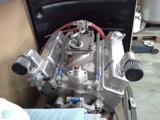

    I'm missing what block's in there... If it's older with the rear breather, this is what stopped mine from leaking, if that helps.
