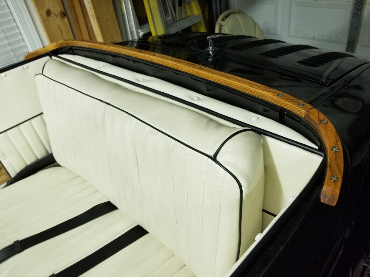

  8. GordonC
    Joined: Mar 6, 2006
    Posts: 3,150
    GordonC
    Thanks! The wife and I whipped it up at home! First time trying it. Good idea to use some tube under there to brace it up. Also give you something to attach a bulkhead to.
