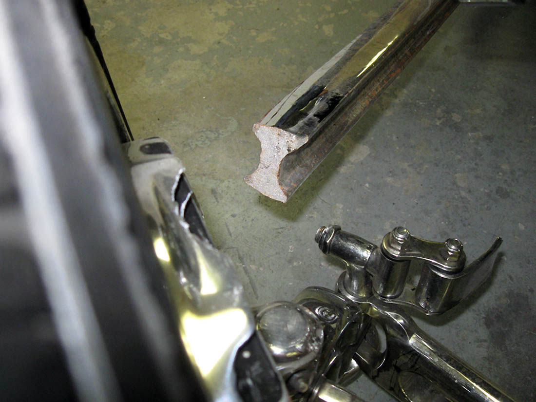

Broken I-beam axle

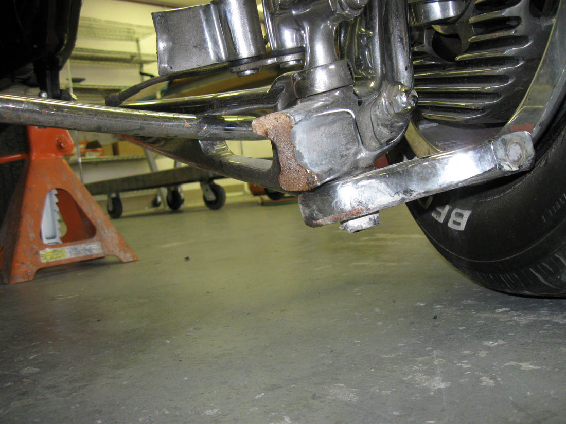

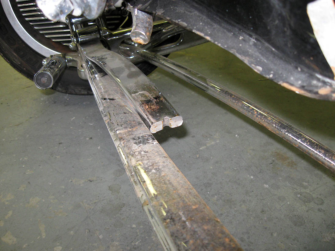

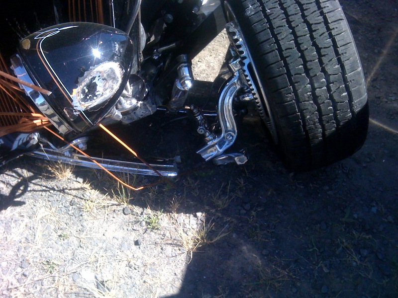

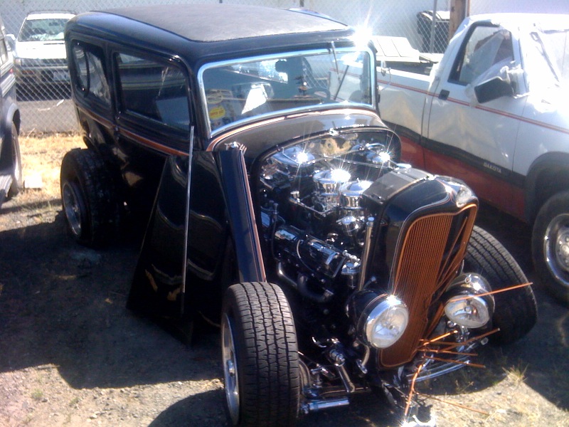

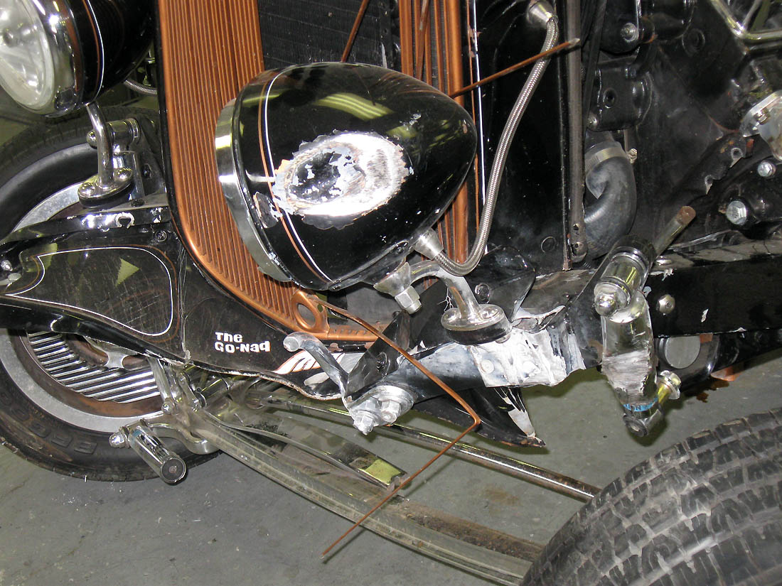

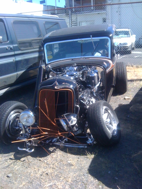

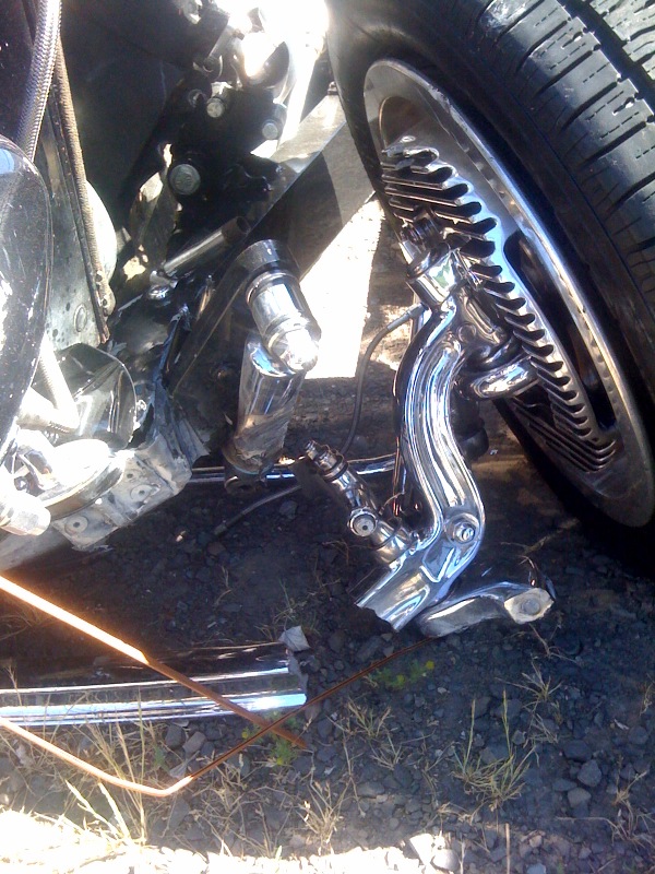

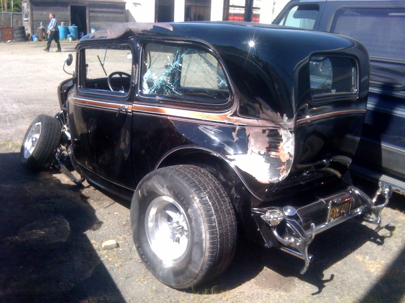

  2. The new MAGNUM cast axle on HAMBer Keith (kb1939) Bush's Deuce Tudor experienced a similar failure ... but at Highway speed! :eek::
    Keith Bush Deuce Tudor wreck 01.jpg Keith Bush Deuce Tudor wreck 02.jpg Keith Bush Deuce Tudor wreck 03.jpg
    Keith Bush Deuce Tudor wreck 04.jpg Keith Bush Deuce Tudor wreck 05.jpg Keith Bush Deuce Tudor wreck 06.JPG
    Keith Bush Deuce Tudor wreck 07.JPG Keith Bush Deuce Tudor wreck 08.JPG Keith Bush Deuce Tudor wreck 09.JPG
    Keith Bush Deuce Tudor wreck 10.JPG Keith Bush Deuce Tudor wreck 11.JPG Keith Bush Deuce Tudor wreck 12.JPG
    click thumbnails to enlarge
    For the complete story, checkout the July 2010 Wreck on I-5 near Woodland, WA. thread ... and yes, the story does have a happy ending ...

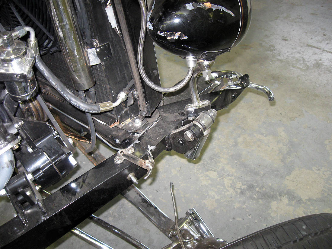

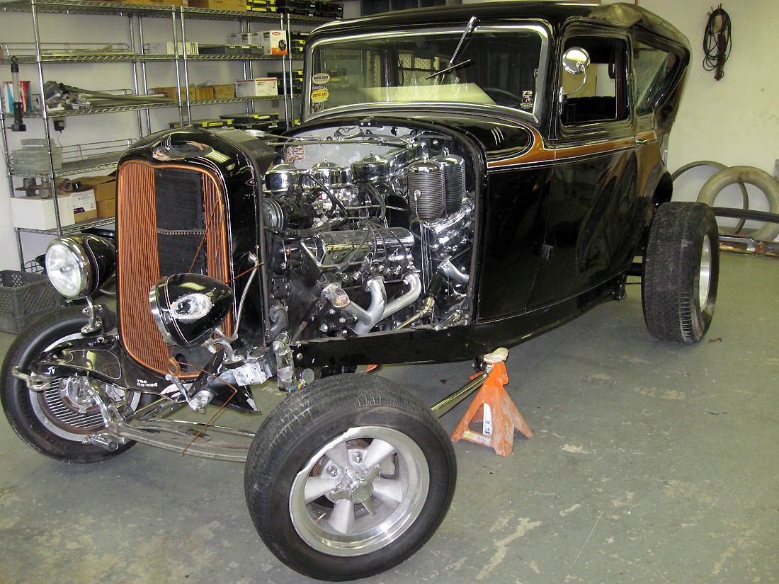

  22. hotrodkiwi
    Joined: Jul 3, 2006
    Posts: 69
    hotrodkiwi
    Here's an update for you all.
    We have had a metallurgical inspection done on the broken axle shown at the start of this thread, to try to find out why it failed.
    The results show that the axle does not exhibit good quality SG Iron (it does not meet the spec AS 1831 ….any grade).
    The metallurgist has found that the axle very likely failed as a result of poor mechanical properties, and states that the sample is inferior to a quality grade grey iron.
    I'll post this basic 2 page report here, see below (PDF).
    Note that there are two pictures include (page 2) showing good micro structure examples of grey iron and SG iron ….for your info.
    There will be more to follow....
    Justin
