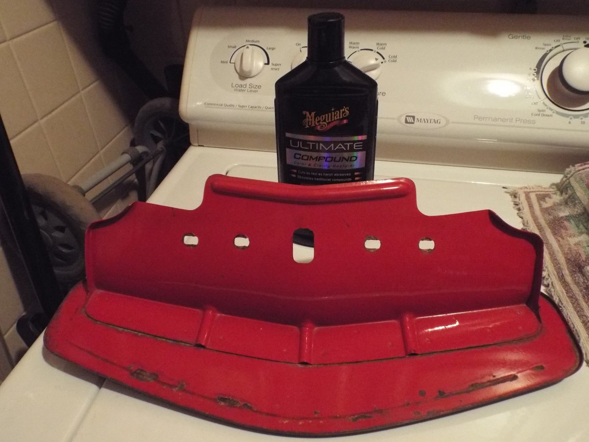

    DSCF7767.JPG DSCF7768.JPG Under side of an 80 year old Ford cowl vent with original factory paint. I've always been a fan of Meguiar's products. Bob
