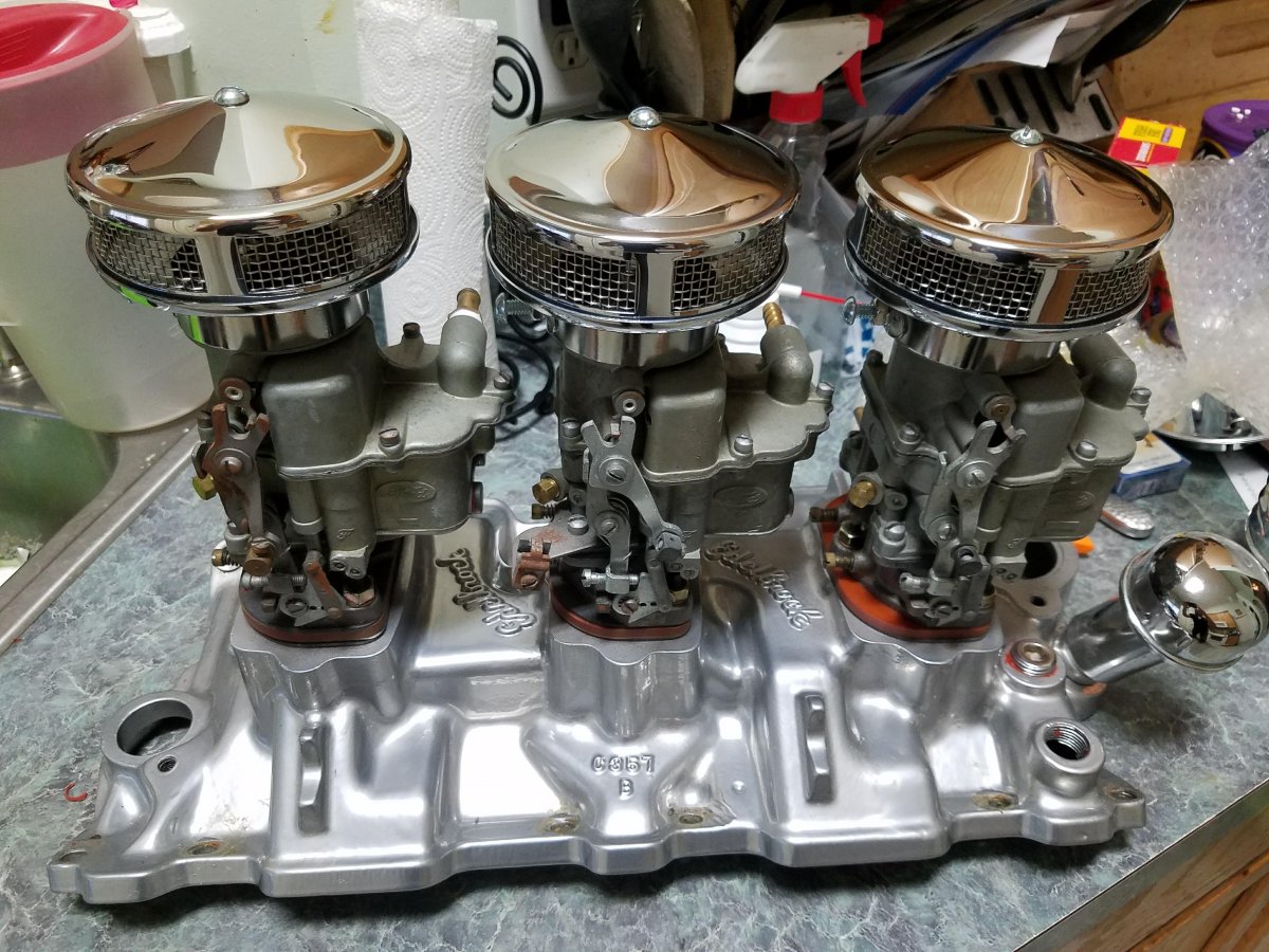

  1. Picked up a few new Air Cleaners from my buddy Chris at Grace and Company. these are so bitchen.

  2. But I might need to get one more and another carb setup since I finally scored a Weiand WC4D. this is my favorite intake for a small chevy. it just looks awesome. I've wanted one for a long. Thanks Justin!!

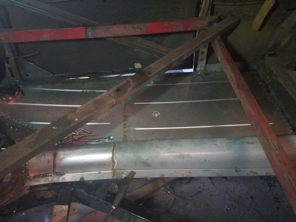

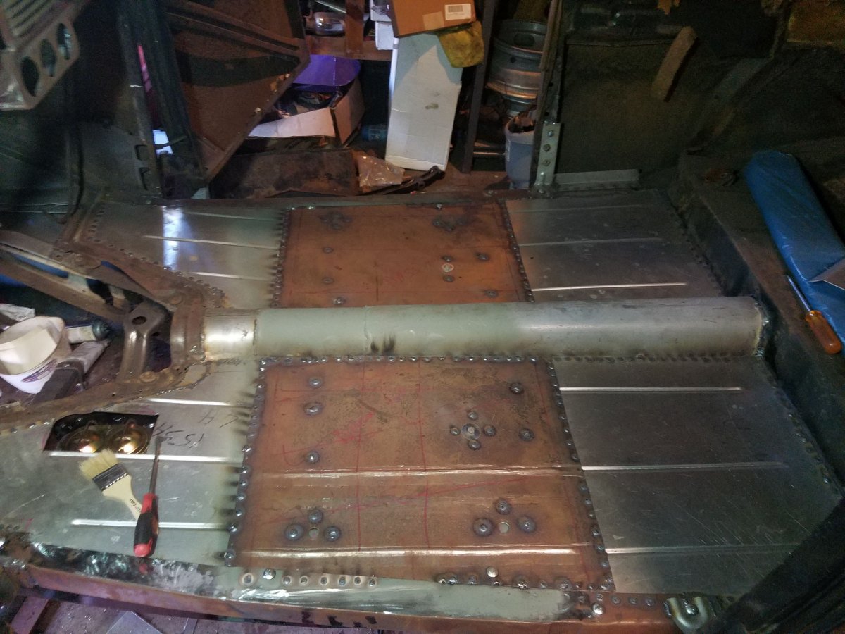

  6. finally got back to wrapping up the floor replacement. Pretty pleased with how it turned out. I replaces the rockers the lower B pillar supports, all the rubber mounting pads, and all of the floors. I wanted to maintain the bolt in trans cover and wood toes boards so I trimmed the floor accordingly and was able to use the original floor lip around the toe board and trans cover.

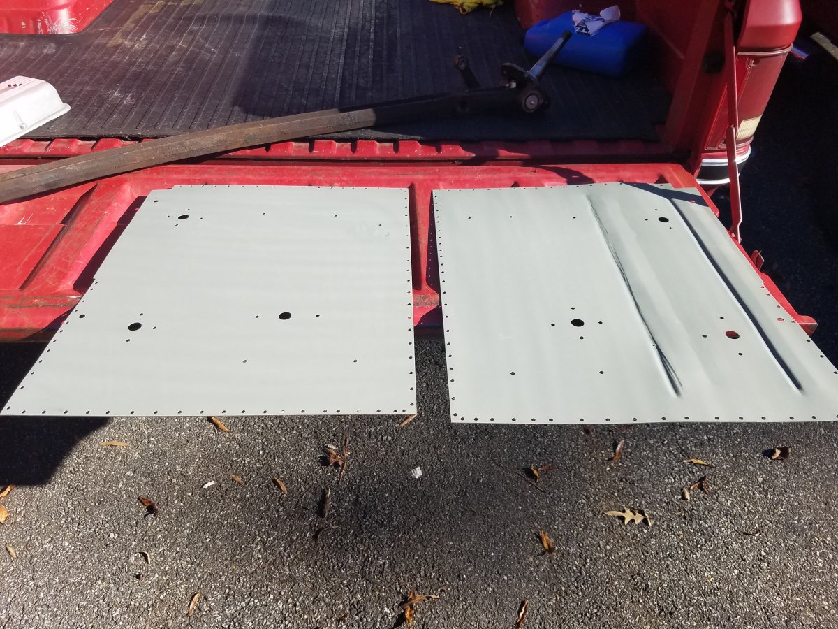

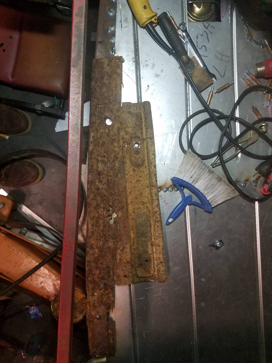

  7. Then I needed to whip up some seat re-enforcement plates to mount the original bench seat back into it. The original seat re-enforcement panels were small and well looked like they needed more to it. they were also on the bottom side of the floor originally. I decided that I would put them on top, since it really just made it easier, and I could use the stamping in the rocker to tuck it into the rocker and tie it all together. plus I wanted to run it all the way to the trans tunnel and double wall the entire area, and I can tie it into several of the body mounting bolts that way. I got the panels made up, but ran out of time to roll some beads into the new seat plates. This should make it way stiffer.

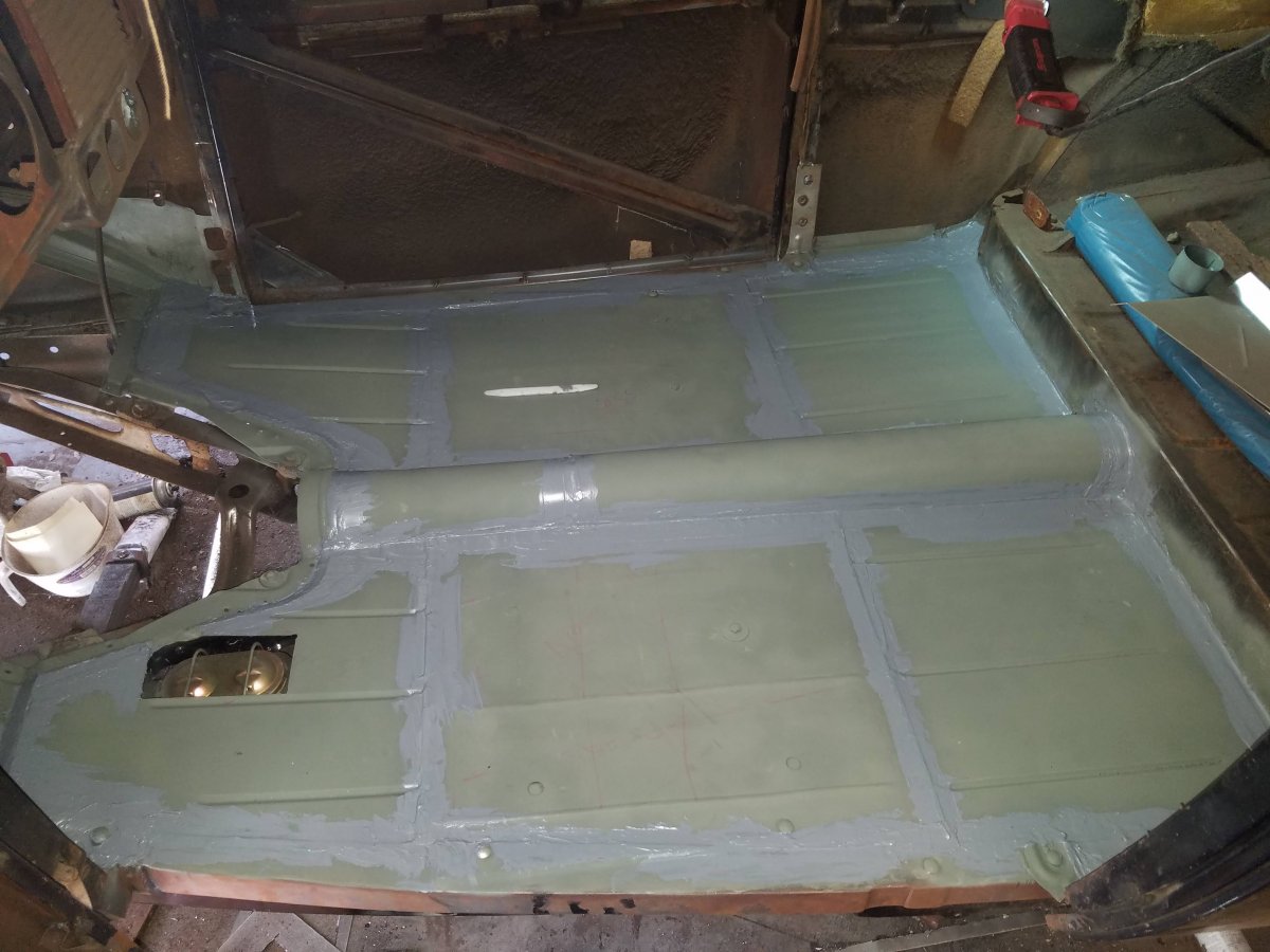

  11. Now that I have the floors all done I finally got them sealed up and a coat of paint on them. May still do the bed liner on the floor still. The seat reinforcement plates, proved to be too much for my bead roller, and just would not roll a bead in it, they are 14 guage.... so I just drilled them up and put them in. Not what I wanted but its way more than what was there stock. But the top side of the floors are all done, seam sealed and painted. plus I finally got to cut all the bracing out of it. Just have to seal up the bottom side and paint the bottom. then I can finally put this thing all back together!

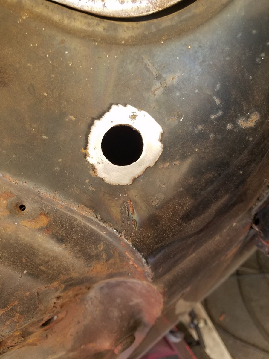

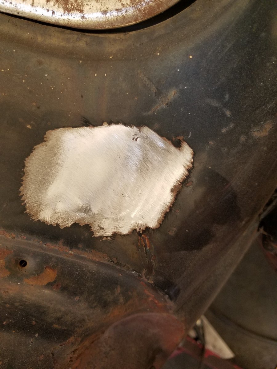

  12. Also while I was at it, there was a hole for an antenna that had bugged me since the day I bought the car. so I made up a plug for it an welded it in. I'll fog some black paint over it before it hits to road, but I was just tired of seeing the hole...

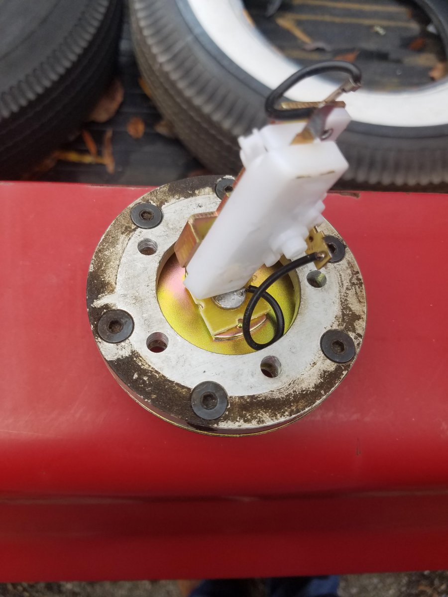

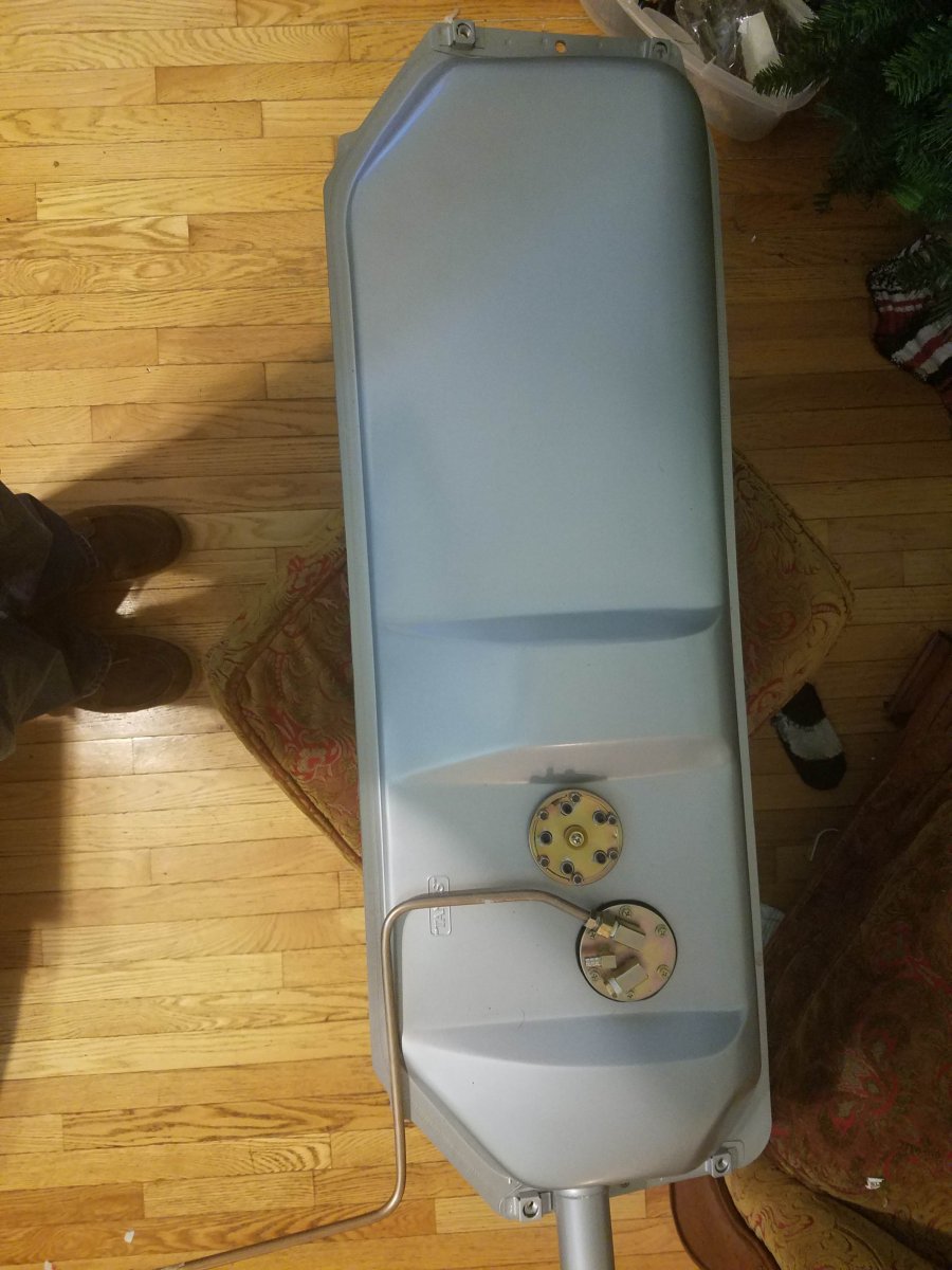

  13. Also go the new fuel tank ready to go back in, I want to use the original fuel gauge but the stock type sender would not fit on the TANKS brand tank, so I took an old adapter I had to put a 5 bolt sender in a stock ford tanks and used it backwards, took some careful clocking and checking but it seems to work Just had to drill a couple holes through the sender and the adapter. One more part ready to go on!

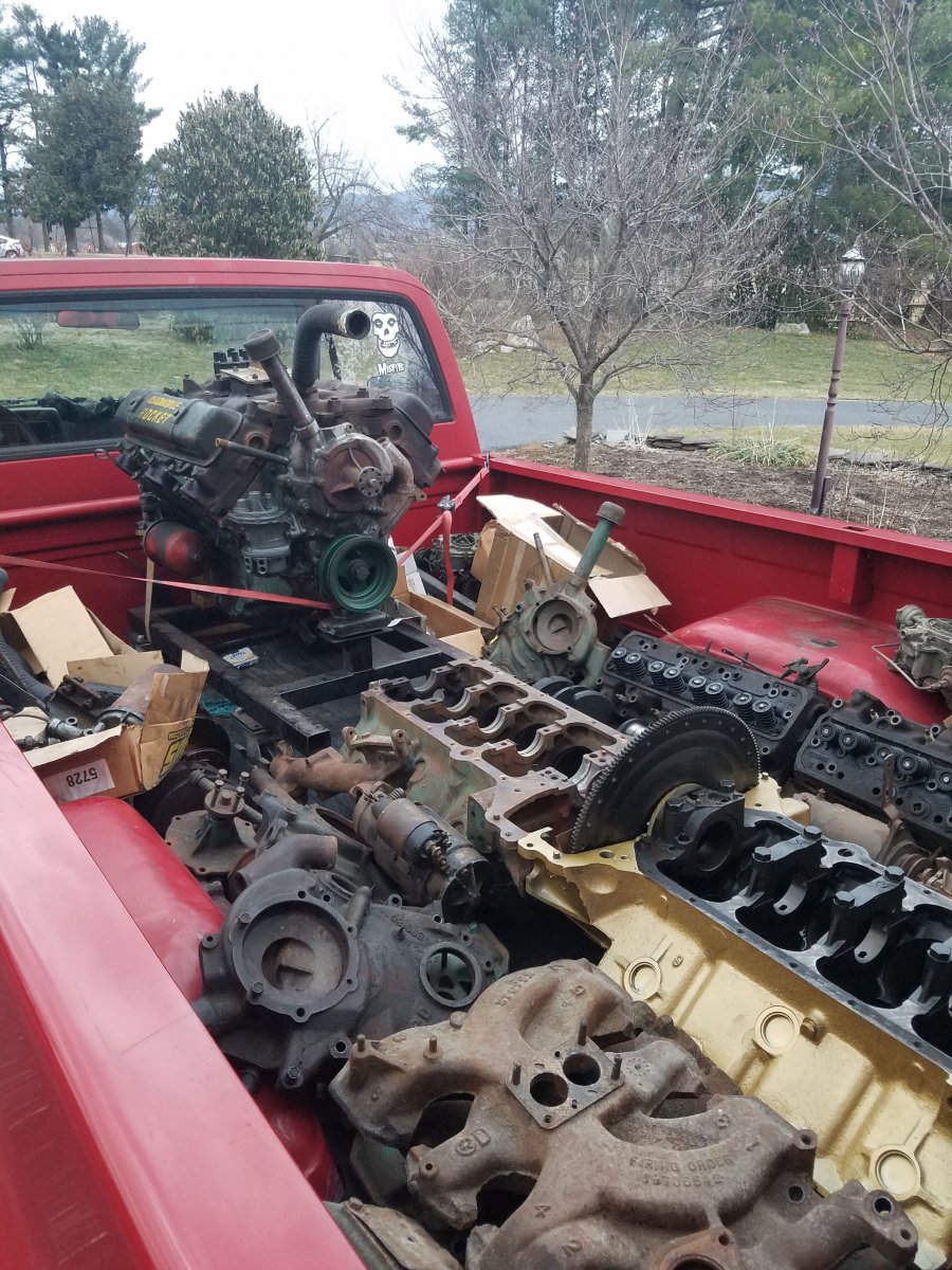

  19. I scored really great collection of Early olds 324's from my friend Martin, he is moving, and after hauling all this home I can see why he doesn't want to take it with him!

  20. The chassis will be built by my good buddy Ben Haag (Hotrodderhaag on the Hamb) and then ill plunk this ready to go 324 Olds with a 4 speed behind it. Picked up the open drive banjo rear and the front brakes From my pal Doug at Walker Smith speed shop here in Richmond, so that figures out the drive train!
