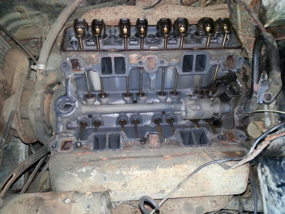

    I pulled the valve covers on the 283 and was blown away at how clean it looked. So I proceeded to pull the intake same deal! It looked almost as clean as a new Gm crate motor. So because of how clean it looks inside I decided to see if I can get it running before I Yank it out and start with the real build. I'll update as I go but I hope to have it fired up buy next week. 20160424_133220.jpg 20160424_133220.jpg 20160508_160959.jpg 20160508_163314.jpg 20160508_163308.jpg

  2. The above pics of the motor are after some clean up running an oil pump primer to get oil up to everything. Here is a pic of the motor right after I pulled the valve cover and intake. 20160503_212223.jpeg

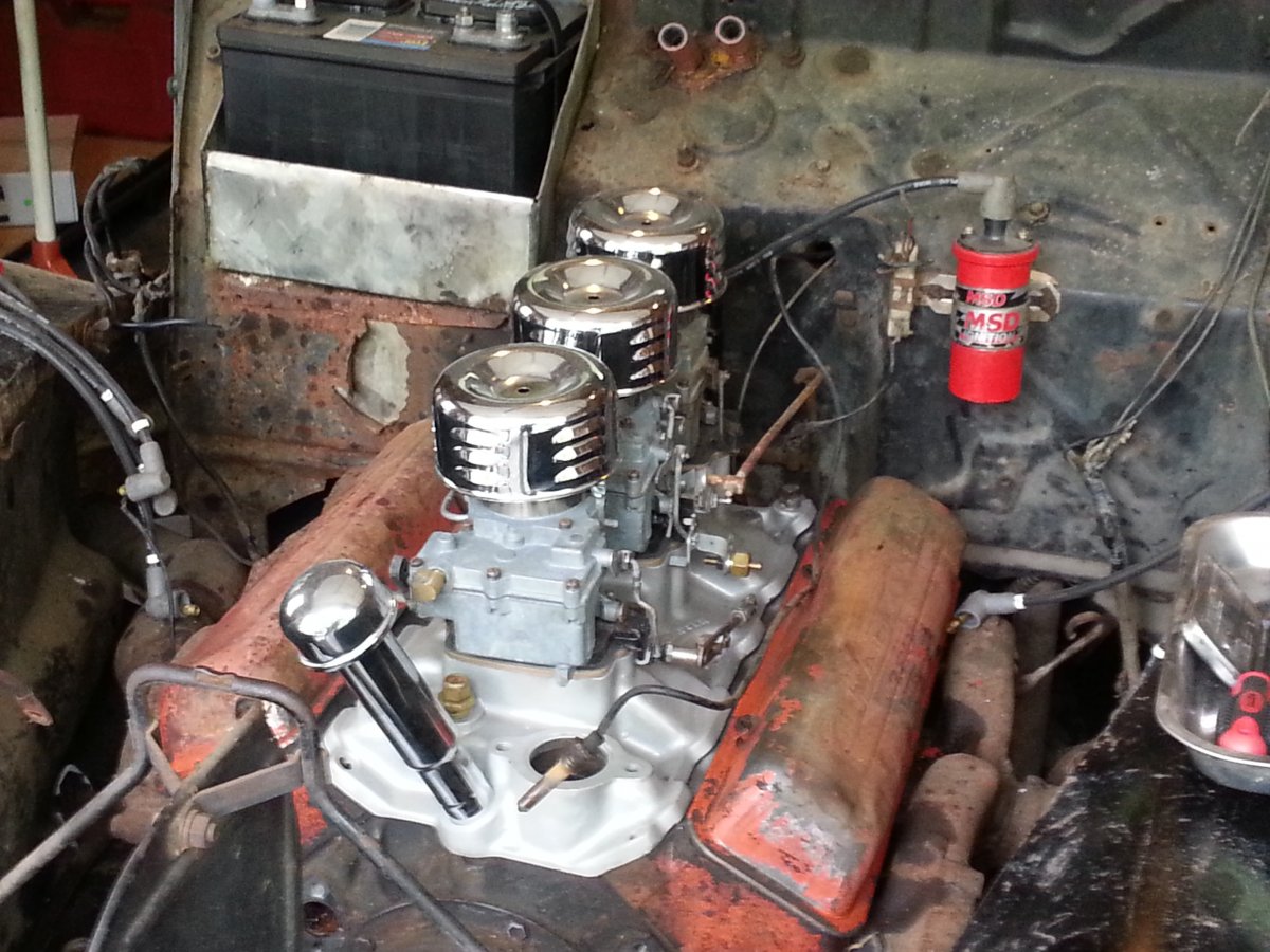

    I think tri power is needed

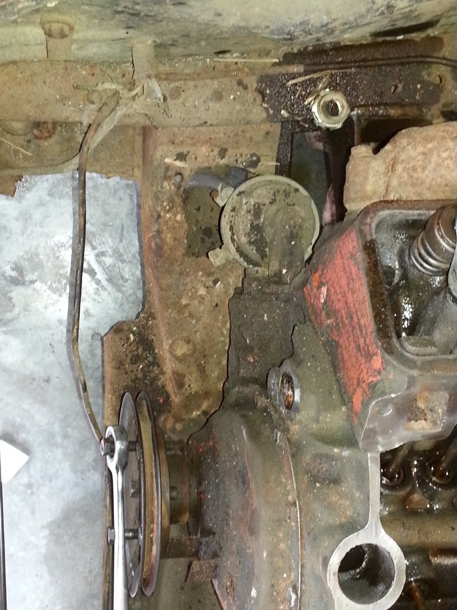

  7. Once I get this thing running I'll be poping the motor out to replace the front crossmember. I already have two nice ones to chose from. This one is butchered up pretty good. 20160508_163327.jpg

  14. The brackets that go from the front side of the front cross member to the frame horns are butchered up real bad on both sides from someone putting some kind of GM radiator in it. The cross members that I have, do not have the same brackets on them for mounting the radiator. Anybody know what years are the same for those brackets? I'm gonna have to swap them out or fab up some to get the radiator to mount properly.

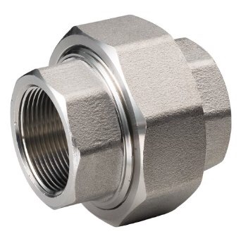

    :D
  21. I was looking at something like that in McMaster Carr. If I do keep it ill use something like that and then tie it into regular pipes bent up under the car then tie it back into the aluminum tail pipes.

  24. I try to not reply to every post, that I would like too. But I got the best laugh from your picture of the pipe couplings. I needed that today. And yes you may need them. Thanks Ron... I was told that they are unions not couplings.lol
