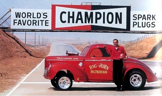

    I know you guys build nice cars, but if you're going to build a replica of Big John's Willys, please do it right. Your Boss Hydro and KS Cars turned out great, but there are some other "tribute" cars out there that are horrible. If you're going to have Bones drive the car, and paint his name on it, then build the new car the way the original was when he actually drove it. Big John's Willys went through many changes, including paint, suspension, stance, tires, wheels, etc... Bones quit driving Big John's car in late 64 or early 65. The car still had long ladder bars, quarter eliptic springs, pie crust slicks, it wasn't crazy jacked up, and sat low in the rear. This pic is towards the end of Bones' time with the car.
    Now look at the car in 66. The car is now driven by Dick Bourgeois, it sits higher, it's running either 10.50 or 11.00-16 Goodyear Blue Streaks, Cragar SS wheels on the front, different lettering, a fiberglass injector scoop, shorter ladder bars, the lower rocker guard is gone, and unseen in this pic, the car now runs a combination of parallel leafs in the rear along with coil springs. So my point is, if you're going to build a tribute car with Bones doing the driving, build like it was when Bones actually drove it.:)

    The outward appearance will be of the 64 car I posted a pic of. The chassis and driveline will be different. Shorter ladder bars and coil overs in the back. Mainly to save time on sorting the car out. This car will run 8.50's in the quarter and 5.50's in the eighth so the same suspension they used in the early 60's might not respond as well to todays tracks, tires and power.
    My agreement with Vic Mazmanian and Bones is to have the car "look" like it did in 64 AND be competitive with the cars that its racing against today. Am I going to please everyone on this build..? no. My goal is to please Vic, Bones and myself with a cool "tribute" to a great racer and to give Bones a shot of repeating his earlier Indy victory.
