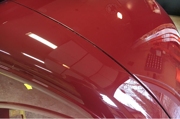

    It aint done yet but I pulled turkey out of the oven for a quick basting. Last nights pics were just in rubbing compound, tonight we are starting to get stupid.
    about face!
    This is "step ladder" deep
    The polish is bringing back the dark maroon. This is sexy!
    Another day and the body should be done. Them on the hood and misc parts. I'm giddy in anticipation.

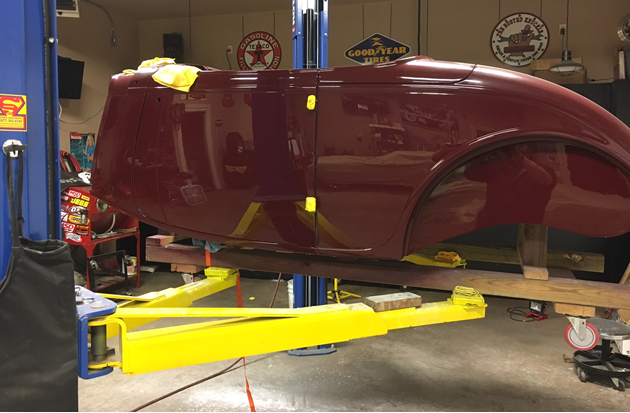

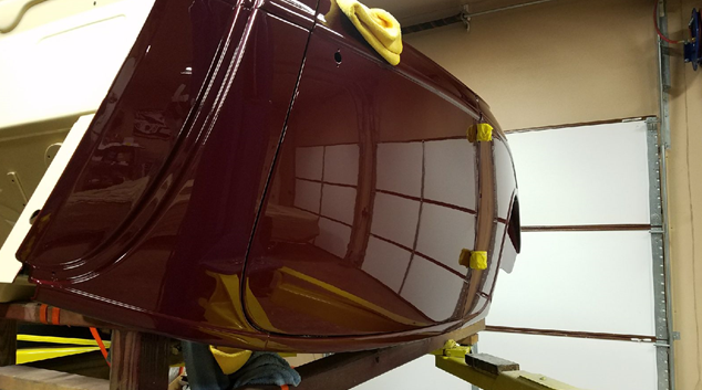

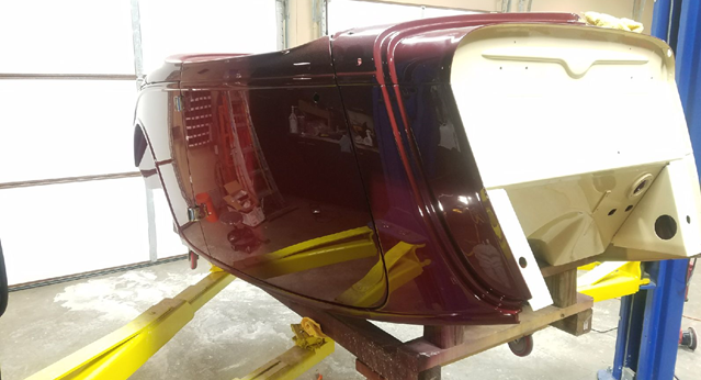

    Day 5 of polishing (he has to leave for work at his regular job at 2:30). Today we are just about ready for finish polishing on the body and hood. I snapped some update photos for you.
    Starting to look like something now. I am dying to put some parts back on it!
    A close up of the cowl. The color is staring to get dark and lustrous.
    This kid good with the buffer or what?
    Here is one with the high speed down force spoiler deployed.

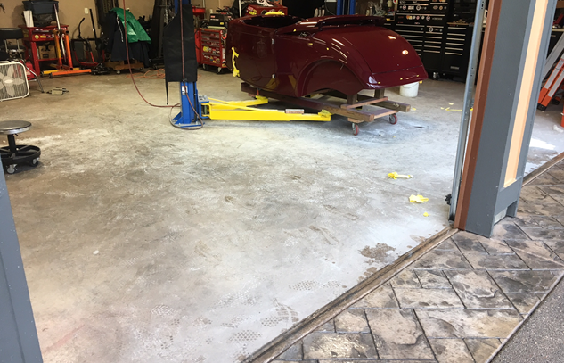

    And finally, my shop floor which was clean when we started. That's a couple of coats of clear lying there.

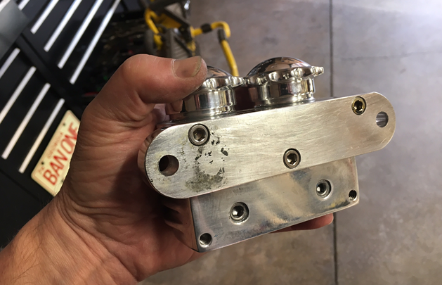

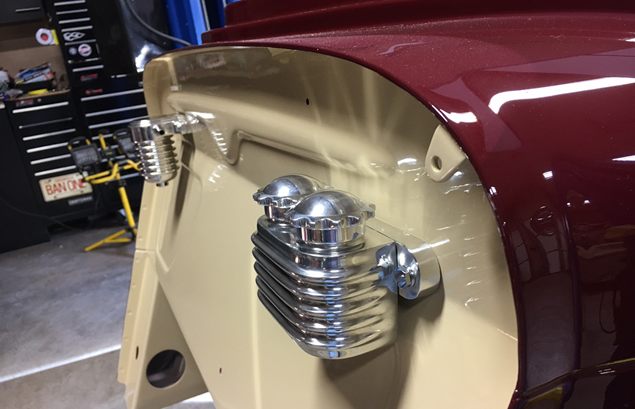

    From the OTC Gear guys I picked up this fuel filter and M/C remote filler. Neither fit my firewall so I had to make spacers.
    They say there are two types of people in the world, Ones with pickup trucks and those who borrow them. I say it is also good to know a guy with a Bridgeport mill and the skill set to use it. Dig this spacer behind the fuel filter, perfection.
    All I had to do was polish it and install it. Of course I also added threads in the firewall to make it cleaner and simple to install.
    And we had to make one for the remote filler on the other side. Note the recessed hardware on the backside.
    The devil is in the details.
    Now there is enough room to unscrew the filter to clean it out without pulling it off the car. We also made it so the unit can be removed/installed from the outside of the firewall rather than trying to mount it through the firewall as designed.

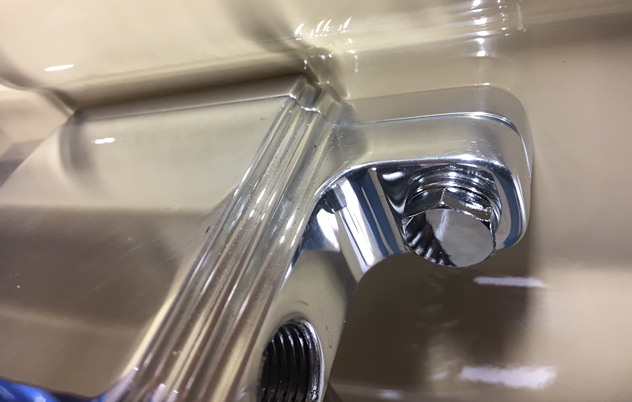

    This worked out really well tonight. I used some JB weld to glue the rear view mirror onto the windshield frame. There wasn't enough room to tap and thread a screw so I just cut the top off a stainless screw and glued it in. I did scuff the frame and the mirror with a die grinder just to give the epoxy a little more to hang onto. Here is the results.
    The mirror is an open car beveled mirror from Drakes
    Just one more piece down. A lot more to go.

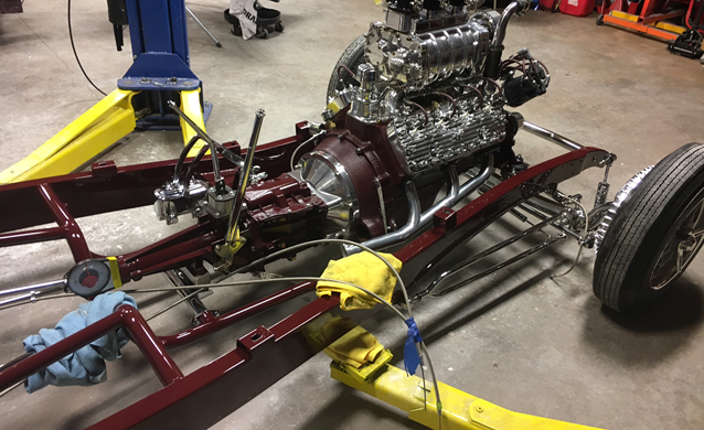

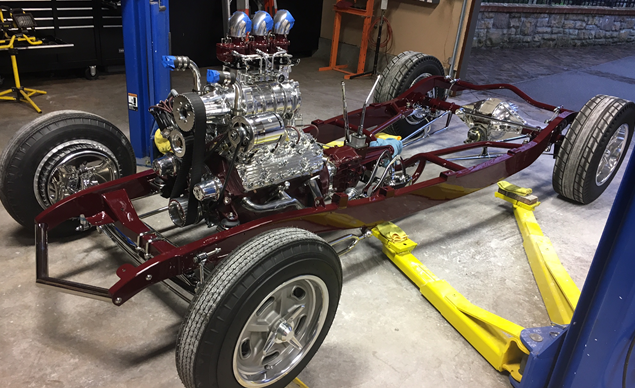

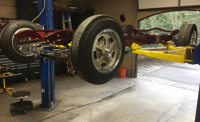

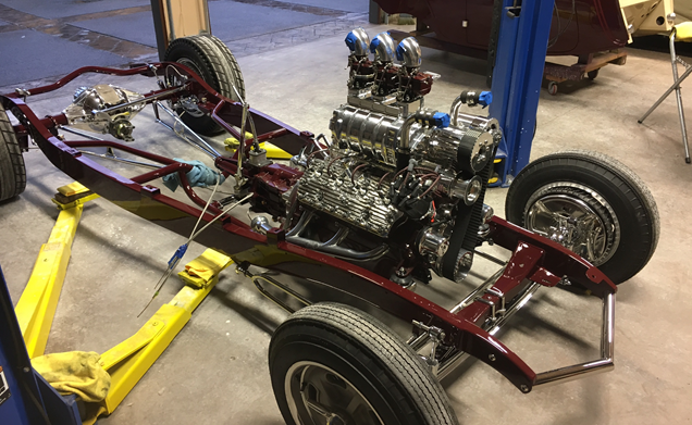

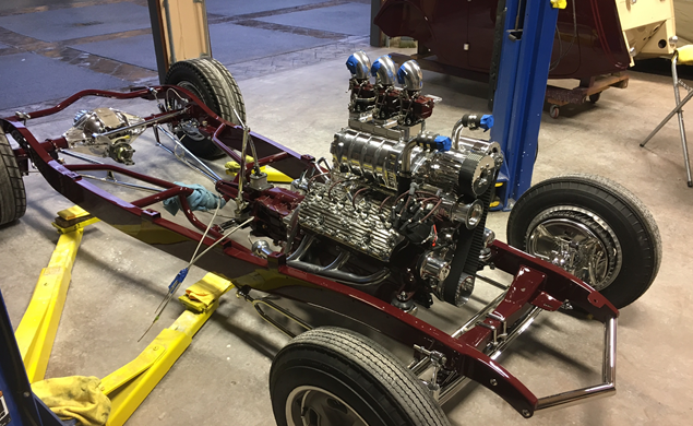

    Here is a another reason to own a two post lift and engineer your car yourself to be easily worked on. The logic of which is undeniable.
    Take part A, in this case an 8BA flathead and 5 speed
    And place in part B, in this case a freshly painted frame,
    Lift part B, roll part A under part B
    Remove front wheels to allow frame to hug the ground and lower part B over part A

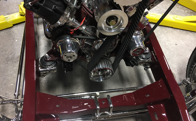

    One of the necessities in this installation are the bolt in motor mounts I created. I kind of over engineered them, but that is better then the reverse.
    6 bolts ( I welded threaded bungs into the frame) and 2 motor mounts later...
    And engine and transmission are mounted...yes I chrome plated the trans mount. A nice shot of Russ Meeks ceramic coated Red's headers. Body waiting patiently on the dolly in the background.
    Motor angle needs one half degree up, so I will add a washer tomorrow under the rear mount. That will match the rear pinion angle. I have a nice drop in the drive line for the u-joints to enjoy. Making them look nice is secondary to making them run nice.
    My shop floor is a mess as witnessed by the tires but we are not finished sanding and polishing all of the parts yet so I didn't want to mop it until we are done.
    Total time involved, 3 hours. Number of people involved, 1. Well 2 if you include Jack Daniels.
    Try that with a 4 post lift. Oh, by the way, I can do this with the body and grille attached to the frame as well.
    I love designing and building cars! Long live hot rodding!

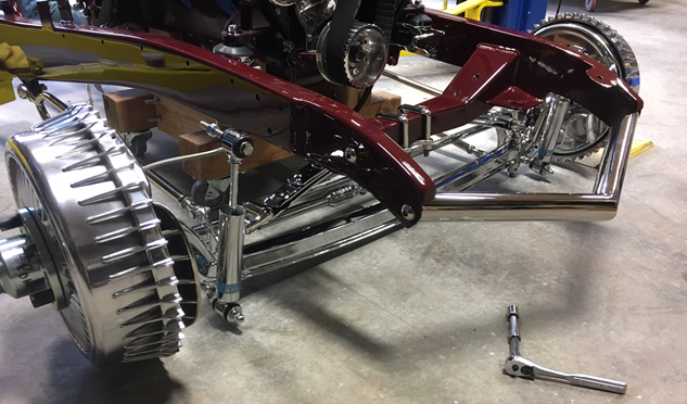

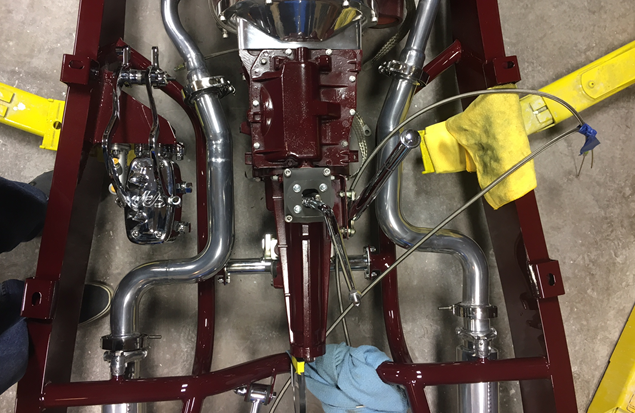

    I had to watch a little football today so I didn't accomplish much in the garage. I did start tucking the exhaust system on the frame. I had cut down a set of flathead push rods to make pipe hangers out of. I had Russ Meeks at Finish Line coating add a ceramic coating to the hangers, pipes and smitty mufflers. I ran the stainless v band clamps across the buffer prior to installation.
    Here are the updated photos. This is the cut down rods, ceramic coated, chrome nyloc nuts, and a rubber insert to help insolate them. I did "re-size" them to make install easier.
    And a shot of the mufflers and header connectors. I'm not done with the tail pipes yet.
    And a close up of the tricky mid section around the M/C.
    Next up, e brake and fuel lines. Stay tuned!
