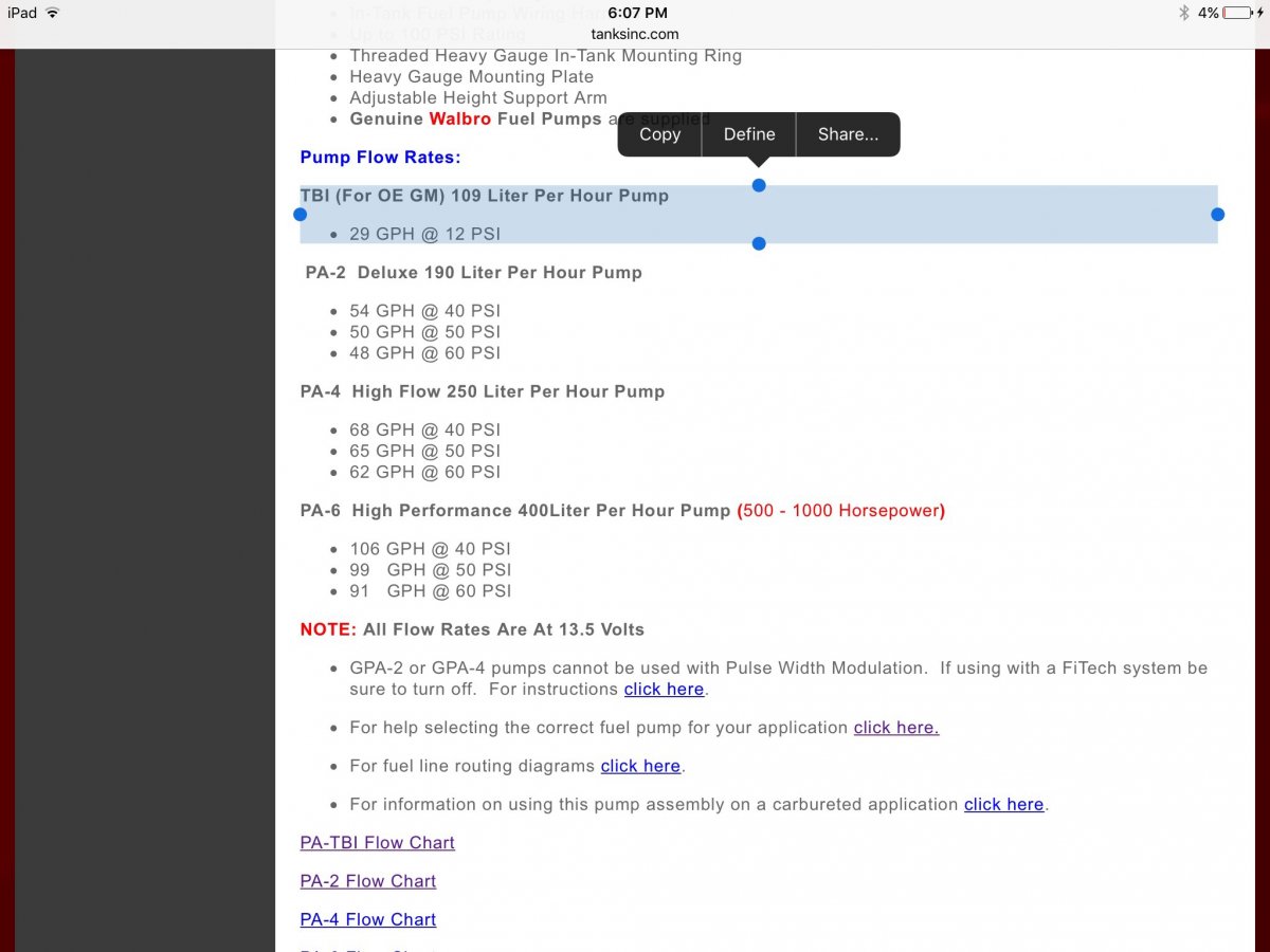

    In an earlier post I said I had installed a Holley regulator #12-842 to knock down the fuel pressure from the in tank 60 psi pump.
    Well that Holley regulator can only drop pressure to 4 psi and I was pushing fuel past my 97's. There is no one regulator it appears that can take 60 psi to 2 psi so I had to re-engineer things a bit and add another regulator.
    The new one is Holley #12-804 and is adjustable from 1 to 4 psi. I added it to the back of the 471 blower using the supplied chrome bracket (bracket was turned upside down and re-drilled to level the regulator with my fuel log inlet.
    I then added two 6 AN adapters to the reg and the fuel log and flared a couple of 37 degree ends on a little chunk of 3/8" stainless I had lying around. Second time I made it, it fir perfectly (first time was 1/2" short somehow).
    Now I need a better fuel pressure gauge since this damn moon gauge doesn't read anything at all. Engine idled a lot nicer and revs better too. A noticeable improvement in air quality as well.
    I had to drain the oil as I was washing a bit of fuel before, oil cam out stinking of gas.
  19. I shouldn't even ask this, really I shouldn't.
    But you know I'm going to any way,,,,
    Why a EFI 60 psi pump?
    Could run a 1980s- 90s Chevy TBI in tank pump at 15 psi and run a big fat return and the forward line pressure would be about 8-6 psi.
    woodz, loudbang, Bandit Billy and 2 others like this.

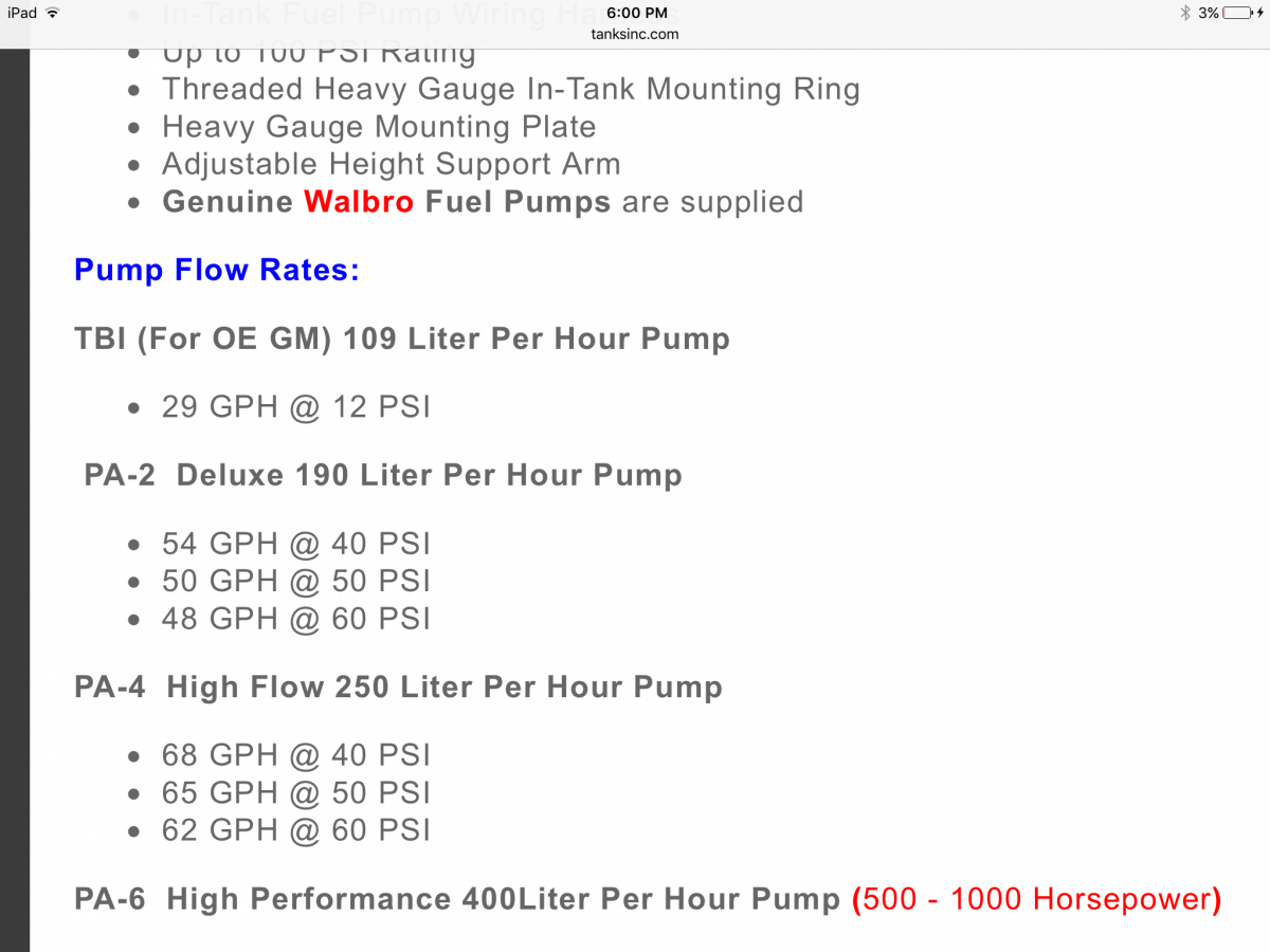

  21. Bandit Billy
    Joined: Sep 16, 2014
    Posts: 5,795
    Bandit Billy
    Simple answer, it is the pump that comes with the tank. When you buy a TanksInc tank they stick these Walbro electric pumps in them. I have installed their tanks/pumps in several cars and they work perfect. The pumps are quiet and due to the return line they keep the fuel cool and moving. This is the first time I have had to knock the psi down past the limits of the 12-842 (which I have also used many times). They say on their adds that the pumps will support 400, 800, even higher HP depending on the model pump selected. I just chose the lowest model which still puts out a lot of pressure.
    • I get the pump I pick from tanks.
    If you need more than 29 Gph ??
    Optimal GPH = (Max. HP x BSFC) / 6
    For BSFC I use .5 for your normal everyday DD engine and naturally aspirated, .55 for something a little hotter, .6 for a little boost and .7 for a lot of boost.
