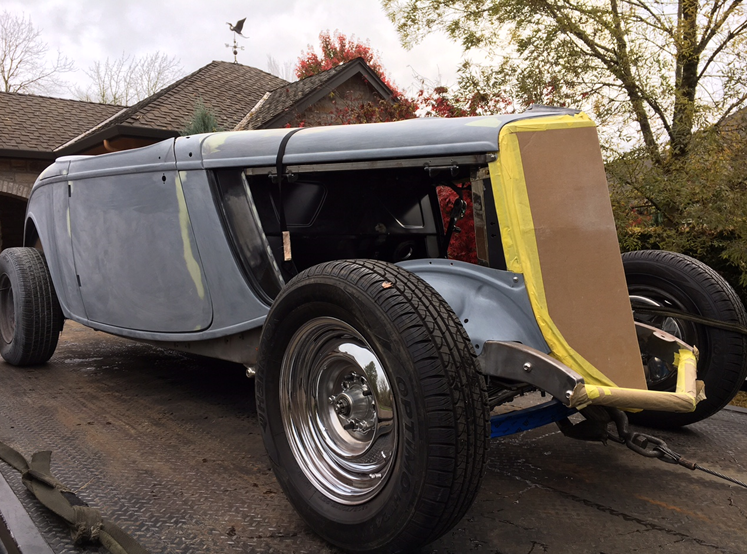

    I just couldn't take it more. Everyday I'm forced to check out FlyinBrian's progress on his '34 roadster while mine sits in the garage taunting me. I finally couldn't listen to the voices in my head any longer so I called the rollback and had her committed.
    I don't have the facility (or the facilities for that matter) to paint B/C so it is off to a buddy's shop and his $25,000 paint booth. I have the body about 99% complete, his team will finish what is left and then we will de-frame and paint. The frame will come back home at that point so I can chalk it up in the rotisserie and finish my welding then we will B/C the frame to match. I'll spend the reminder of winter trying to remember how to put it back together.
    I bought the paint earlier this year ago after Moose did this photo shop job for me and we held an election on the HAMB which went off with very little meddling from the "paint it black" camp.
    Maroon for the body, frame and tank and tan on the firewall and the entire underside of the body. The maroon is 69 ford Royal Maroon and the tan I selected plays nicely with my soft top. I may paint the underside of the hood tan as well, but I'm still deciding. I am going to two tone the '32 style dash in the car, it is easy to change if I hate it but I think it will look cool. My new red Alliance tag will look good on the tan glove box door. Mitch Kim will provide the striping later.
    I'll post progress pics here over the next couple of weeks while we bury the body in color and clear.

  3. I like the color and wheels in the photo shop picture. Are you going to run those wheels or another?

    Sexy car, even in primer.

    Really like the color combo, but I'm an admitted whore for maroons anyways. Gonna look good!

    Yeah, those are the tires and rims I'm using. The only thing I might change is the rear tires. I went with 28" tall cheaters and I may buy the 29" inch tall tires and sell these.
    As am I Slomo. I toyed with painting it black which would have been fantastic, but maroon is such a perfect ford color.
    It will surpass the photo shop, I built some tricky stuff into her. I cant wait to drive it.
    It been nearly 5 years since I started building the flathead, it's easy to lose motivation. The HAMB helps keep me focused and moving. Long live hot rodding.

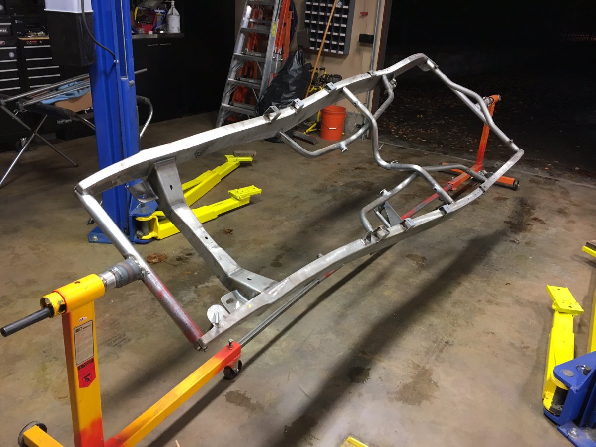

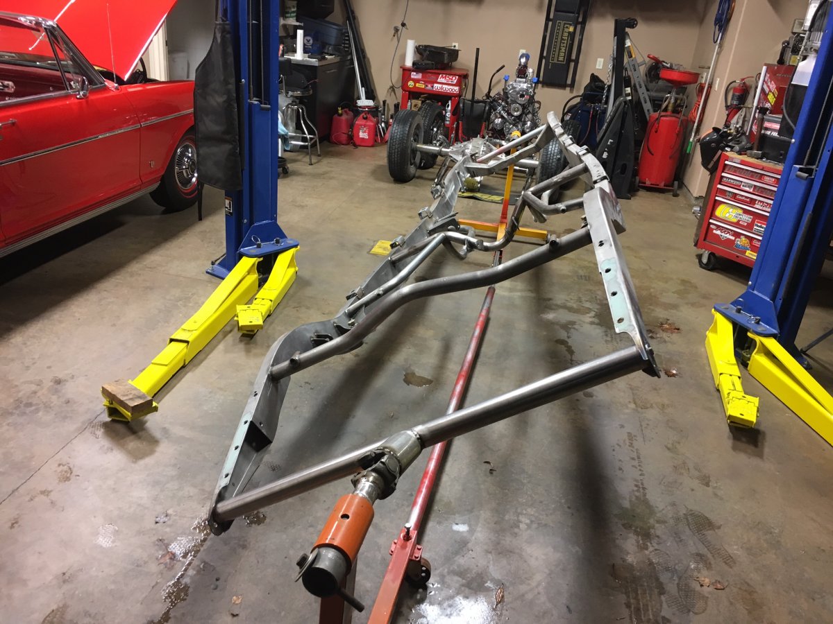

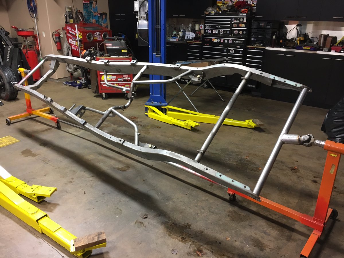

    So the car is at the painter, de-bodied the frame after some final fitment up front. I hauled the frame home, removed the suspension and threw it on the home made rotisserie I built out of a couple old engine stands. It works great., here is the HAMB requisite pics
    I cut the uprights off the stands and welded them back on without the lean back. I added a u-joint from a trans am driveline that I had lying around to one end, it makes it spin effortlessly. It has just enough clearance to make a full rotation without hitting the stands. I love it when a plan come together. Time to clean up the welds and add a few new ones. I had only tacked the brackets on the frame during mock up, now it is time to finish the job correctly.
    The strange brackets on the top rail is due to the fact that my Speed 33 body is heavily channeled but I wanted a more stock appearance.
    The paint shop wants the frame back pronto so I have a busy weekend ahead. The frame will get a B/C maroon paint job to match the body.

    Thanks for the U-joint tip in the rotisserie. Looks like some clear plastic will get rolled out if it is in the "booth" now, wear a good mask. Bob

    It doesn't look like it but there is a weekend full of welding and grinding ahead of me to get that frame ready to paint next week. But the garage is heated and my drink is iced.
