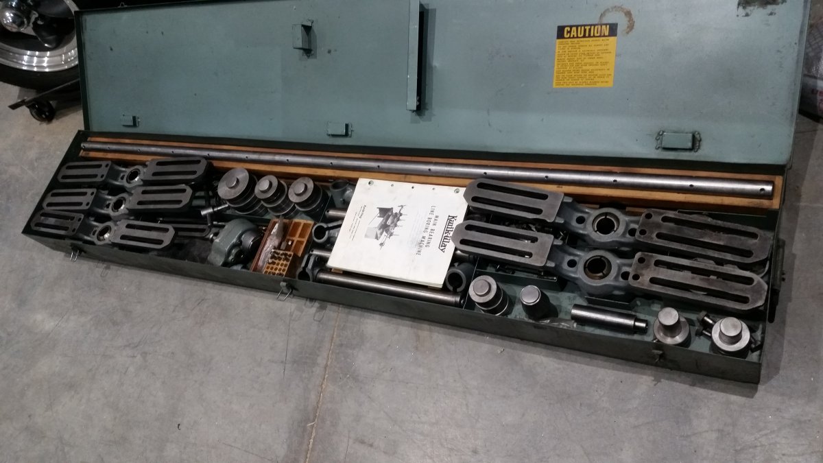

    This morning was an adventure to go buy a Line Bore machine. Stopped by a friend's house in North Omaha and the cops (counted about 6 squad cars) were chasing somebody. I grew up in North O and don't miss it for these reasons lol! Gunshots, squealing tires, sirens, and I sit here hoping this good deal was worth it and to get home in one piece lol. They cuffed the guy as I was driving past a ghost riding minivan coasting down the middle of the street - EPIC. Wonder if he robbed a bank?
    This thing is cherry, got a smoking deal on it. Now I need to learn how to set it up.

    Hard to gauge size but it looks spindly.
    Good thing you made it out alive.

    It is a 1.25" bar that is 70" long. There are bridges to support the bar in various locations. Tried and true system been used since the day of flatheads. The nice thing is it also can do cam bores which I may enlarge on this one.

    And one of these too?
  20. 402BOSSMAN
    Joined: Jul 26, 2015
    Posts: 428
    402BOSSMAN
    Yes sir! I'm tooled up for SBC & BBC and can bore to the .904 Mopar size or the 1" bushing and bring back to any of the sizes with the bushing. I also have a Block Tru with a fixture I made for my mill to deck. The next piece I may get is the Cam Tru which next week may be worthwhile since PRI Show discounts are everywhere.

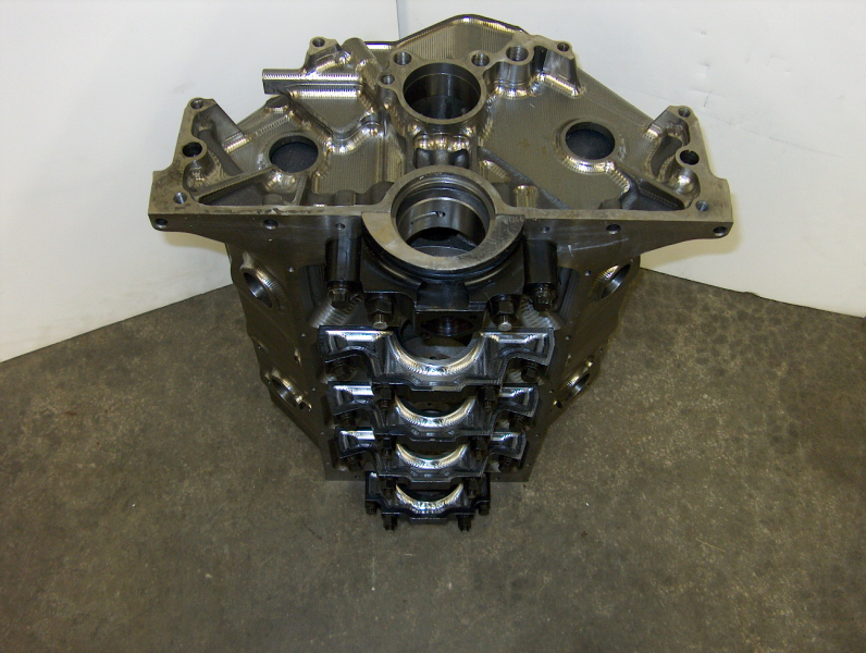

    A few older pictures of my Lifter Tru. I will be correcting the lifter bores in this 283 block.

    Wow...super nice work. I just love Jr Fuelers. Here's a couple of pictures of my block...
