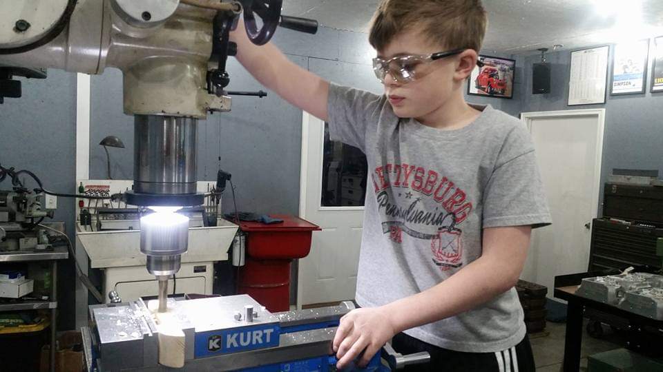

    Teach'em while they're young!!!... How is he on a lathe?????.... :)
