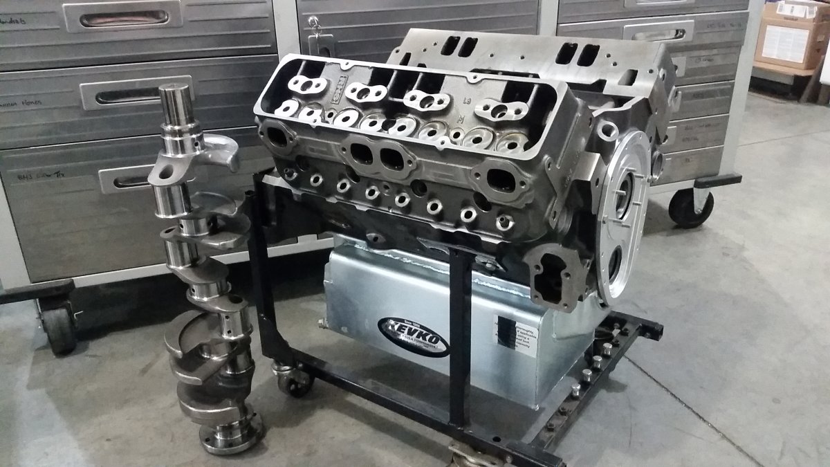

    I have been completely buried with work in my shop, far too much for one guy to handle but I'm managing lol. There are a few updates I can share. Speedway Motors in Lincoln, Nebraska came up to my shop at the end of August to see what I thought about their cylinder head offering. We did some flow testing and I got to share what their competition looks like. Overall, it was a great visit and we all learned some things. They even brought their photographer along to help document on their end. These pictures are some I took showing what their head looks like to an original. They were gracious enough to leave a set behind for me to play with and see what the possibilities are. Thank you to the folks at Speedway Motors!
    On my project I've been really torn on the direction to take it in so I've just set it in the corner for awhile. The competitive nature in me wants to go crazy and snowball this project but then I would be going in a direction far from what I originally intended. So I decided to do another separate build to suit both purposes thanks to finding a block that came up for sale!
    This is a Bowtie Block from GM Performance and is unique. Its a 3.970 bore, 283 Main with Billet Caps, 2 pc Rear Seal, Standard Cam Bore (and location), Standard Lifter Bore Size, and a Short Deck Block meaning 8.800 Deck Height (notice the water pump holes). These are commonly used in Super Stock, Comp Eliminator, and NASCAR (early 2000's). So this block allows me to create a massive snowball for lets say a "Plan B."
    I already have a pile of parts sitting here I've collected over the years so here I'm piecing a few ideas together to get a feel for what I'd like to do. Billet Crankshaft 3.270 stroke, Jesel Belt Drive, Kevko Full Sump Pan w/ Kickout, RHS/Pro Action 14° Cast Iron heads that are common among current Jr Fuel ranks, etc..... Maybe make a slightly larger cubic inch with this one? Time will tell.
    I have come across a few more crankshafts that I snagged so maybe the stroke change that I'm after won't be too bad to do. I'm to the point where I need to finish the block machine work - Deck, Bore, Hone, and Install the Lifter Bushings. Just need a few days to tackle that when time frees up hopefully soon.

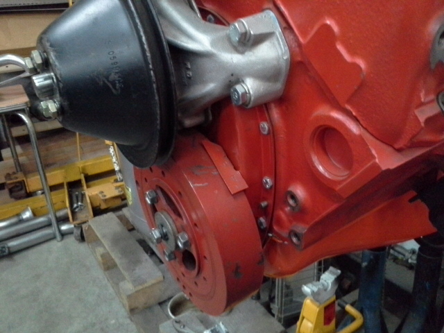

    402BOSSMAN
    The issue is having a small enough diameter so it won't hit the pump. I will likely run a 6-3/8" diameter ATI Balancer on mine.
