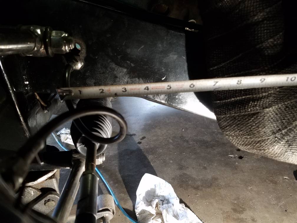

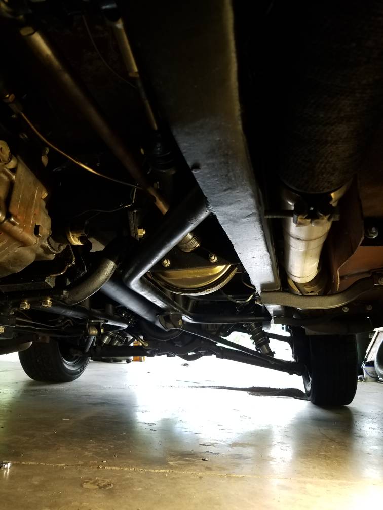

    I thought i had this problem fixed last year bu i guess not. When my truck is sitting in the garage ideling and start to gets warm i notice that the front brakes grab. This is before i touch the pedal it happens. If ya let everythin cool down it spins freely. There is no problem with the rear ones.
    The front is a Heidts 4 piston aluminum caliaper. It has 4 wheel disc with 2 pound residual valves. I have checked and everything was instaled in the right direction.
    The headers are on the outside of the frame and they are wrapped. The frame does get pretty warm where the collector is. The brake line from the frame to the caliper is about 7 inches from header. Master cylinder is from speed way same as booster. I have disconnected the brake pedal just to rule out the adjustment.
    When i crack a line it is instant release of brake pressure, but i believe it is there because of the heat. I have tried beat shields but didnt want to spend to much time until i get more opinions.
    Any help would be great if ya need more pics let me know.
