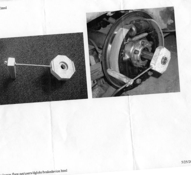

  4. You can make a gauge like this and adjust them with the drum off.... File0130.jpg

  8. AndersF
    Joined: Feb 16, 2013
    Posts: 777
    AndersF
    Yes you gonna need a tool like that.
    First make sure that the adjusters on the middle have the lowest spot against the shoes.
    Use the tool with the drums off to center the shoes in the up and down direction.
    Then put on the drums and use the adjusters to adjust the shoes against the drum.
    The key to get it right is to get the shoes centered. I repeat this couse its that importend.
    This type of brakes dos not have any self centering possibility.

    The shoes match up to the curve of the drum perfect ! What seems to be the problem I'm about total in the middle 1/8" shoes to big that would mean about 1/16" on each side ! The middle of the shoe seems to be where I'm off with the measure shoe gauge that I just bought ! Gona make that tool that was posted above Thanks !
