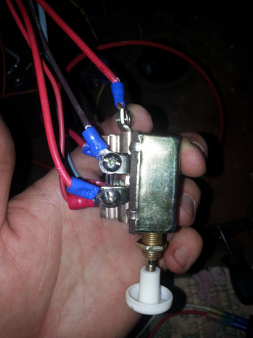

    I have an EZWiring 12 circuit wiring harness...simple and basic right. Well aside from the crappy instructions/diagrams I have the wiring pretty much complete but am having a hell of a time figuring out the rear of the car...

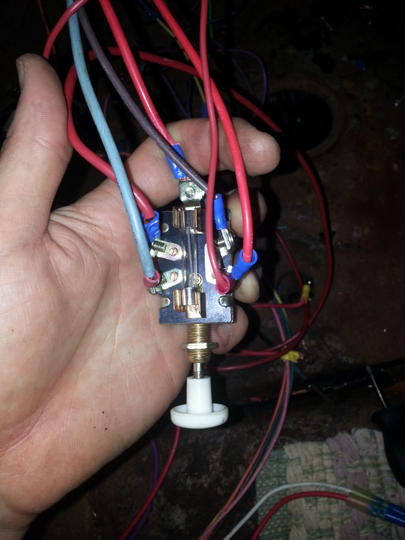

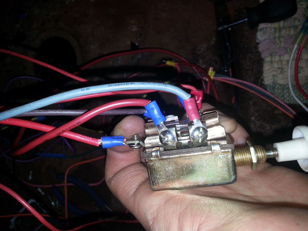

    I have an Oreilly's special...a 2 position light switch to control the lights being on and off..pictures attached...and dual filament bulbs in the back for brake/turn together
    Here is how that is hooked up:
    Headlight power to the back of the switch
    Right Park to its own
    Front park across from it on its own
    Dimmer Power on its own
    Gauges & Dash together
    And then there is the Turn Signal Indicator:
    From the Signal Red to White on the brake switch
    From the Signal Orange to Yellow left rear turn
    From the Signal Brown to Green right rear turn
    From the Fuse box Orange (brake switch power) to brake switch
    Ok...so here is what happens -
    Lights are off, brake switch is "on" so the brake lights are on, the left rear turn signal works but is slow, the right signal goes on just fine...same goes for when the brake lights are off....
    Also when I turn the signal to the left...the front turn light blinks slowly like indicated above...but when it blinks off...it still stays on somewhat dull...the right hand side does not do this....
    I turn the headlights on...no tail lights....
    Just really frustrating...spent a couple of hours trying to figure it out...so any help/direction would be most appreciated.

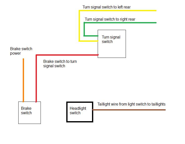

  11. 24riverview
    Joined: Jan 13, 2008
    Posts: 990
    24riverview
    Numbers 1 and 4 are wrong, should be like this if I'm reading your color codes correctly. Also check to be sure you don't have the wires reversed on the left rear.

    Brown tail light wire should be on the headlight switch that feeds the front park lights, has nothing to do with the brakelight switch. You need a feed wire from fuse pnl the + side of the brake switch, then the - side of the BS to the separate stoplight. It seems like the turn signal is separate from the brake light?
  14. adidasink
    Joined: Jan 18, 2008
    Posts: 160
    adidasink
    from Denton, TX
    Finally got it. This forum comes through again. I guess I was slightly retarded
