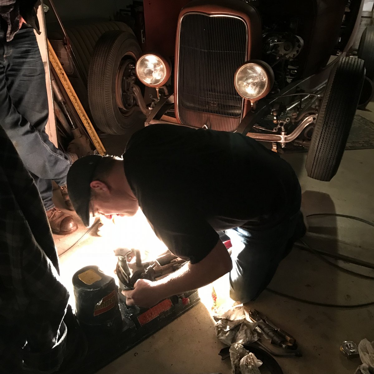

    Shit we got drunk and used one in the driveway Friday night. Hosed down the driveway in the AM when the whiskey stopped working.
