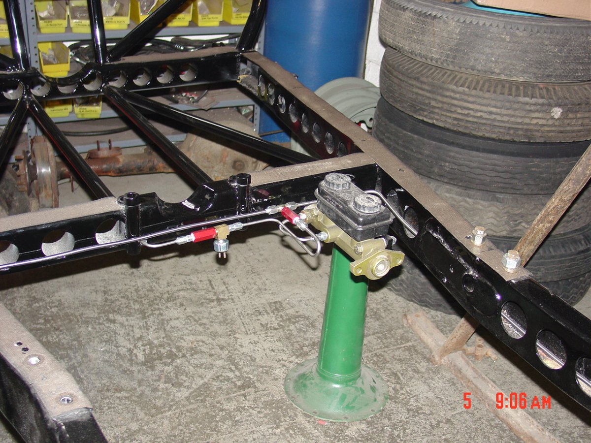

    I had a hell'uva time getting them on my T, this is how it finished up after several tries. DSC01530.JPG
    Avgas, RICH B and KoolKat-57 like this.
  6. krusty40
    Joined: Jan 10, 2006
    Posts: 870
    krusty40
    Nice plumbing job!
