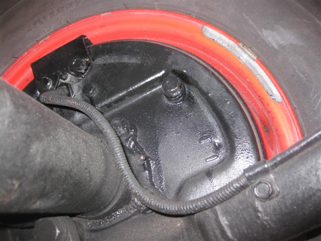

  15. When you run the rear lines.....shift them to the back side (rear) of the axle. A lot of older cars run the lines in front of the axle. Back in the day, tow trucks used to snatch cars from the front, so this was not an issue. Nowadays everyone uses a flatbed with winches and binder straps. First thing a younger tow truck driver is gonna do is throw those hooks around the rear axle and cinch the car down. Many an old car has had stainless (sometimes high dollar) lines flattened this way, which adds considerably to that repair bill. Better for peace of mind to put the lines, where the hooks cant smash em.
