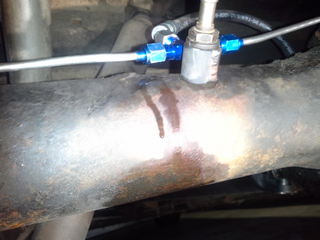

    I had thia work done by a local and "reputable" shop. The rear brake line fittings have been leaking since the work had been finished. He used JB weld to join the brass T fitting to the two adaptors. It still leaked. He then used AN fittings with PTFE. Its still leaking. My question is, should I try and repair the leak with the current parts that he used as pictured? Or should I scrap all that and use new lines and fittings? I already spent a decent amount of money and want to see if it can be fixed easily. Thanks! 20150730_075945.jpg 20150813_192650.jpg
  2. Throw that fancy crap away and start over,,use readily available brake lines from NAPA or any number of auto parts houses.
    You need double flared brake lines.HRP

    follow HRP's advice--get rid of that junk-guy who did it obviously made a mess. JB weld on brake fittings???

    I agree with others, start over. However one thing your might try is to burnish the fitting in by loosening the fittings and then tighten several times there by burnishing the fitting joint.

    My guess is he did the flares wrong. If he over did them the flare ends up very thin or could've cracked. That would be my guess. Shouldn't need anything but regular tube nuts and a union. Might have to just cut the ends he did and re flare the tube. Don't even need new line

    That's an abortion! Rip it all out and do it the old fashioned way- that stuff's probably all stripped and useless. Get the new brake line material that bends easily, brass fittings, and double flare it all. Mr. HRP is right on the money; some things don't need to be "improved". Remember the KISS rule- keep it simple, dummy ( I don't know you, so I won't say "stupid!) I'd also talk to the shop owner about a cheerful refund; major hose job!

    CuNiFer brake line is easily formed, easily flared, and not too expensive. You MUST use double flares on brakes--it's a matter of life and death. Eastwood (and others) has a terrific flaring tool--not cheap but it works every time--that will make your flares to perfection.

    The AN fittings are fine, That's all I ever used on my dragsters. He probably just flared them, not double flared. JB weld on brake lines?!!!! He doesn't need to be working on anything, PERIOD! Get you a roll of the new nickel, copper brake line, it won't rust, very easy to work with, and it double flares real well. You can use regular brake fittings or AN. Napa, KOI, or any of the regular brake line you buy now is crap. I've had it to rust out in less than a year. Plus you have to use couplers or you can't find a correct length line. The line I;m talking about is around $2.00 a ft but you put it on and forget about it. It comes in 25 or 50 ft rolls.
