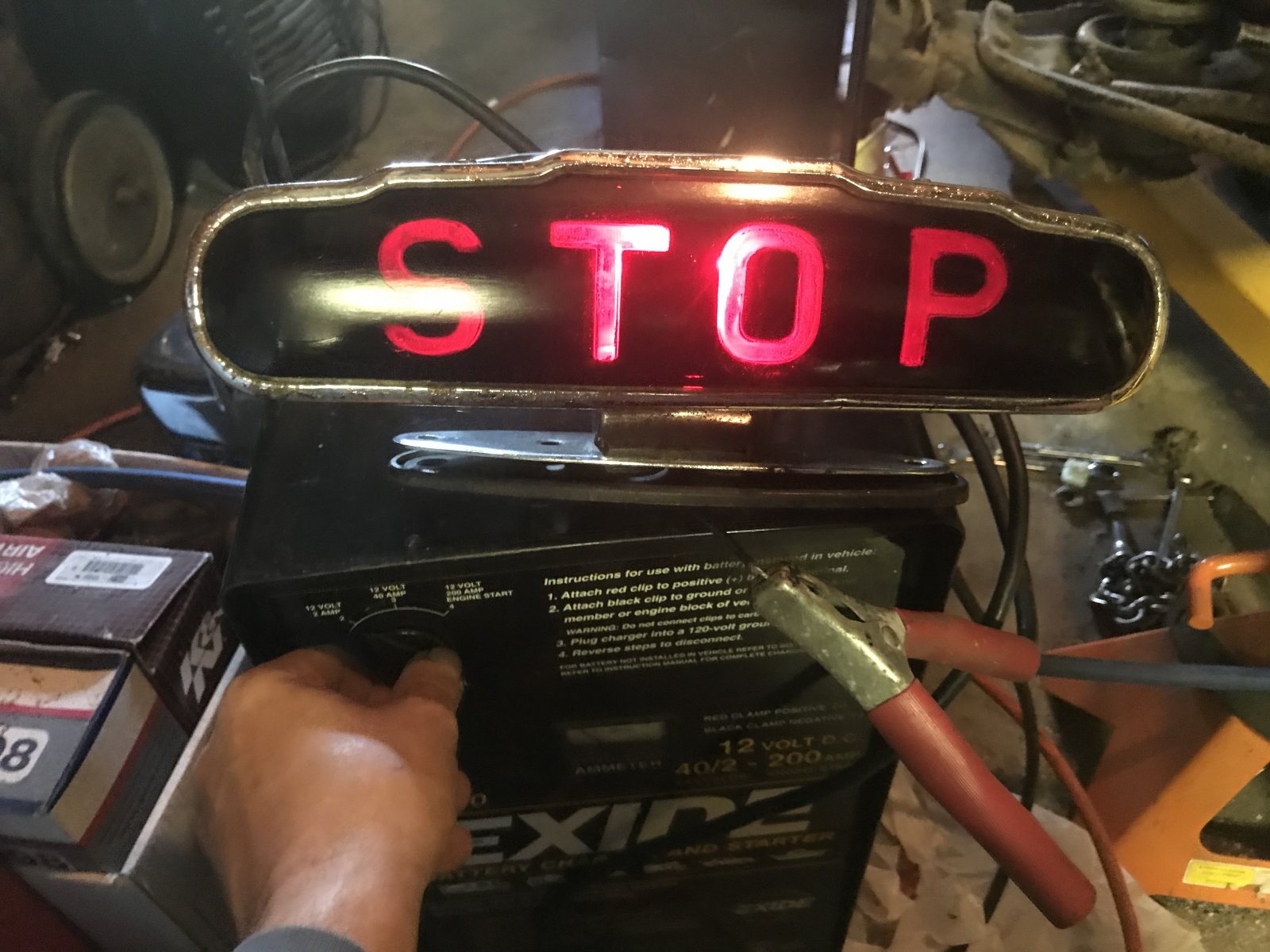

  25. I really like this.... Kind of a late-'50s Corvette look and outside the box.

    One large bright light is better than several small tail lights like most vintage cars have...Get someting about 7 inches in diameter , bright red....The vintage large STOP lights fitted to trucks will do the job..
    Okie Pete, lowrd and HOTRODPRIMER like this.
