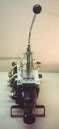

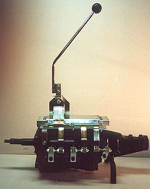

  15. If the shifter location is the only prob, not to worry. I used a T & F Shifters linkage on my Saginaw 4 spd W/OD in my 390 Cad powered Deuce Roadster. Works great, as good as any Hurst Comp Plus linkage I have ever used. Here are a couple of pics, shows how it is located on top of the trans and comes out about a half inch back from where a stock 39 and earlier shift tower comes thru.
    They are about $420 shipped. They are located in Lebanon Oregon. Give them a call, they have them for about all 4 spds. 541 451 1929.
    Here are a couple of pics.
