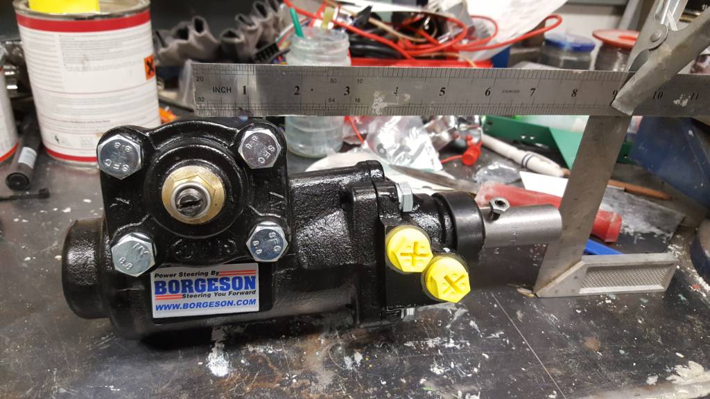

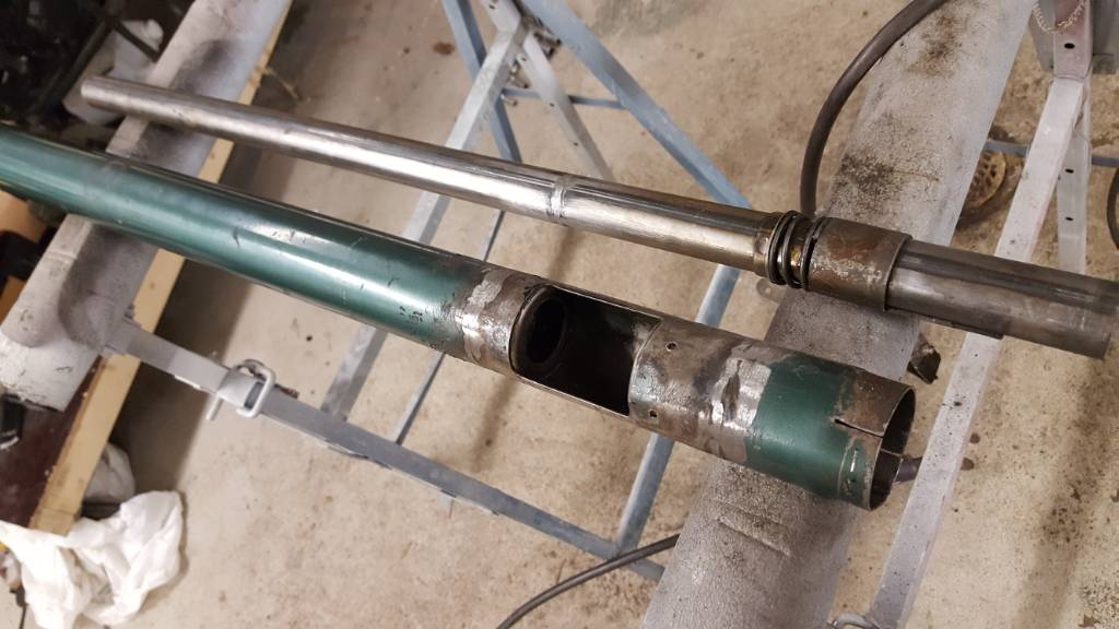

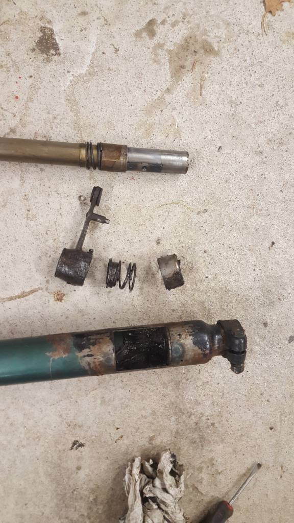

    Anyone that have installed borgesson ps in merc/ford 52-54??

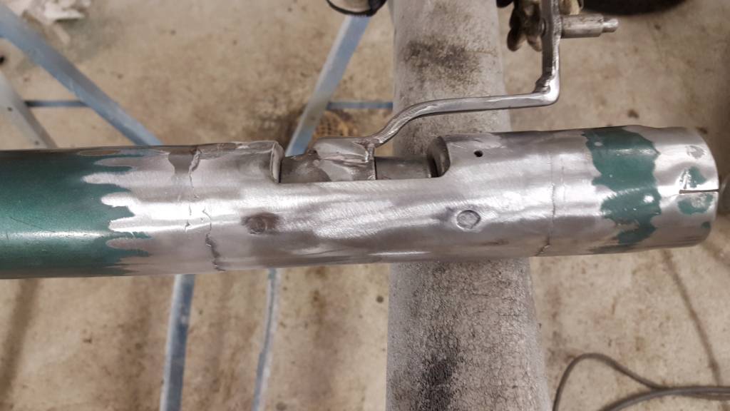

    I want to keep my shifter on column but the first eyeballing when opening the box shows that the new steering calls for shortening the column too much.
    Hope i will be able to move up the gear selector arm up but maybe someone already solved this?[​IMG][​IMG]

    I've never done one but my eye's tell me only 5" back? It also appears that the steering column tube is meant to fit over the new steering box?
  3. I had a similar issue in my 51. I wanted the stock column, wheel and shifter so had to do just a bit of Fab work, no big deal. I shortened the column and mounted it inside above the toe board and to the toe board. Then used a piece of 3/8" X 3/4" channel to drop the shifter rod eye back out and to the stock location. Then made an access cover over the modification. Just something ya do when you can't Visa Card a problem. Think outside the Box and don't let it be a problem. Your issue is real common and I haven't yet seen it addressed in the 1-800 world. Here's 2 photos. Look close just along side the dip stick loop, that's the modified arm coming through the Toe Board.
    51 Vicky 007.jpg This is what it looks like from the inside at the floor. The inside half of the column is actually a removable cover to access the arm. It took a little Voo-Doo to make the 2 speed shift Crown show the right gear when the rod is connected to a 700-R-4.
    51 Vicky 001.jpg It may not look 100 percent correct but I still think it looks much better than an Idiot S.S. Tilt unit. Good luck with your Quest.

    Thanks wizzard! I need to start tear it down to see what can be done, but looks like it ends up partly in the coupe. Maybe an z extension on the shiftarm is needed. Did you put any bearing or fixation on the tube?
    Sent from my SM-G920F using The H.A.M.B. mobile app
  5. Yes it ends up partly inside. Yes, you need a lower bearing in the Tube. It's a common hardware store bearing for your column. Not sure what your skill level is but this is way easy once you figure it out. (at least for me)

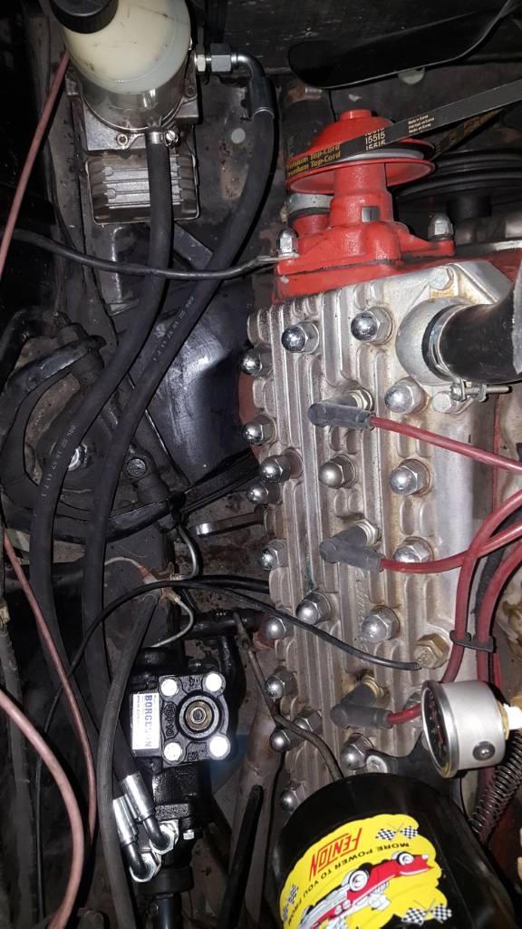

    Steering box in place and shifter reworked(pictures comes later) next question; one solution im considering as pump is to use electric, but my question is:
    Will my box work ok with pump designed for racknpinion??
    The pressure is lower(1000 psi) but constant regardless rpm of engine.
    Will it be hard to steer? Anything i oversee? Anyone with experience?

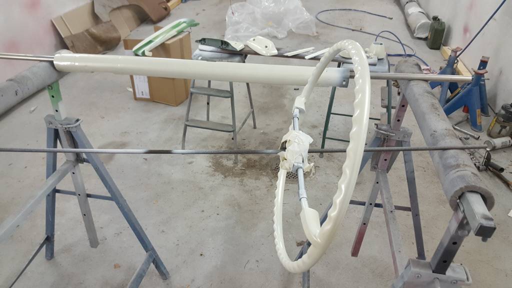

    Finally the steering parts are falling into place. Gear-selector working and waiting for paint. 20190305_202555.jpeg 20190305_191908.jpeg 20190117_195200.jpeg

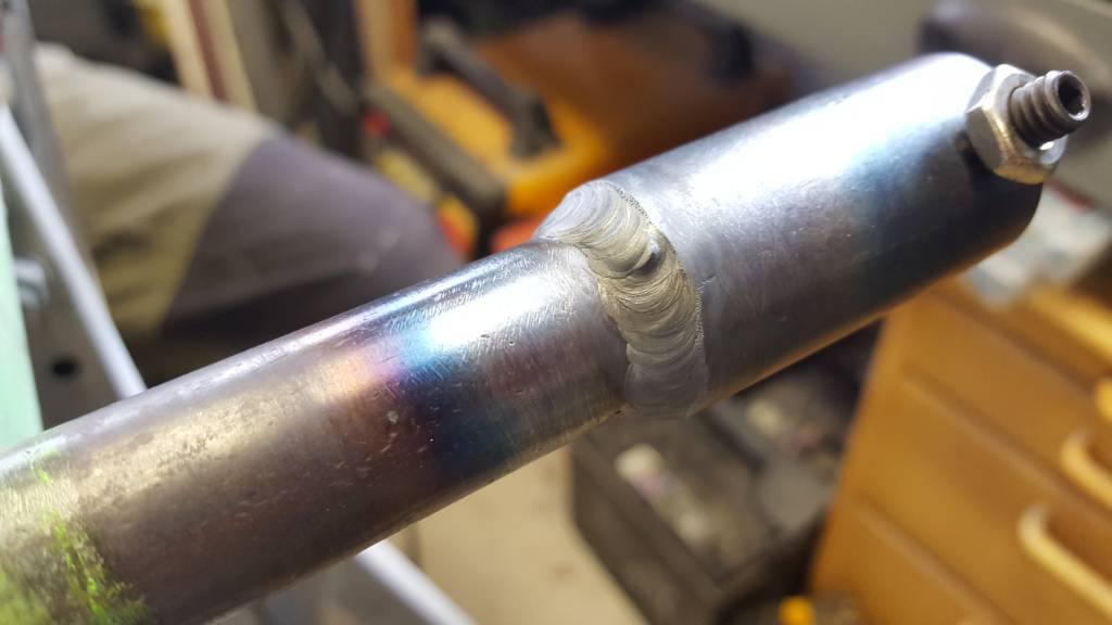

    Adapter on steering axel TIG welded, was planning to add two pins but wad not recommended to do that since it is tube and not homogen axle. Any ideas?

    Testing the fit, must cleanup, paint and sort up wires before final installation.
    Testing was successful regarding function, but the pump is a bit noisy.
    Also need to arrange some function to start the pump only when engine is running.
    I have powergen with only one wire out so signal from alternator is not possible.
    Planning to add oilpressure contact and relay to make pump start when pressure is built up. 20190320_204758.jpeg

    Had to add some paint on the parts before assembly. Volvo vanilla pearl. 20190409_201537.jpeg

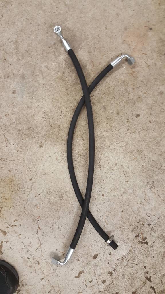

    After one summer of driving I am very satisfied the merc with borgeson steering box and electric pump.
    The steering feels like a modern car, 4 rounds stop to stop and got rid of the sloppiness.
    The electric pump give a slight high frequency noice in engine bay, but not so loud its annoying.
    Hope the pictures can be of help if anyone go for the same solution.
