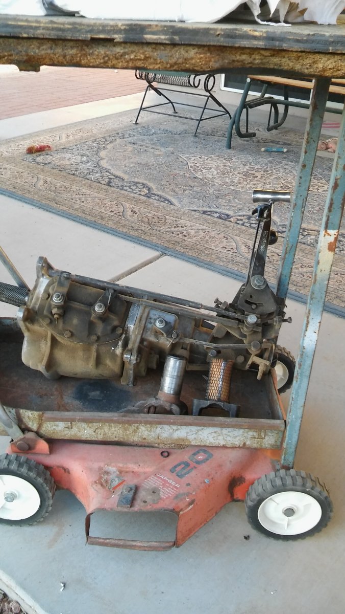

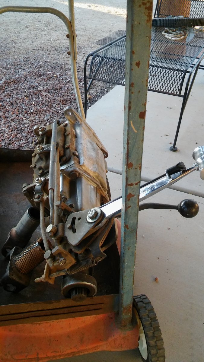

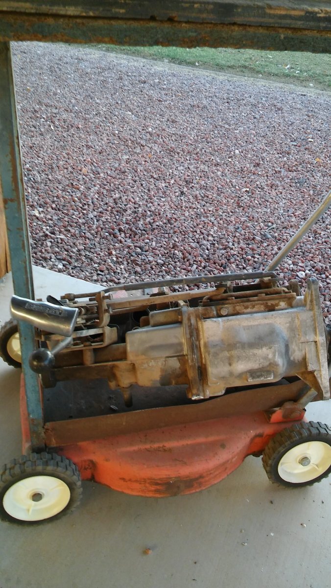

    Here are the pics they sent me

  8. The early T10s were notorious for popping out of gear on deceleration after they got worn due to the syncro design. It was a design flaw that was addressed when it was upgraded into the 'Super T10'. Good trans for a small block, more than a bit wimpy if running any big block. BWs slowness in upgrading them is the reason Ford/GM/Mopar came out with their own 4-speeds.

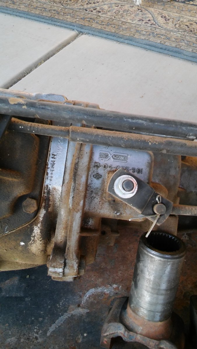

    Looks like 13-04-066-901 I think. Anyone know if I could use this with the 337 Flathead I have? Some modification if I need to is fine.

    I meant the stamped numbers, on the case, not on the tail housing.

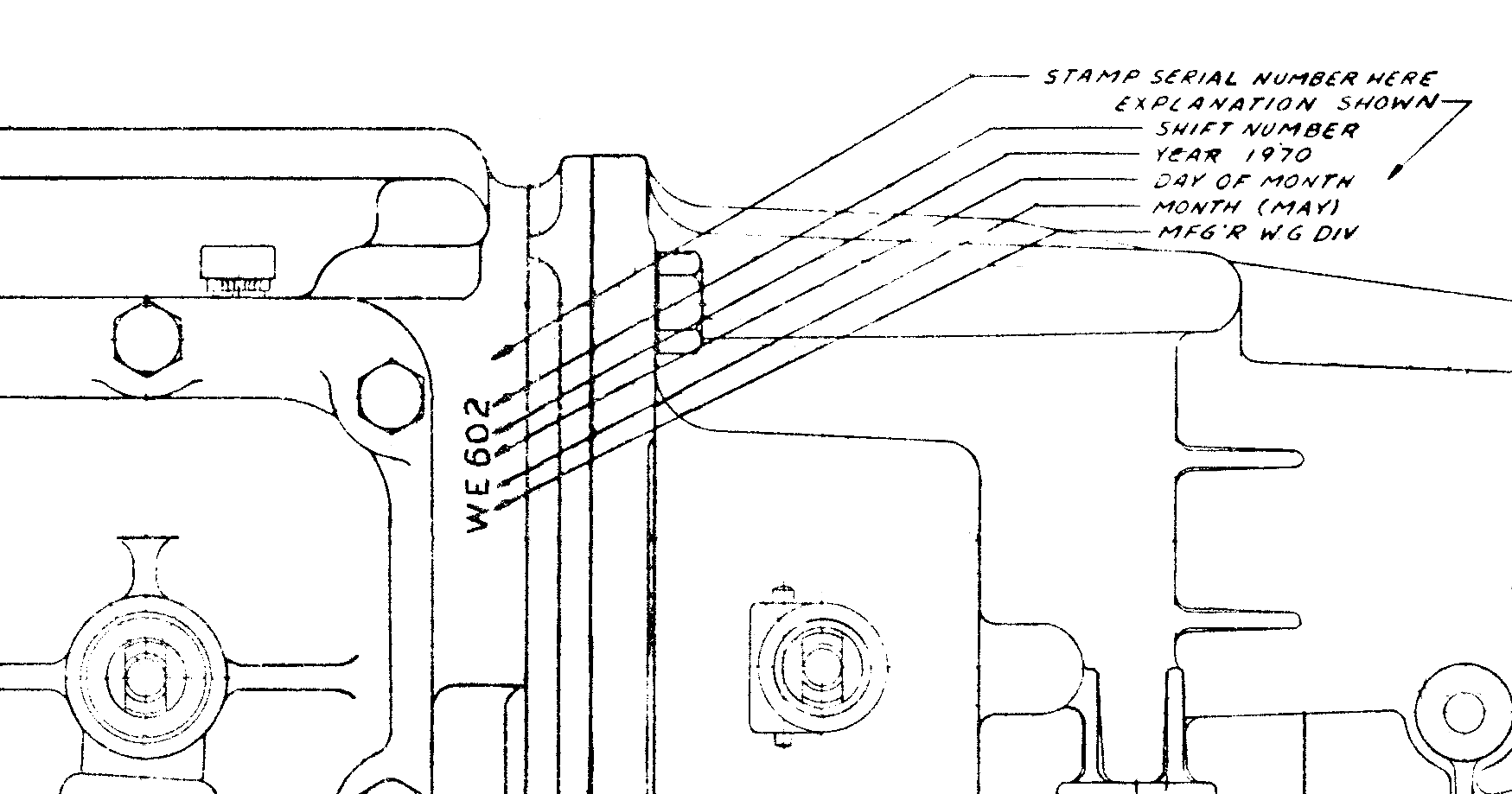

    actually I was talking about what looks like a partial VIN, next to the date code

  17. Ebbsspeed
    Joined: Nov 11, 2005
    Posts: 6,257
    Ebbsspeed
    The VIN would tell you what the transmission originally came in.

    I see a few things that say Super T-10, the trans has a fine spline input shaft, the main case has a breather above the rear of the side cover and the tail shaft housing has Borg-Warner cast on it. I think all the early T-10’s were coarse spline input, the only T-10 that came with that breather were the Ford boxes that pre-dated the Ford top loader and that logo on the t/s housing is (was?) used by B-W for their aftermarket automotive lines.
    Before GM started using Super T-10’s the S T-10 was sold over the counter at speed shops and the big draw was the improved metallurgy of the gears.

    Yes it does look like a super T10. That would explain why it had a partial VIN.

    I’m pretty sure the First Design Super T-10 had a coarse input and output. The Second Design has the fine spline input and Turbo 400 sized 32 spline output. One photo from the OP shows a fine spline output.
    Another thing I didn’t notice before was the switch on the side cover. IIRC that was used to only provide vacuum advance in high gear as part of GM’s emissions system. That switch pegs it as a later trans and not a T-10.
