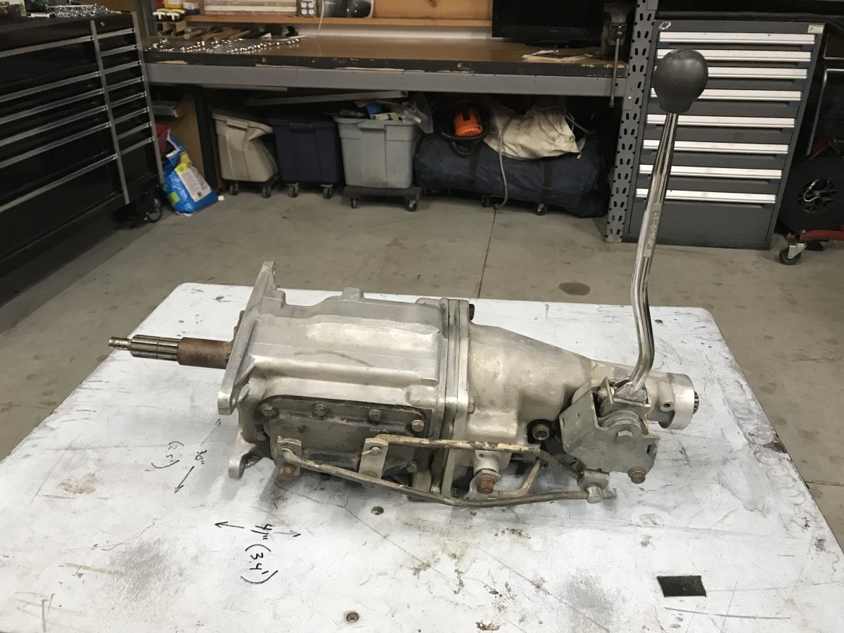

    445965D5-114D-495C-BAE8-388F9609E225.jpeg I picked up a T10 the other day but am finding some conflicting data for dating it...
    It appears to be a standard Borg Warner T-10
    Case stamping is T10-1C
    Serial number on the case is WB2772
    T10-7D tailshaft dated 11-2-66
    One input groove - wide ratio 2.54 1.92 1.51 1.0
    10 spline input, 16 spline output
    I’m sure it’s been thrown together over the years in non-factory configuration, but I’m having trouble dating the case. I had read that the 1C stamping was in the 1961-1962 timeframe, but the serial number WB2772 points to a year ending in a 7?
    Thanks for the input. I think it will work well in my 29’ roadster with a Buick 215, really more curious than anything.
    thanks!

    The regular T-10 was last used in Chevys in 1963 but ?Buick, Pontiac? used them till 65/66 in some models, like you surmised a lot has been pieced together over the years.

  8. I have rebuilt a few of these.......pretty straight forward. Bad syncros is the usual suspect for popping out of gear when decelerating. Could also be from a worn input/front bearing. Pretty sure the all-aluminum case is mid-'60s.

    Its a shame someone butchered the shift rods , just wow !
