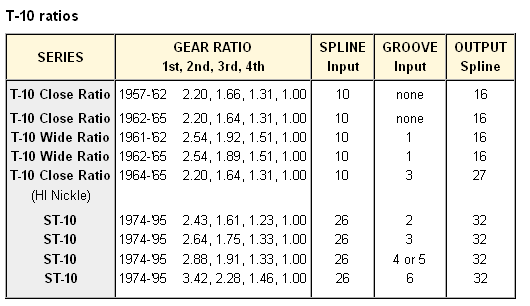

    ok, took a few more pics and looked closer at it. its cast iron with Aluminum tail shaft. input has 10 spline with 1 grove going around the spline, there is also numbers on the plate that goes around the input spline.

    just wrote all those down, im guessing the T-10 wide ratio 62-65 2.5,1.89,1.51,1.00, 10 input spline, 1 groove , and 16 output, must be mine. 56 Sedan is right ,i think, it looks like its either Olds F-85 or a Buick Special

    I got that on the H.A.M.B. sometime ago. Very handy I used it to date a few T10s. Copy and put away very handy.
