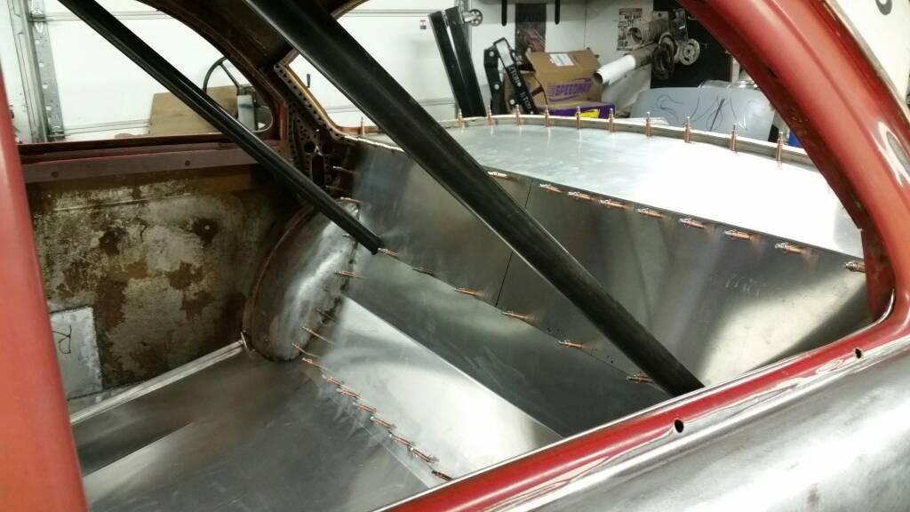

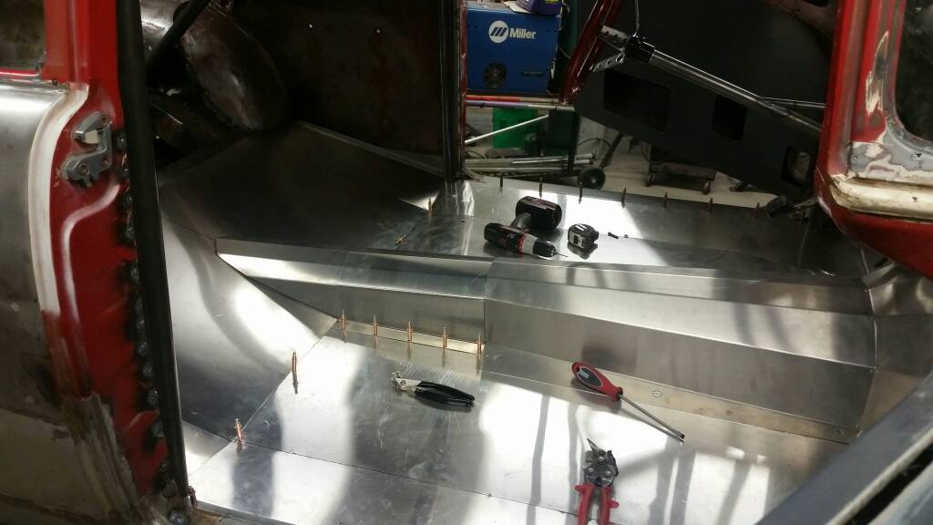

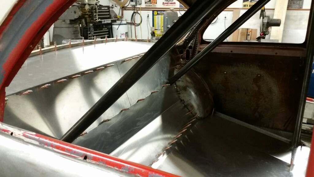

  18. I think I have the hard parts of the tin work done. It took longer than I thought to get as far as I am now. I plan on getting the side panels done and then finishing the big piece in the trunk this week. After that is all done I'm going to Finnish up the cage and the rest of the welding on a few small things. Then it will be off to work so I can do the body work and paint. I decided I would just take it to the shop because it will take half the time to do and won't make a complete mess in my shop at my house. May is approaching fast and I still have a bunch of work to get done but I am feeling really good with the progress I have made.

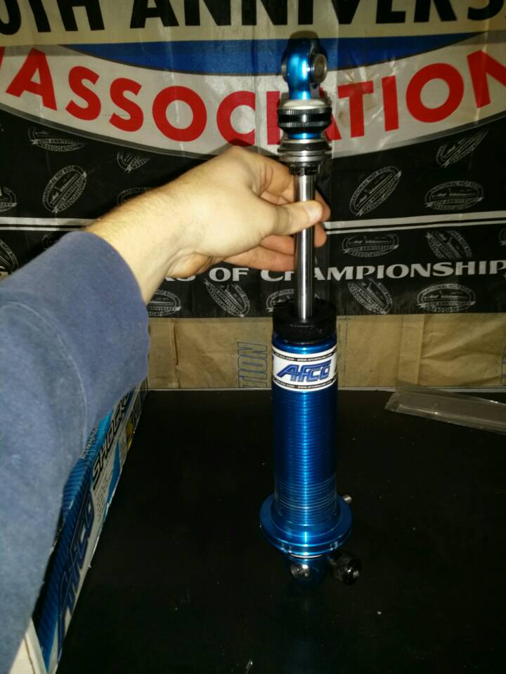

    Picked these rear shocks up yesterday with jeff, brand new just used for mockup got a good deal
