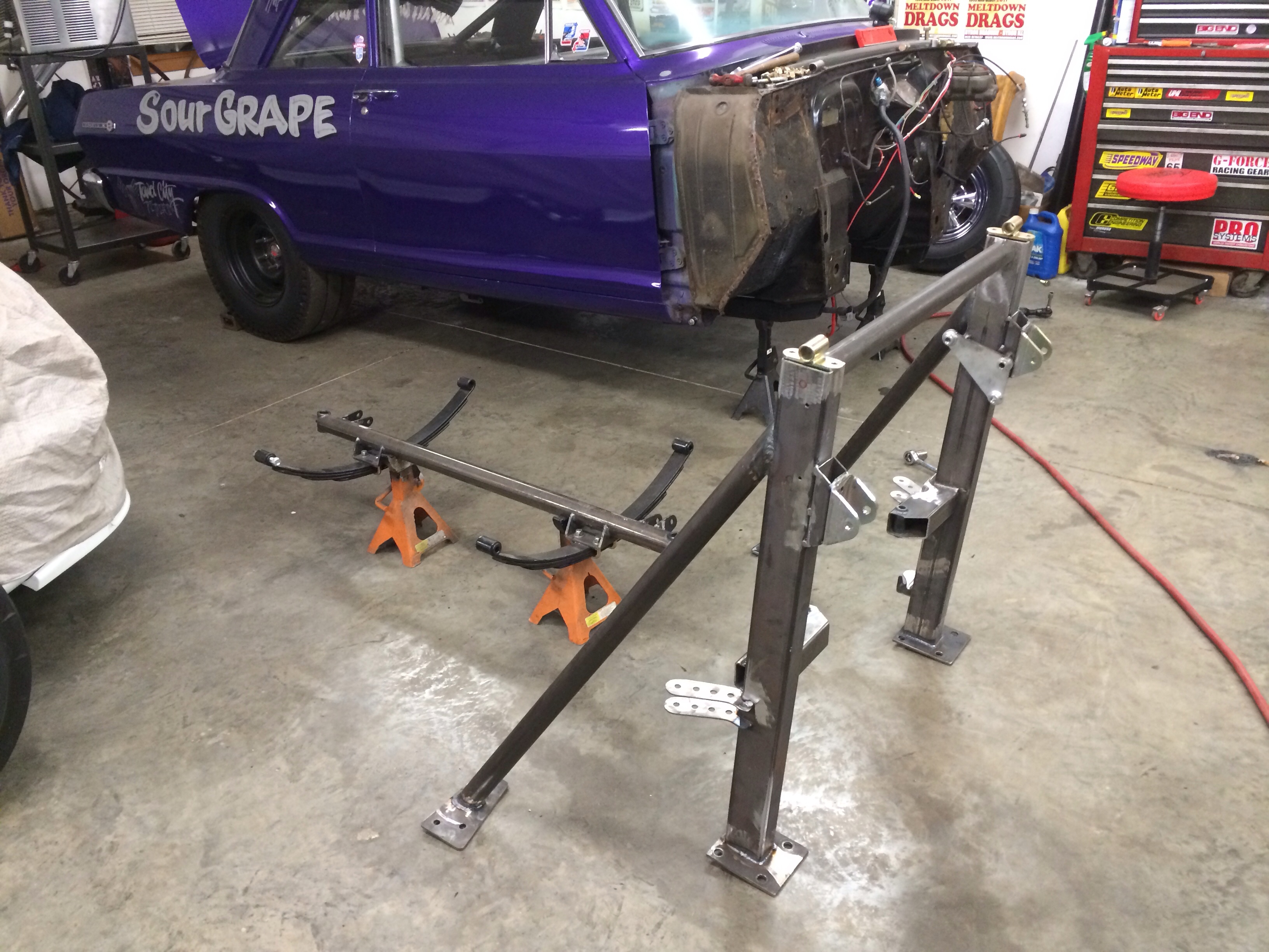

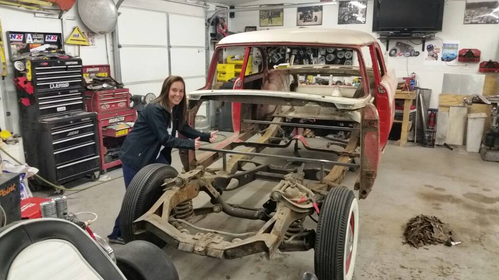

  13. Did some more cutting on the ol ford the last few days now build the new front half and mount the axle. Even caught the wife checking progress she gave it 2 thumbs up

  16. In that first pic I was like - that suspension looks really heavy - then it got real light real quick :D

    Nice group of cars. BeeBee are the new frame rails 2X3'sX 1/8"? Going to cut off the front frame of my Hj and am thinking of using that size rec tubing. Thanks, Henry.
  19. Looks like some serious commitment here, so I'll just say this once. Chromoly, Aluminum, fiberglass & Aluminum only!, no mild steel anything! That starts with the front stub too, you can buy 2 x 3 chromoly. The Pale Rider is barely more than 2700 with a big block & Shannon in the seat! That's about 2550 without him! This isn't counting the 23-2400 lb. Willys & Anglia's. The instant you start welding mild steel back in, your going backwards. I've been watching several new builds, and seeing enough mild steel to build cruise ships!
