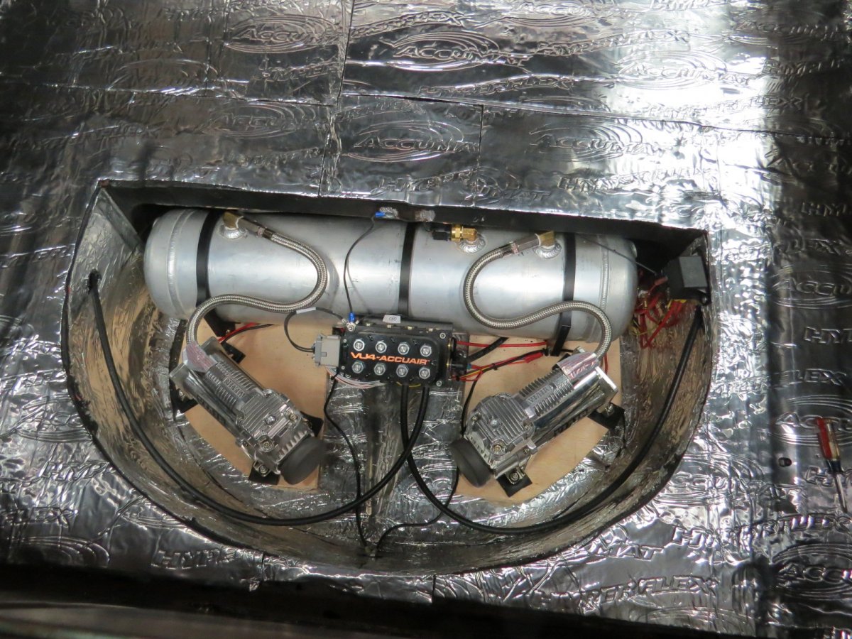

    First redo of original design, I decided I did not like how I had set up the Accu-air components, so I am moving them to the spare tire well. no pic yet but its new location will allow for easy access (before I had it hidden behind interior panels or up under the qtr panels. not a good place to be if you have to trouble shoot while on a road trip.

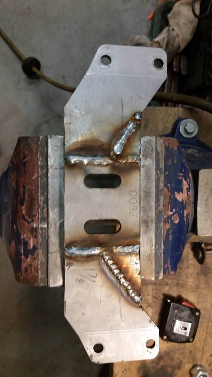

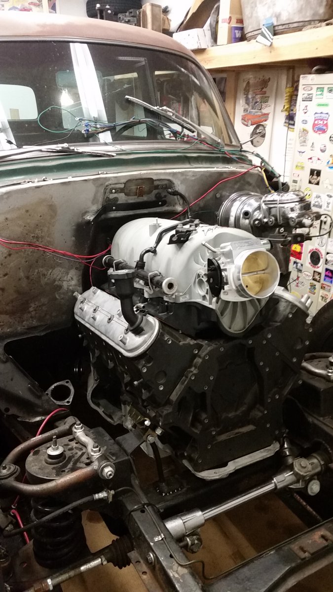

    Winter time again, back apart for upgrades. time for new motor install was in the plan, so I started to make changes and mock it up. Required new trans mount and changes to motor mounts. first issue, trans is longer.. so I had to take my spare mount and rework it. 246.jpeg
    Cut apart and reshaped. (this is for mock, I will fab a solid replacement once I know it works as i want. 256.jpeg
    Mock up in..

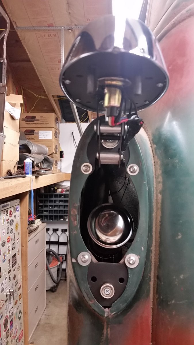

    Decided since I had to relocate the filler spout on the tank to work, I would customize the gas fill and place it behind the tail light. I used a flip down kit I found online.

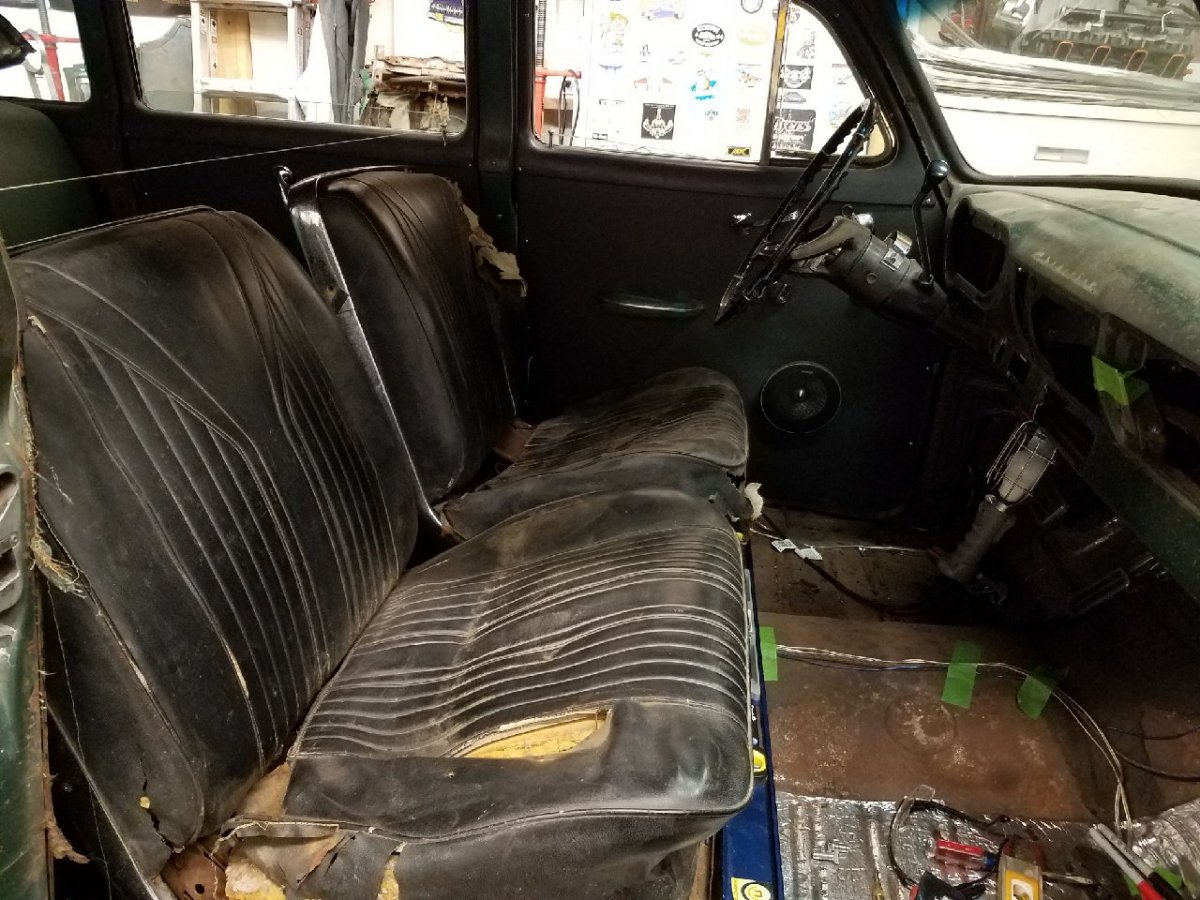

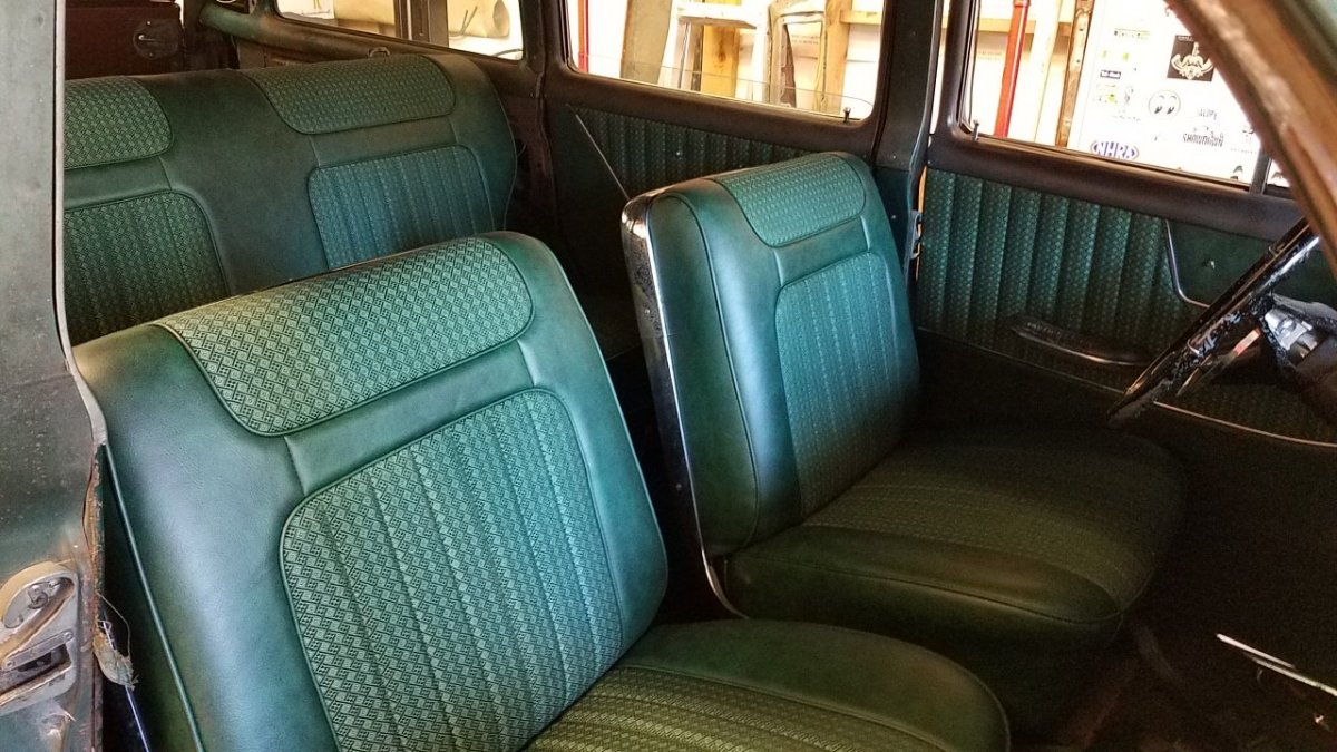

    Summers over and now it back into the shop. while on my last trip home from CA, the padding in the stock bench seat finally gave out, I had to go buy a pillow to sit on for the drive home., it was that bad. It was time for interior work. Plans were to do a retro styled interior that favored the wagon look.

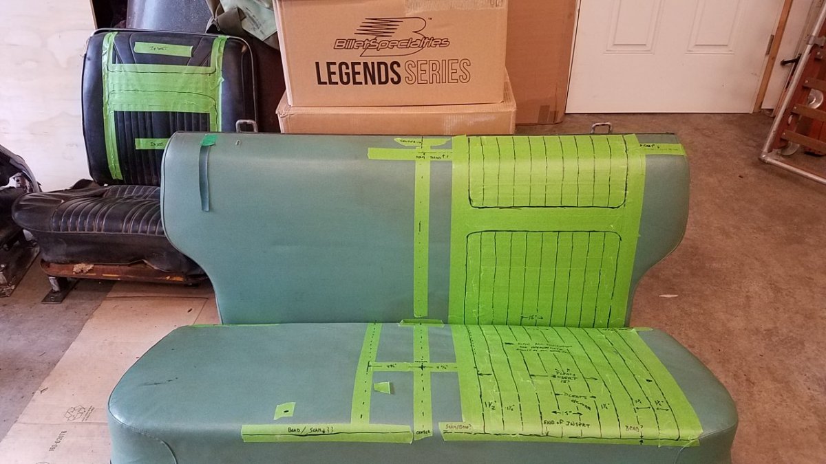

    My dad gave me an old set of impala seats that I hauled home from my Pleasanton trip (they live real close to the show) but they required a full rebuild, they were free, so what do you expect...
    mocked into place,
    Rear seat mock,

    Here are some pictures on the rebuilding of the front sear.
    all apart, stripped and painted. frame
    Here is the material chosen, its a 1970 Dart pattern along with a vinyl that has a warn look (to go with the patina outside)

    It took a few weeks but the seats and door panels are complete. I am happy with how it has turned out. Now I realize I will need to rechrome the band around the tip. it looks good but not as nice as I would like (future project).
    Front seat

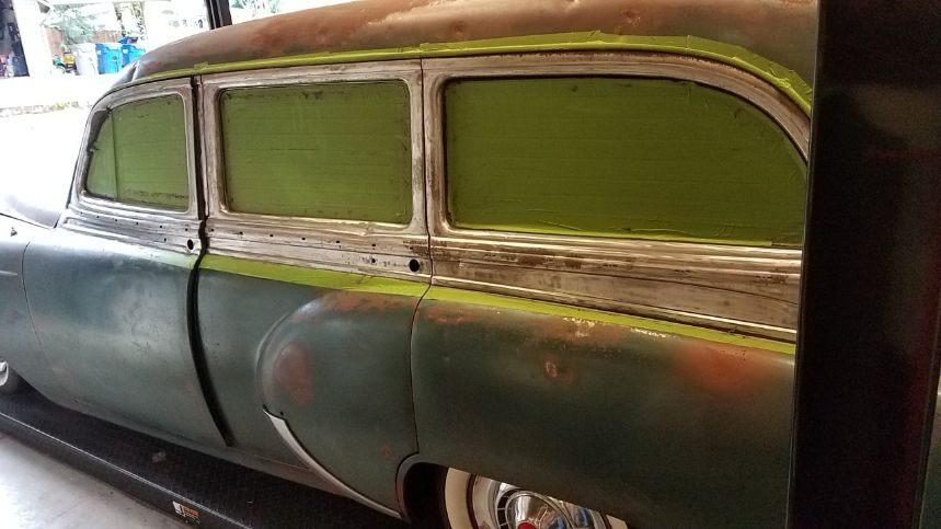

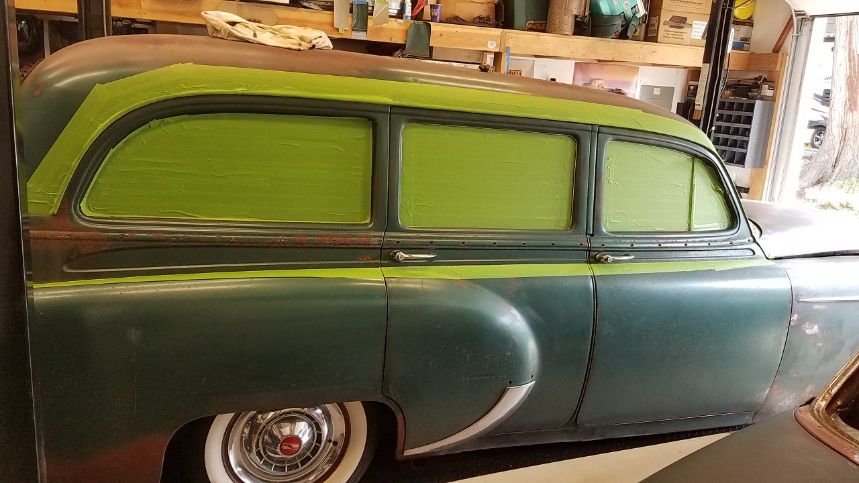

    Its now winter 2020, COVID has hit and so has the industry I work in. i have been saving up for some upgrades and decided I would go forth and get some done. Started with janking the 327 out again, this winter I plan to finally paint the firewall and correct the overheating issues. I have wanted to wood grain my wagon since I bought it. I wanted the new wood look but aging body. A good friend does paint work and is very talented. (Byers Custom Paint in Auburn WA). I did all the prep work of stripping and he did a quicky woodgrain treatment.. but thought a aged wood style would look best.
    started with masking off the areas to not be touched.
    Let the stripping begin.
    since the tailgate had been previously stripped when the rust was repaired and put into primer, he did not need me to strip it. A while back I found a replacement upper gate for the original that has some rust. Got it stripped
    Drove it down to the shop,. all unecessary parts removed (took back roads to hide due to lack of safety gear..
