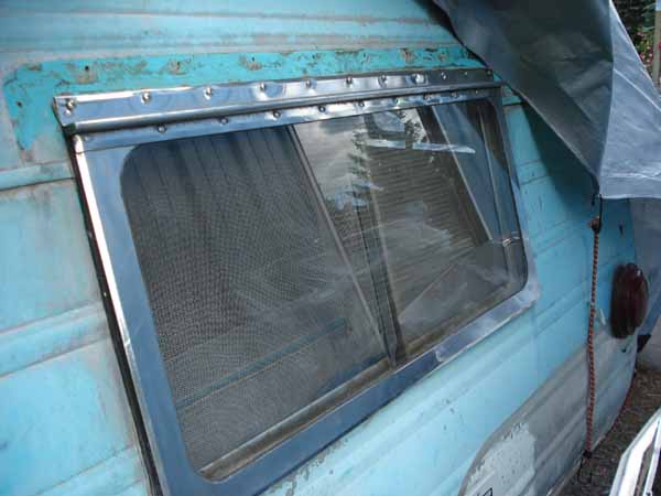

  13. J-lopy Kid
    Joined: Jun 1, 2009
    Posts: 127
    J-lopy Kid
    my girlfriend cleaned out the camper; keep in mind, the way these are being built to make bonneville will not reflect the finished deal in entirety.
    I replaced the rear window (was broken plexiglass), and resealed it. Tried polishing the frame; looks ok.
    We got the upholstery back. They did a great job; and measured my design out well. The bed folds into a couch for lounging time.
