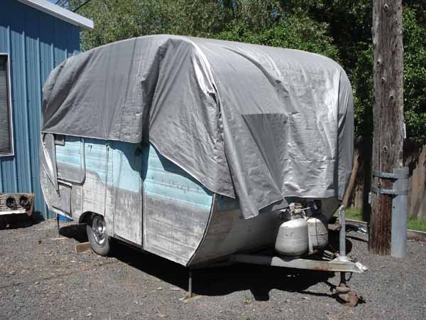

    The camper we picked up is a 1956 Jewel 15'; with decent interior wood and somewhat functioning appliances.

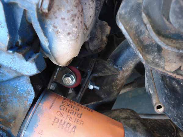

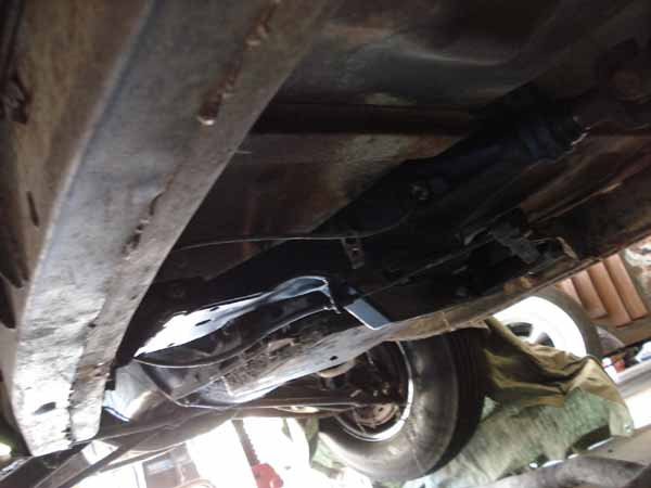

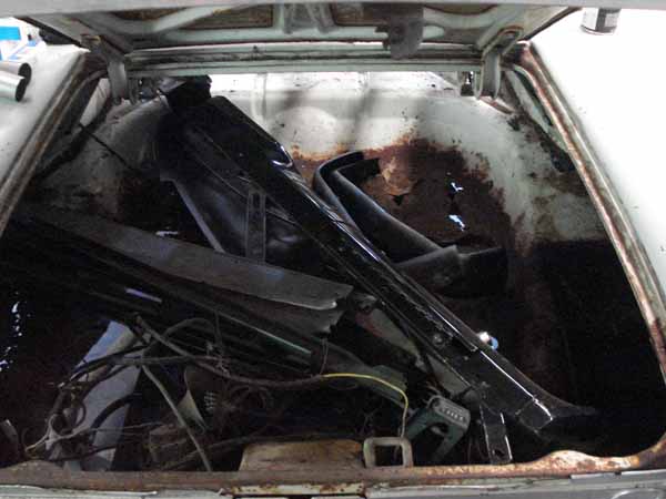

    Got the car pressure washed, and really looked it over. Rust in the rockers, and the trunk but all in all pretty good. Did not like the motor mounts at all; somebody had taken mounts from a different car and cut away at them until 2 bolts lined up (429 has 3 per side at the block). The passenger side manifold was hitting the upper A-arm, and the starter was resting on the steering idler arm.... A piece of C channel was used for the trans, and, Lag bolts holding it into the frame...
    -Yes, I said Lag bolts like you would use in wood. I believe this cross member was for mockup.
    So, new mounts and new trans X-member; and a good and proper centering of the motor and driveshaft alignment!

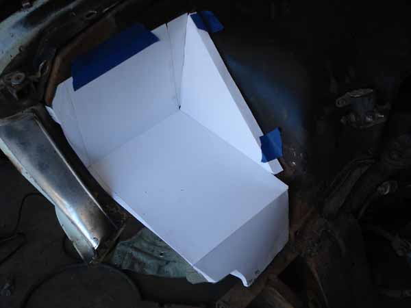

    Did not get nearly as far as I wanted to today; but fabricated a battery tray similar to the original (now 16 gauge); and now the angle has changed allowing for a much larger battery. Don't have a box/pan break; wish I did; so I perforated the folds with the plasma to make it easier to bend. Mocked the radiator in for height; still need to build mounts. The radiator is much larger than stock (71 thunderbird); and required the battery to be moved into the fender a little; no problem being that the battery tray was rotten.
    Yes, this will be my driver, and feature a newer motor and disc front brakes; and modern swaybars; and lowered a few inches. I also want to tow with it; as, currently, I have no vehicle to pull a car trailer if needed. I want the girlfriend to feel safe driving it; and try to get her into my hobby a little. I plan on a flake roof, and mild bellflower theme for this one.
