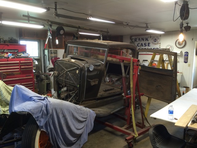

    Here are photos of a couple methods being employed together. You can see an engine hoist for lifting and a come along for stabilizing. The pipes suspended from the ceiling are tied in to trusses in the attic. In this case, the engine hoist is lifting on a bean that was installed to stiffen the body. This car had a rotten sill and was being lifted to repair the sill in place. If the body was coming all the way off, camper jacks would be used.

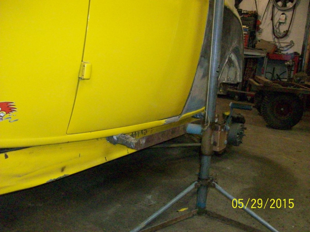

    I've used a pair of modified camper jacks for everything from my '53 chev to heavy early 70s stuff. They allow you to roll the chassis out from under it easily. Centered on the door handle. 100_1757.JPG 100_1758.JPG
