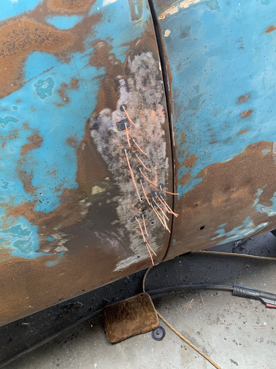

    That might be worth your time to check in to rather than have to build up more than you would like. They work pretty good from the limited experience I have. Maybe its easier to work the dent with lots of stud welding and small movements out with each one. Then remove them and maybe a little shrinkinng.

    Some places just aren’t accessible like this door. You can use them for shrinking too. C4622F9E-0C70-4F66-84D3-DC292A0601D2.jpeg C933F555-DC8E-4BD7-B24A-F05C4B463D22.png F33E1DC4-2DB9-4BCA-9D4B-AE7BE9A1271B.jpeg
