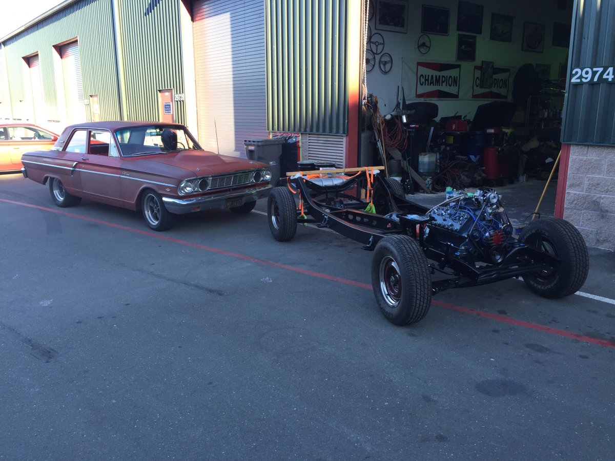

    The chassis was repaired/restored and it and all the suspension components were powder coated.
    I replaced the original rear axle with a Columbia Overdrive.

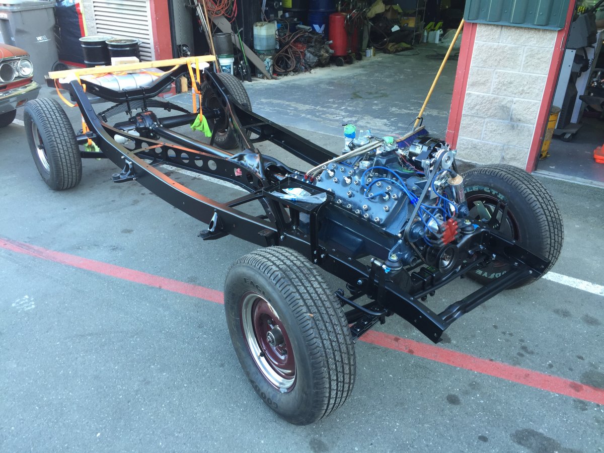

    And put it all together into a rolling chassis.

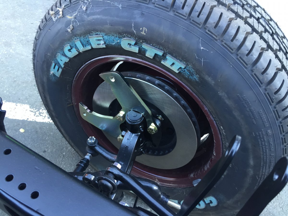

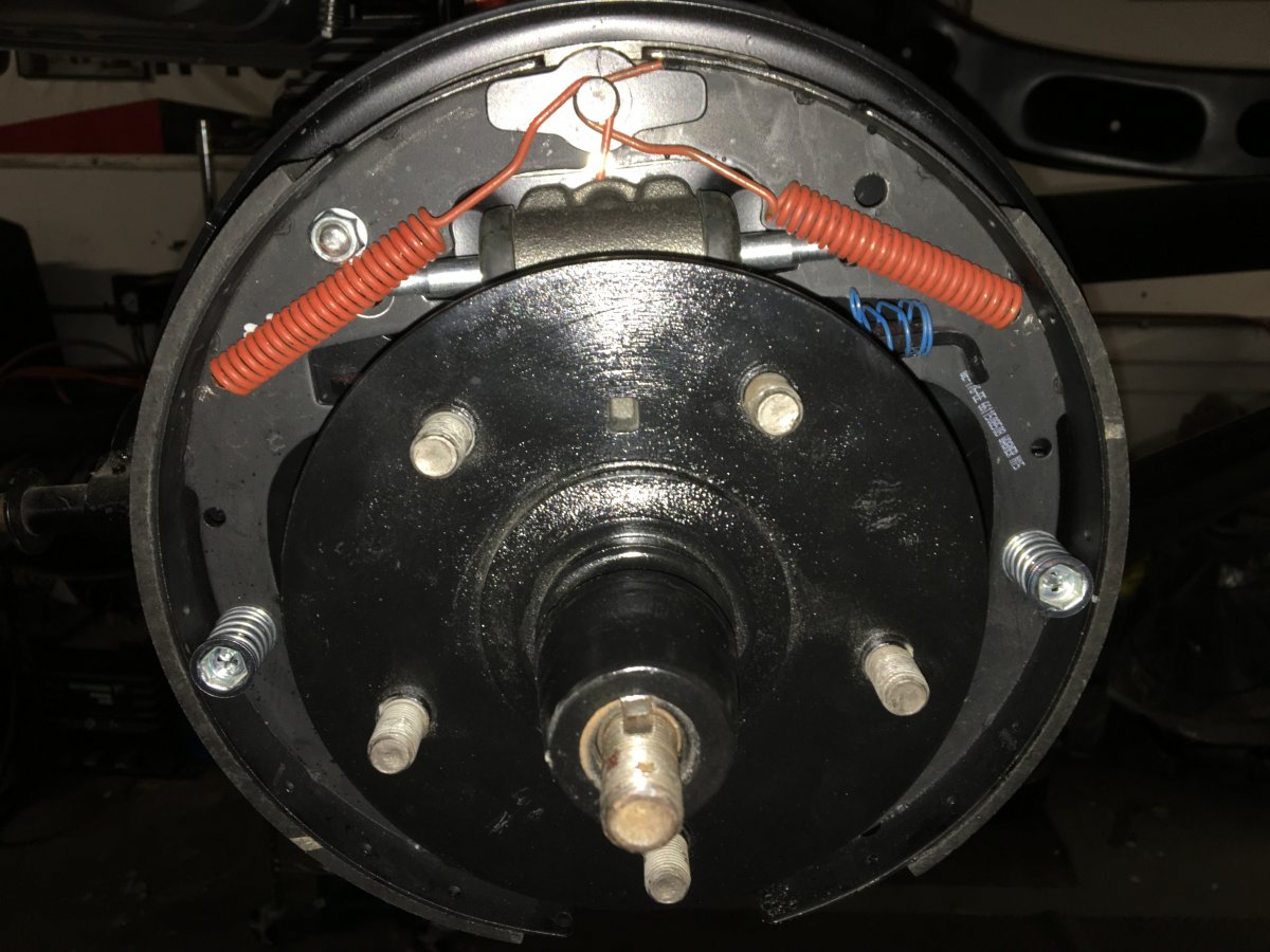

    Since I plan on driving the car for some time I decided to upgrade a few things... I added Ford F-150 front discs , Lincoln rear drums and installed all new suspension from Posie's.

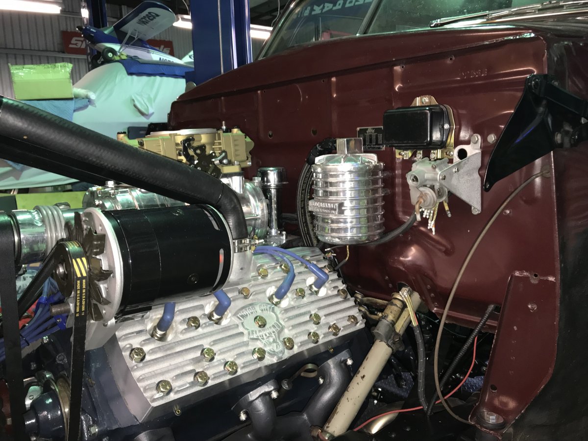

    The engine is the car's original 59AB. It's got +.125" Egge pistons, 4.00" crank, 8BA rods w/ARP bolts, ARP main studs, center main cap strap, Isky Max 1 cam, Isky springs, SS chevy valves, ported block, Motor City Flathead heads, Fenton exhaust manifolds, Mallory Distributor, MSD 6BTM, a Weiand 142 Supercharger from Roadrunner Engineering and a Holley Terminator Stealth EFI system from Holley EFI. I've spent a lot of time redoing things trying to hide anything that looks modern, its obviously a work in progress.

    I added a return style fuel system and wired everything using modern wire that is covered in fabric like the original.

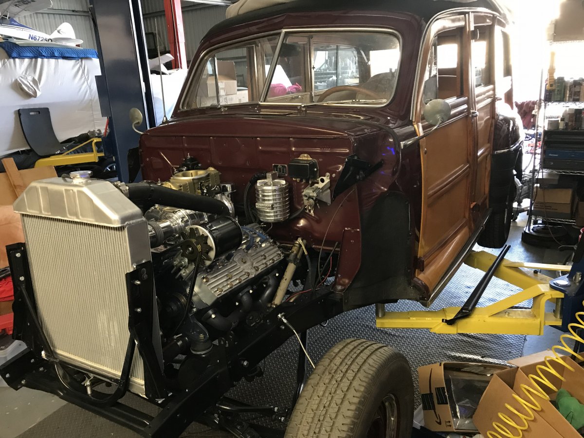

    Then I reinstalled the body.

    Since I didn't take the front end apart, I don't know how it goes together. Apart from websites like VanPelts, I'm not sure how the front sheetmetal goes together. I can't find a build manual for this car. I'm also not sure what hardware to use. So far the car has been put together with stainless hardware where it is safe to use and zinc-plated grade 5 and grade 8 hardware everywhere else. I live in San Francisco so rust is an issue and I really don't want to do this car a second time. Does anyone have a 42-48 Ford that can take pictures of how everything is bolted together? Does anyone have a 42-48 Ford in the Bay Area that I can come look at?

    The brakes are fantastic. I'm using the Speedway Motors 91031909 front disc brake kit and the Boling Brothers "Banjo Rear Brake Kit". Between the 11.75" front discs and the 12'x2" rear modern drums the thing STOPS!!! I'm using a Wilwood 1" remote master cylinder, proportioning valve, and 2 & 10lb. residual check valves.
    I'm using the Mallory Magnetic Distributor for the timing curve. It runs into a MSD 6BTM that pulls timing under boost. The MSD has a square wave output (tach out) that goes to the Holley ECU as the ignition input. Works perfectly. Starts and runs like a brand new car. Perfect fueling all the time no matter the load conditions or environmental variables. I started with a Holley Dominator but I switched the Holley HP ECU, this build doesn't warrant the use of the Dominator as I'm only using the ECU for fuel mapping and fan control. The Dominator is for the Fairlane which is soon to be twin-turbo, 1400HP, 4L85E, Traction Control, ABS, etc.
