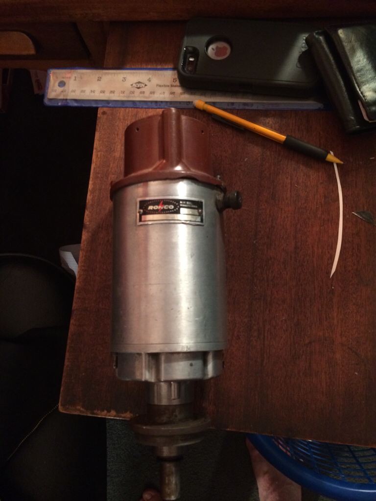

  5. Nice looking mag ! I drove mine on the street for 2 years, no problem except when stuck in traffic it would foul the plugs. I have a number for a good magneto guy in Texas if you need it.

  9. The generators are all the same exept for rotation. Its the base and drives that are differant. Those vertex mags only have about 1-1.5 amps. They do need service at regular intervals. The magnets need to be re zapped. Points need to be changed or reset. Cap rotor and wires replaced. I use a guy in south milwaukee. Ram racing. If you need the number let me know. I would still go msd. The msd requires no maintenance.
