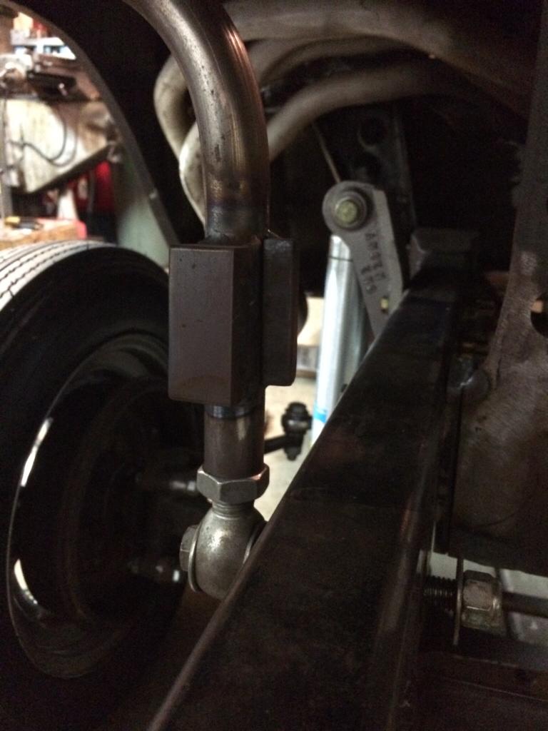

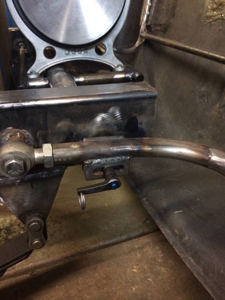

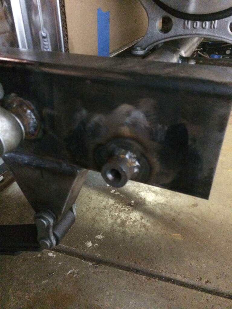

    Those are to lock the flip front end in place with a quick release pin.
    Here's where the pin goes into on the frame this is also a stop for then the flip from end opens. A lot of people use cables but I wasn't a fan of that.
    Here is the flip front end you can see the block for the pin and also a piece of 3/4 square to stop on top of the frame piece.
    And here is a picture of the pin in with the hood up
    Dog_Patch, Butch M and enloe like this.
