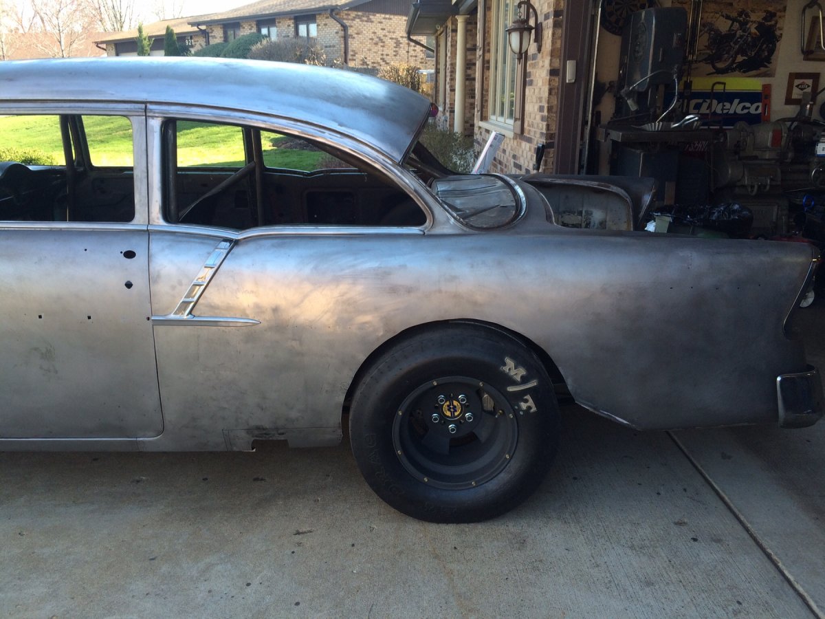

    My next project is getting the floor braces in then the floor. I need to get both quarter panels when I'm happy before I put the inner rockers back in. So here was my work on the passenger side. Drivers is next weekend. I made a handheld planishing hammer for less than $50.00 and got a 9" shrinking disk. It's not perfect, but a 1/16" skim coat should do it.

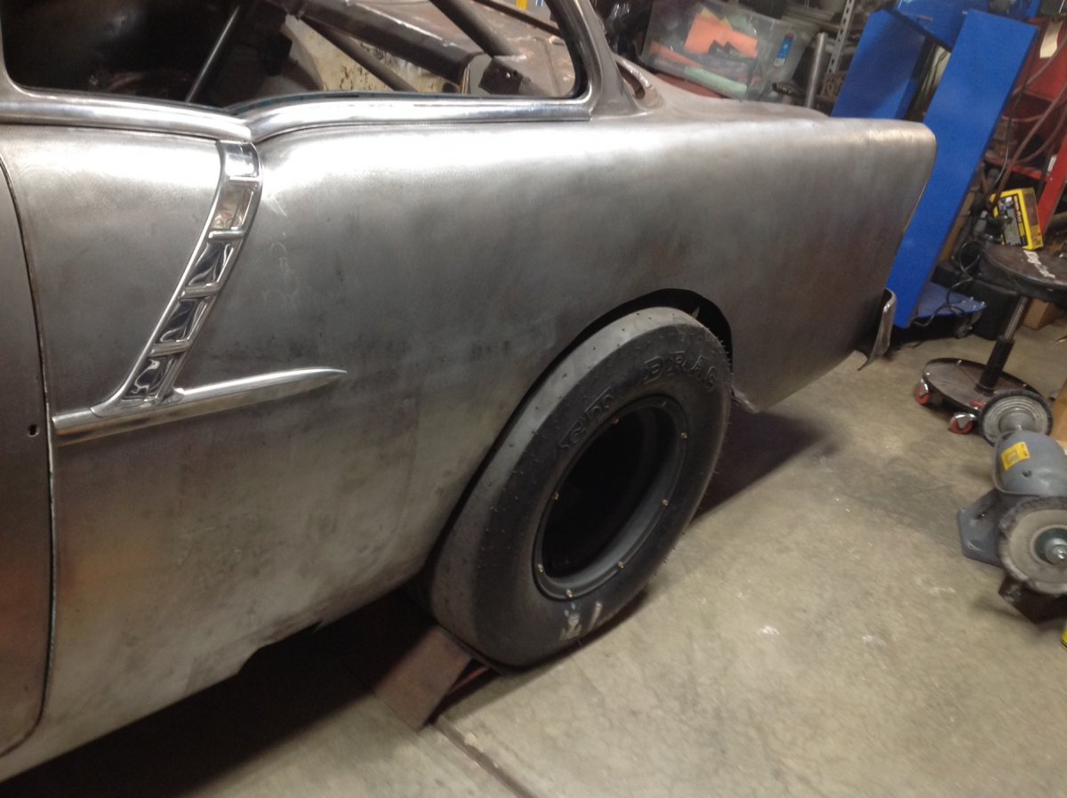

    I've been working on the drivers quarter trying to message that out before I put the inner rockers back in.
    Where I started
    I welded that patch In awhile ago shrunk it freaked out then way over stretched the quarter.
    All the metal is happy now. Just need to bring up a few lows. But my patience is thin.
    I also picked up a buffer and lost my
    Mind. Polishing aluminum on a car that doesn't even run. Buffing is easy it's the sanding before that. Something to do while watching tv.

    The drivers quarter is almost where I want it to be.
    Then I started patching a rust spot
    Still need to finish welding but coming out good so far

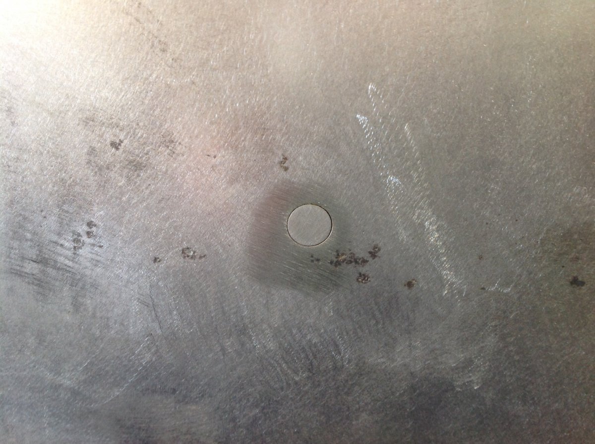

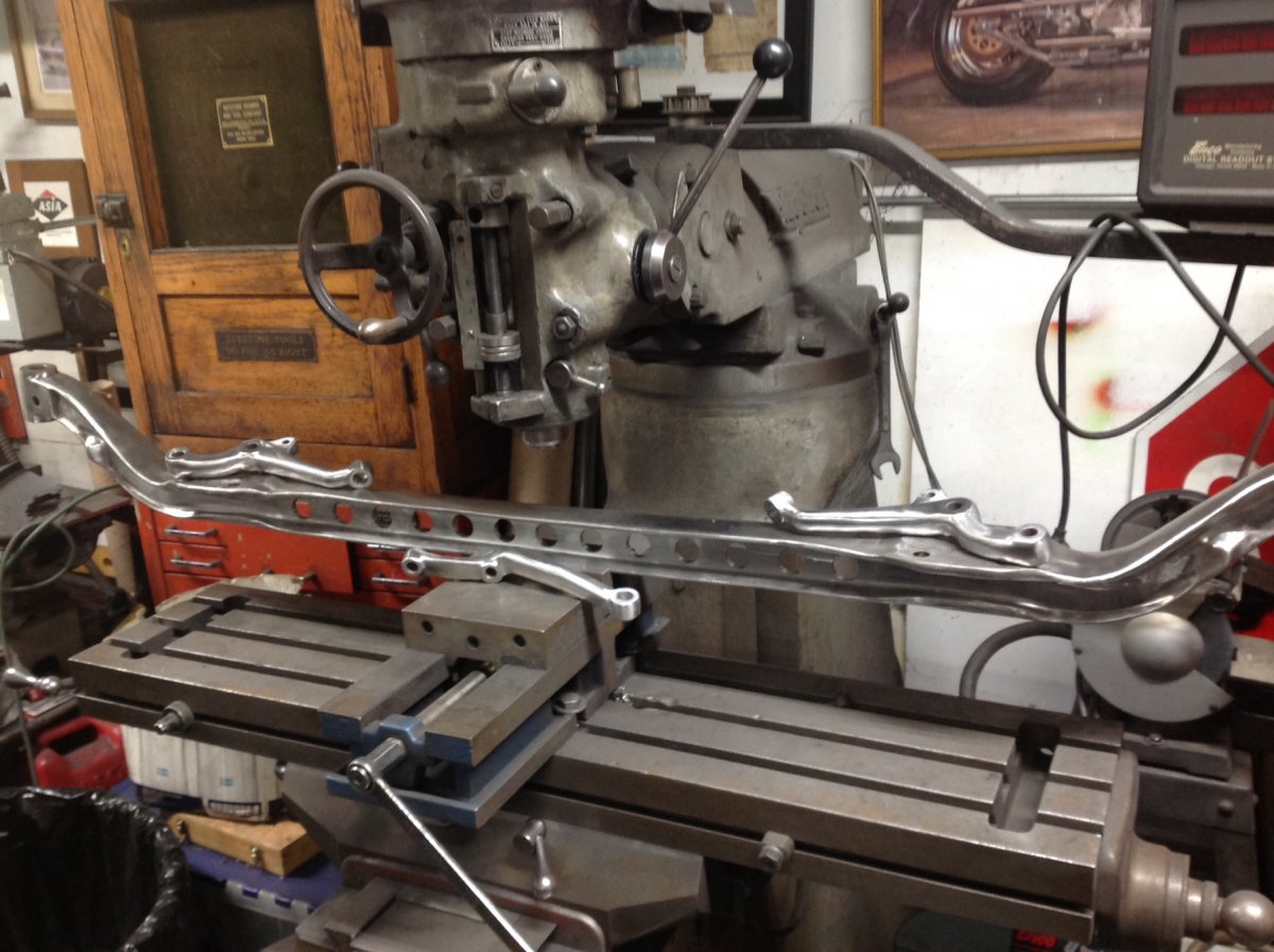

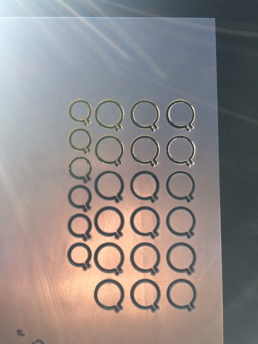

    This quarter panel has been kicking my ass. Almost there. Then I can really start getting some things done. Found another front axle to send out for chrome. I smoothed it out and drilled it. I'll send it to the polisher than out for chrome. I'm waiting to get my spindles back from getting matched then I'll send it all out. The spindles are getting machined for aftermarket brakes. No one makes a good kit for chevy truck spindles if you want to go fast. I've been working with speedway motors to make a kit. I filled the 210 trim holes. I had the plugs water jetted out saved a lot of time.

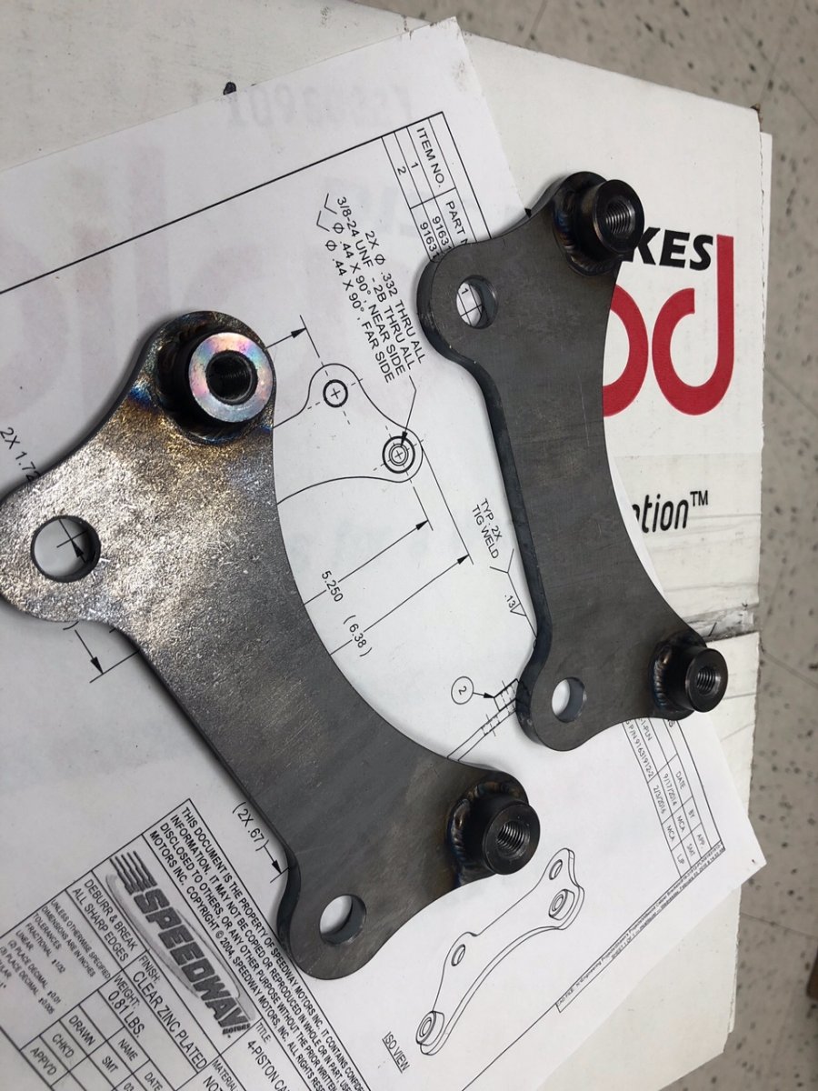

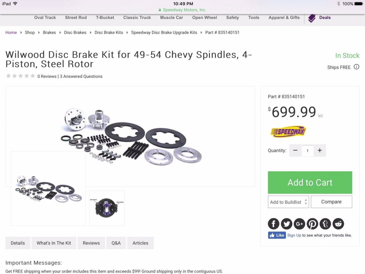

    47- 59 chevy truck. They have the kits that you can use gm metric brakes on. I found a wilwood kit that would work but only for 4-3/4 and 5x5 bolt patterns. My front wheels are 4.5". Seems wrong but lemans are hard to find in any pattern. Speedway makes a kit for chevy car spindle that have been machined. The stub on the car spindle is the same as the truck but the spindle geometry is different. And the spacing between the ears is different. So I'm adapting the car kit to the truck spindle. When I get everything back I will post some pictures. I had them machine two sets of spindles just in case....
  24. fast30coupe
    Joined: Nov 15, 2009
    Posts: 997
    fast30coupe
    from Illinois
    Here is the car brake kit. I ordered it with out the calipers so I could get mark Williams calipers to match the back. I think they look more old school than the wilwood. I know I need help

    My buddy at speedway sent me this the other day
    They are steel. But I'm at a point when I need things that bolt on instead of taking the time to make everything. Times ticking to make thins thing move.
