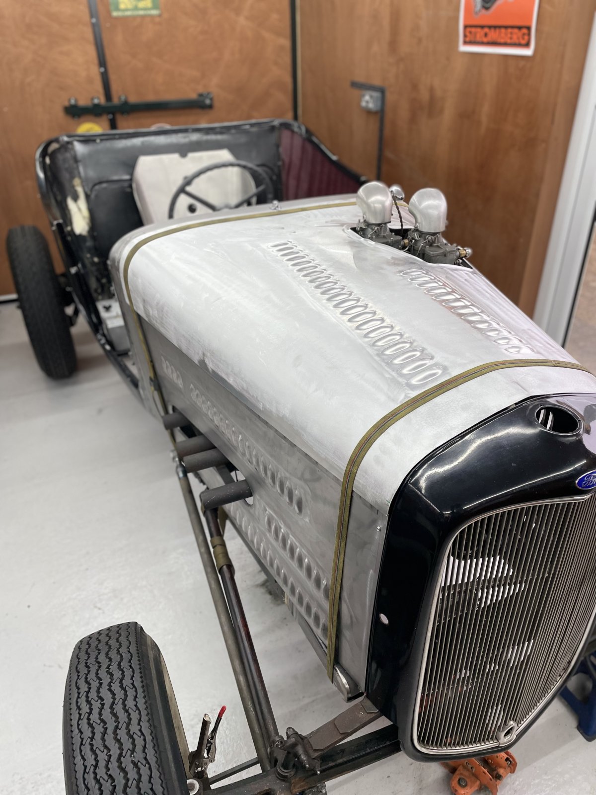

    The next bit wasn’t so easy though. I like the look of the Cooper/Hayes and the Navarro roadsters with the front cowl removed and long side and hood top. Will it work with a 25 T? Who knows, but I’ll give it a go. Maybe centre seat and steering too.
    First bit was to cut the cowl off from the door hinge forward.
    23AC944E-A5C5-48DD-9598-825B612C0CFC.jpeg A5109832-A559-4DF5-8062-5929BC2DCD32.jpeg

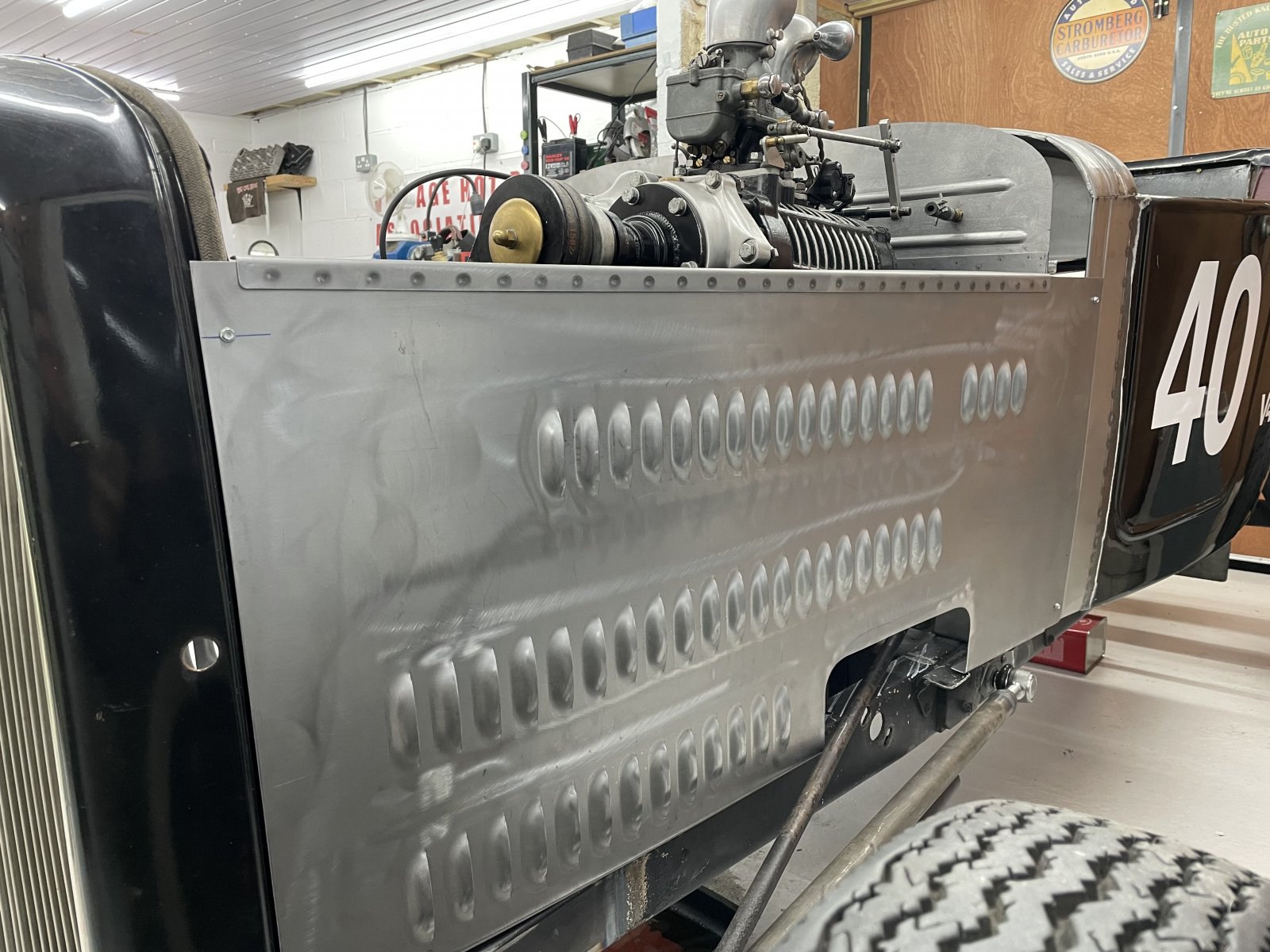

    I mocked up a repop 32 shell and grill. Plan is to build it with the shell then if I have time before Pendine I’ll make one akin to the Navarro one.
    Simple hood sides. Will be louvred later.

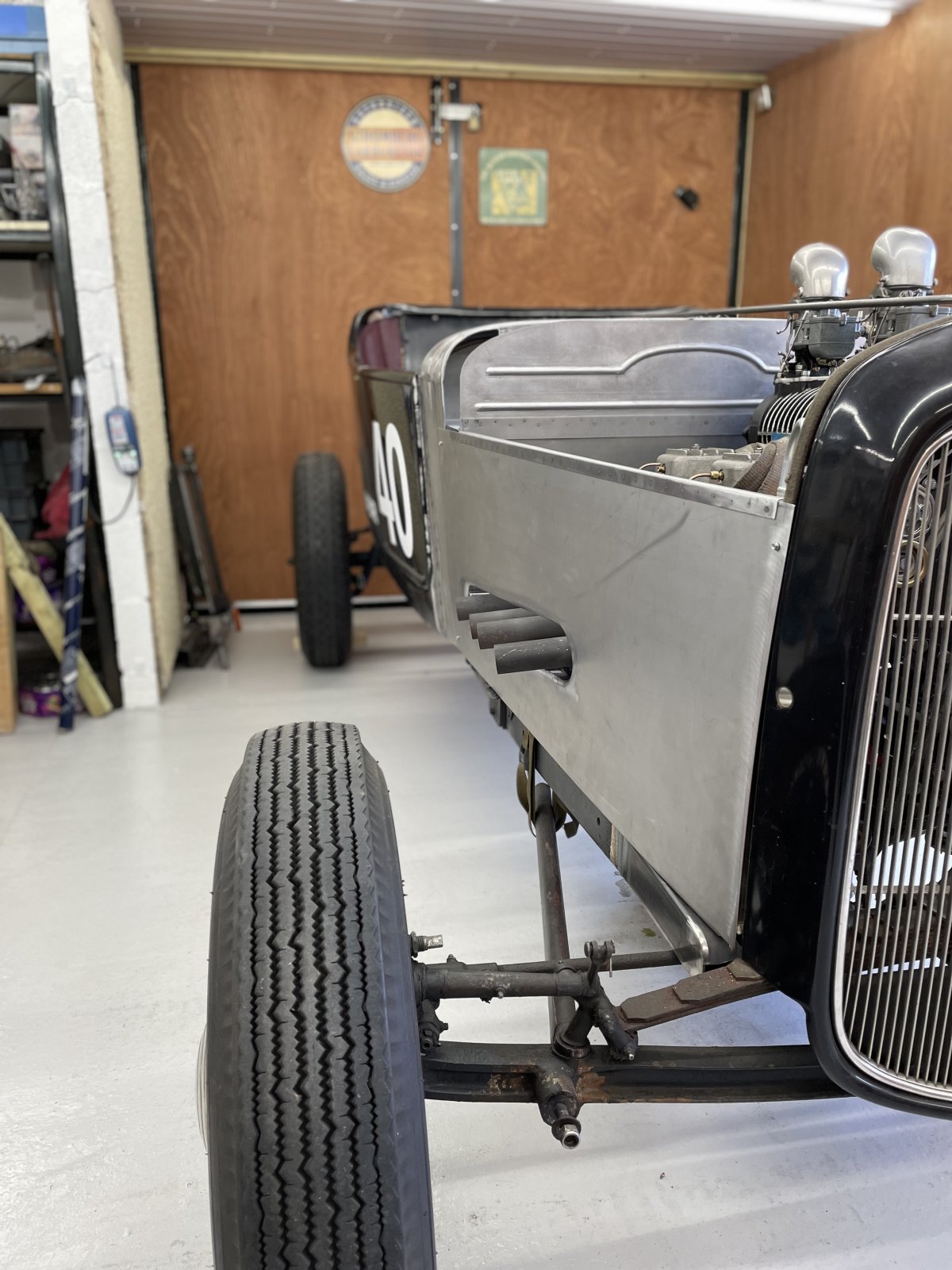

    42D16EC6-8348-4603-B3C9-DD5E752903F1.jpeg E9606E25-2F19-4083-8C48-1B9ECF513F37.jpeg
    New full width dash and small amount of cowl.
    BCA9B657-FADD-4734-A38E-6AD27CB8BD8F.jpeg C2533025-CDB6-4C40-B0CA-5D3992BF9ECC.jpeg 86E0D809-217C-46AA-AF85-4DA7A973D910.jpeg 4BDFE601-26FC-421A-B348-9088077F71E7.jpeg

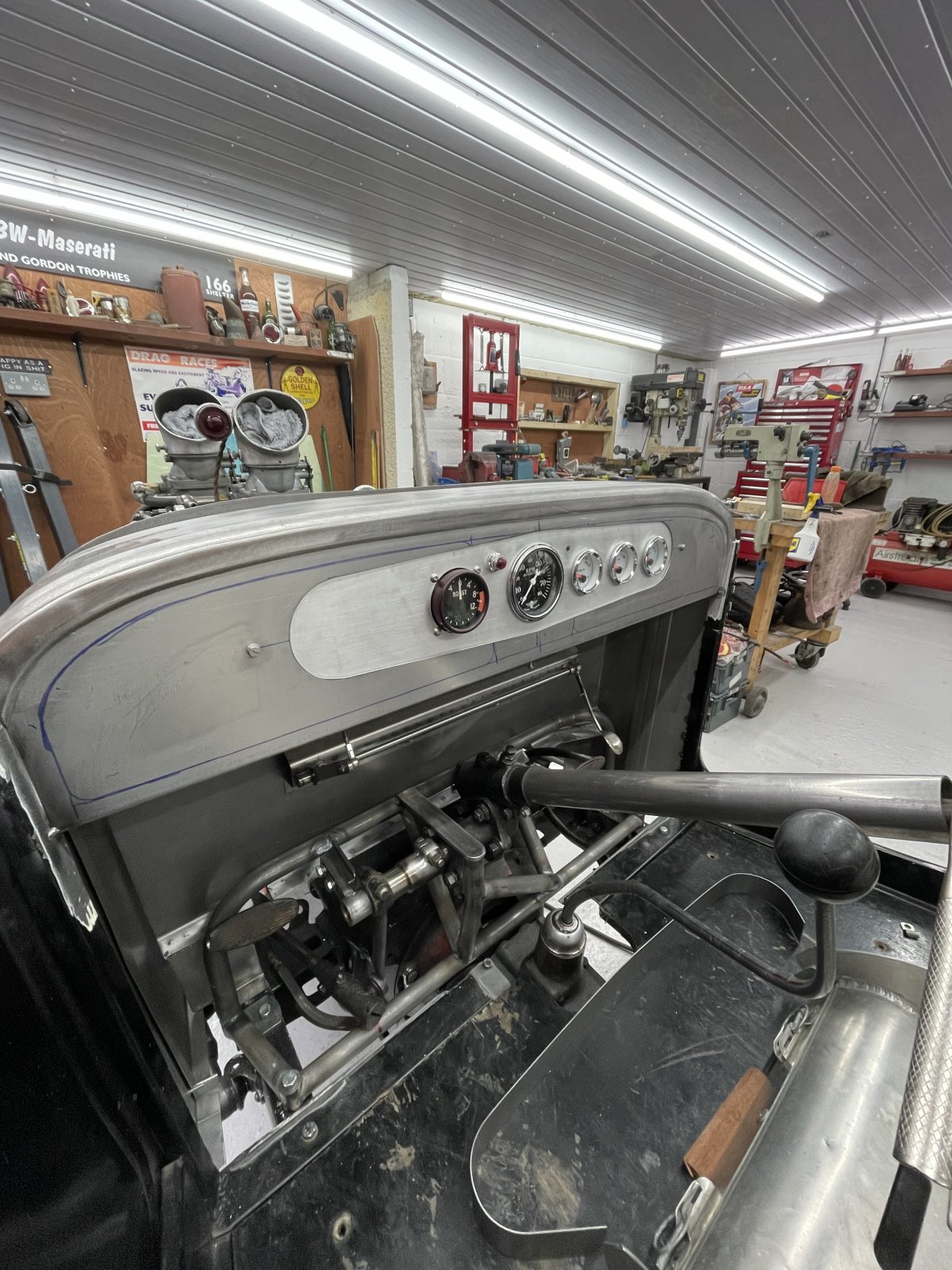

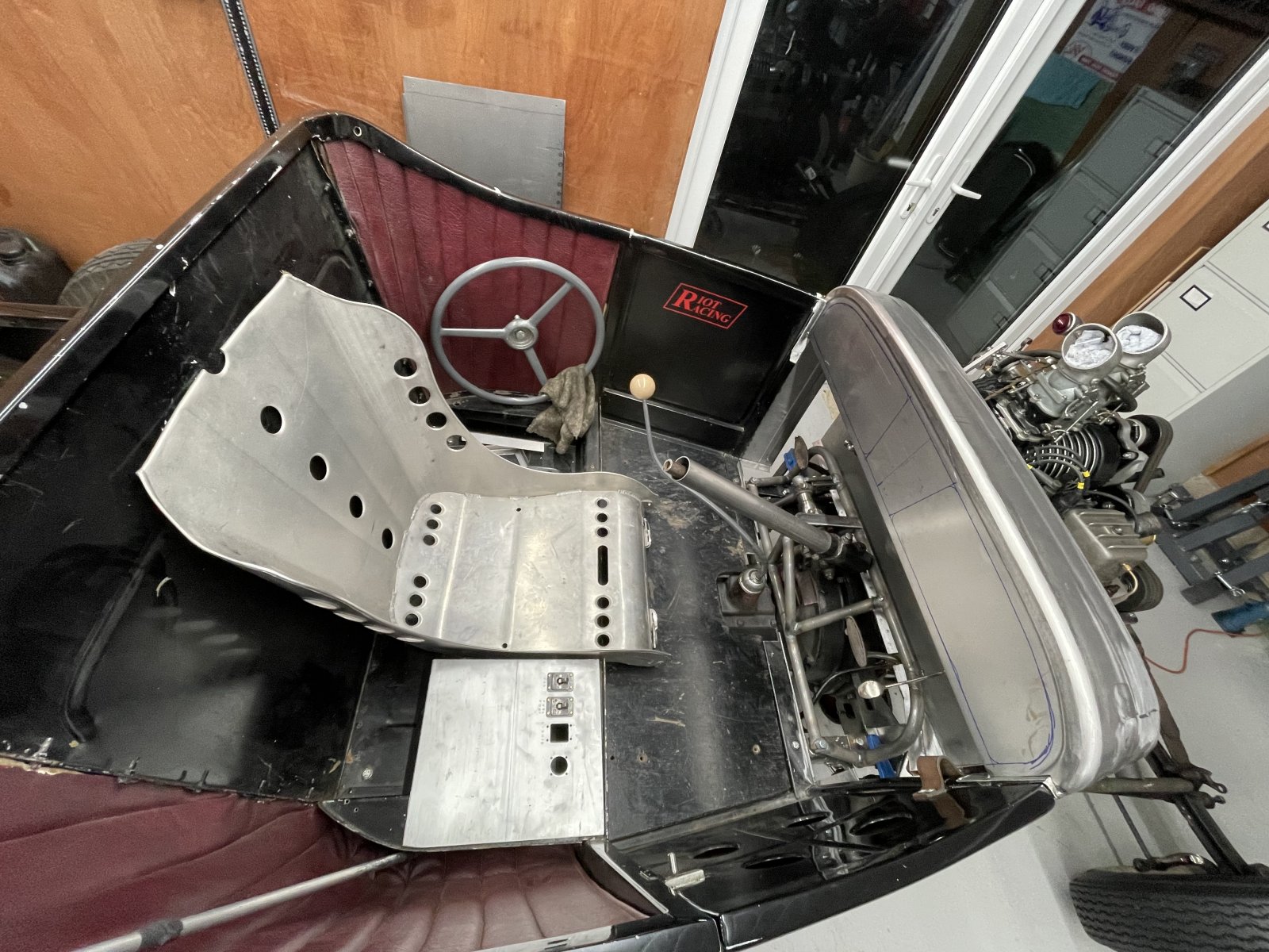

    With the seat mocked up in the central position and liking the idea, I made a sub structure to mount the original model A steering box. I didn’t want to go down the route of cowl steering and the bump steer that comes with it, so I mounted the box as low as possible on top of the gear box. I positioned the split wishbones in the centre of the chassis and with the drop of the pitman arm it all pretty much lines up with minimal bump steer.
    Got the throttle pedal mounted on the fire wall via a long rod on bearings
    17B2CB5B-DD84-4C19-8E45-583BC19E978A.jpeg 24F57AFC-F85F-4EDC-BD32-94532B782606.jpeg
    I modified my Louvre tool to press the old style louvres.
    BA360858-5EFE-456A-B20A-5AED08B578E1.jpeg 55EBD3F8-8B69-45BF-9BB0-4C0B71675652.jpeg 7A1AC507-5D4D-4656-B877-150B13CA8A1B.jpeg
    I cut the dash panel for a rear mounted gauge panel. The reason for mounting it behind the dash is that with an ‘L’ shaped panel I can fix all the electrical components in one place and it can all be removed easily.
    I also made a box for the switches that fits alongside the seat. This is because I can’t reach the dash when Im strapped in with the harnesses.
    Start on the hood top. A one piece construction that’ll just have some simple catches to hold it down. Cut out was made for the twin 97’s with a lip around for strength.
    I used the Rev counter from the old dash, found an old aircraft ( maybe) vacuum/boost gauge, but sadly due to lack of funds the other gauges are just cheap Chinese shite. I’ll replace them when funds allow.
    253EC4C8-599C-435C-967D-B09E02CBEE29.jpeg ADBD5D99-5431-44FA-A322-0F35167D12D8.jpeg 5828D799-47AF-4D90-938E-DAB0EEB0DE5D.jpeg A03D2573-F99B-4C2D-A900-EDFD9D3B277B.jpeg C261D308-C82A-45AA-9C0B-80291321C87D.jpeg B1C16FDE-EDB6-4B37-A115-5FA7F887CEF1.jpeg D1413E5C-CCDA-4DF4-A685-3588F3789AD7.jpeg

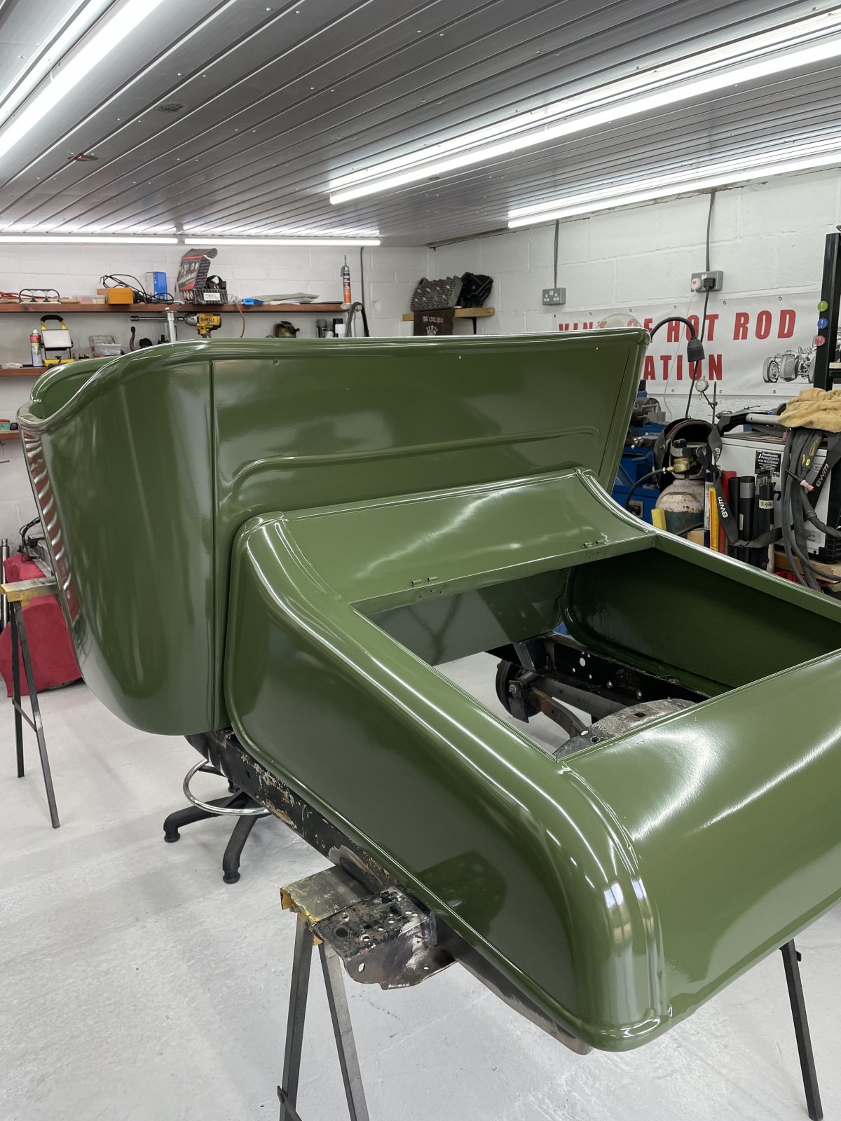

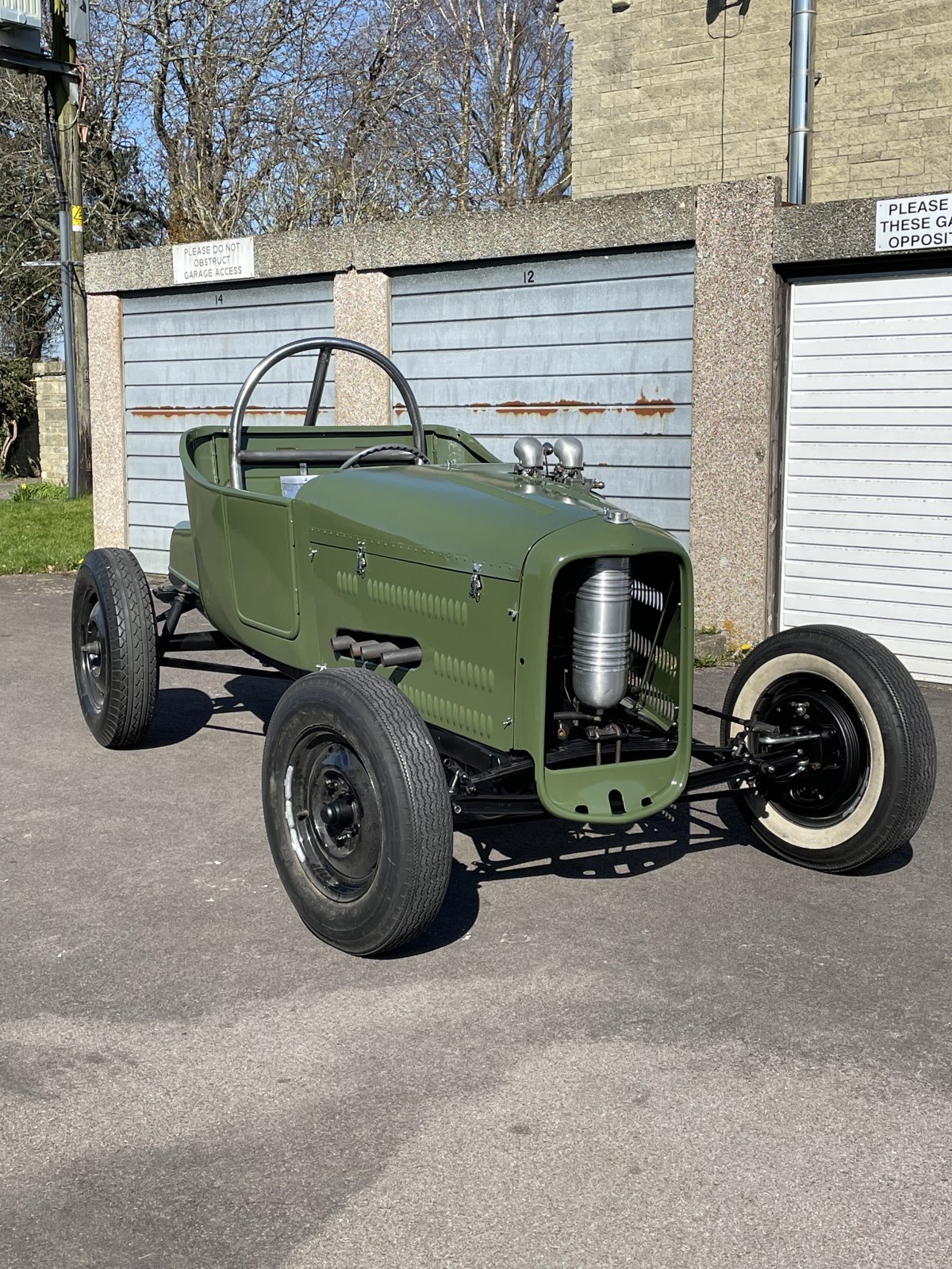

    With most of the bodywork roughed out it was time to sort some of the details and get it off to paint.
    I could paint it myself but time was against me, so I sent it out to a friend who owns a powder coat company.
    My brief to him was not to overdo it. I didn’t want all the imperfections in the metal work to be filled, but left as they were. What I wanted was for it to look like it had been painted by an amateur in a garage. And that’s what I got. It’s got 30% matting agent in the paint, so it doesn’t have that modern paint gloss to it, but it still shines. Perfect. C70BAA04-83F8-4256-A8A8-F9DD64A52519.jpeg
    57B0CA72-7132-41D6-8118-692F78CFEAFC.jpeg 37219BBD-F79E-483D-AAB7-63F6EC493F6B.jpeg

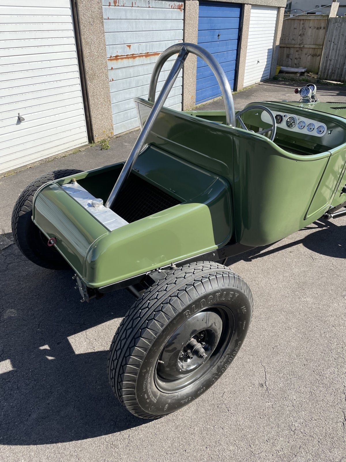

    Getting the car back together.
    I bought a cheap alloy radiator from ebay, cut off the tanks and fabricated new ones. The rad now sits on its side in the trunk.
    I had a roll hoop rolled.
    7EA28344-9EF3-42A6-BF8F-C12CE579C394.jpeg 1D8FADF6-7B6A-45BA-A6B2-7886F49AD922.jpeg 3E8EC3E7-9214-42FC-9041-05AA7A525B70.jpeg D609B67F-9FD5-4B44-B9D9-7283AE071C3C.jpeg 9C28EB0D-8673-4F6A-8A7C-D7CF52818BCC.jpeg C01339B4-4D00-408C-B6D2-E3E7E88874EB.jpeg CFFD24D6-5C41-4A5E-A170-6473E0DA9EBC.jpeg
    Simple seat hung from the roll hoop. High turn up on the front to stop me sliding forward.
    Alloy fuel tank fits in the rear section of the turtle deck.
    Radiator filler neck mounted to the motor.
    6571896F-4C4B-40E7-AA92-FBCBC84D64C2.jpeg 733EFDE5-9DC5-45D6-B0C1-BC1B4E53AA0E.jpeg A5FAE3A5-1817-4882-8048-56F7C41D3A54.jpeg 2E57B42D-20FD-4FD8-9C71-728ECB854AD1.jpeg

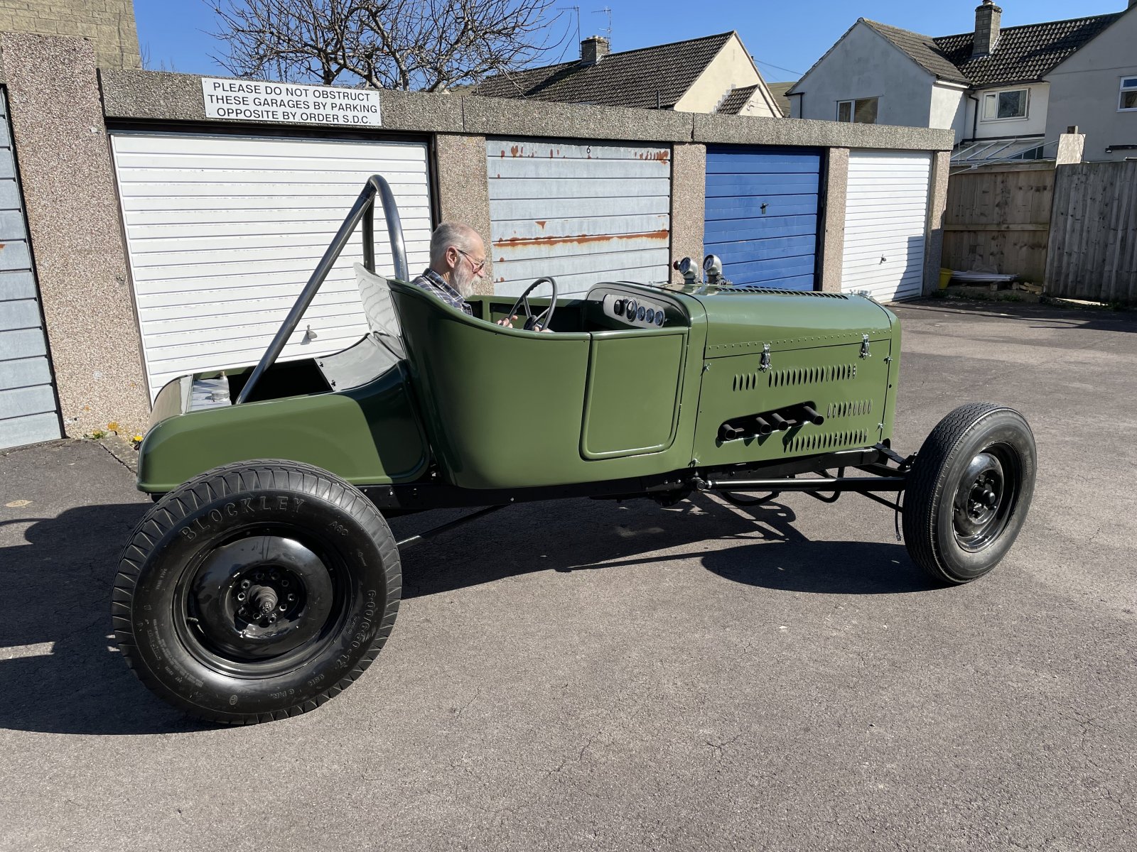

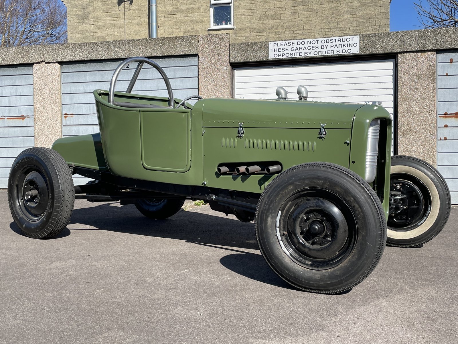

    That’s it up to date.
    Pendine is in 4 weeks so we’ll see how it runs.
