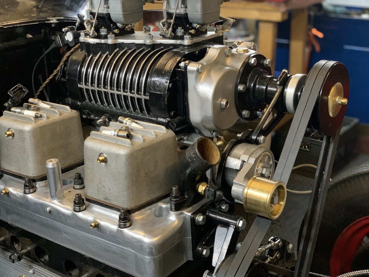

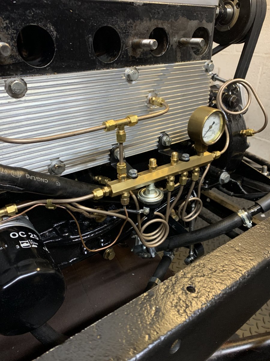

    @nutrocker Stunning craftsmanship! Are you concerned at all about the oil pump hanging down so low, or maybe it just appears to be due to photo angles. Just in case a rock gets tossed into the pump drive and throws the belt, I'd consider a low/no oil pressure engine kill switch.
    loudbang and nutrocker like this.

    It’s always a concern that something could knock the belt from the pump. The photos don’t show, but there is a pair of rings that fit either side of the pump pulley. These stop the belt from being able to come off the pulley.
    There’s always a risk with a setup like this, hopefully the worst won’t happen.
    The low pressure kill switch is an interesting idea. I do have an oil warning light mounted on the carbs directly in my eye line.
