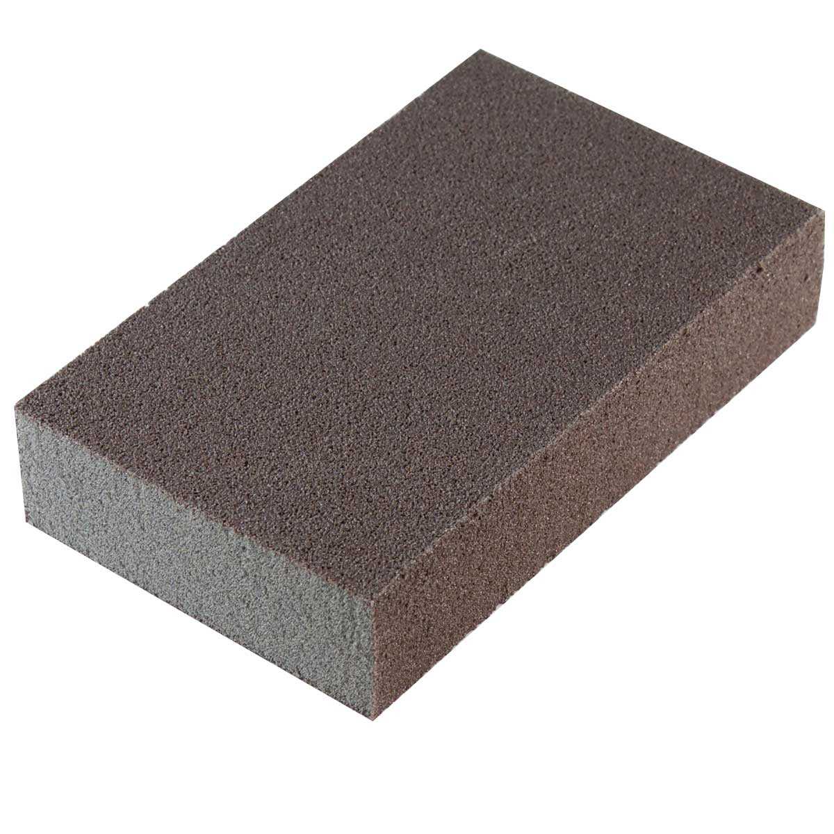

    I use these. I wrap my sandpaper around them. Works great. Use them almost daily. Lowe's or Ace hardware. They are sandingsponges 14340_media_1.jpg
