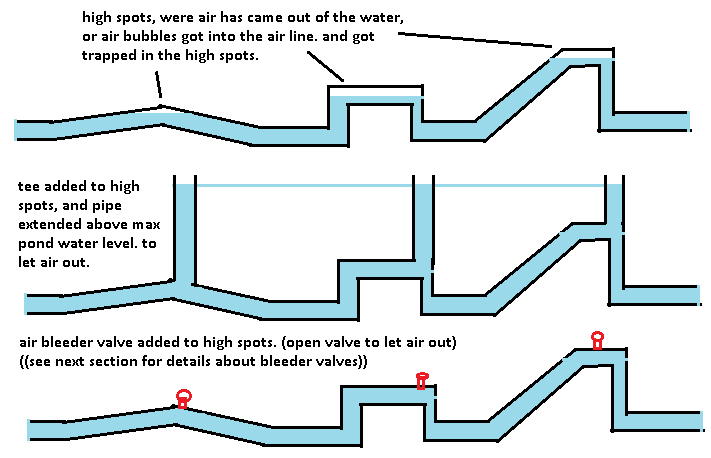

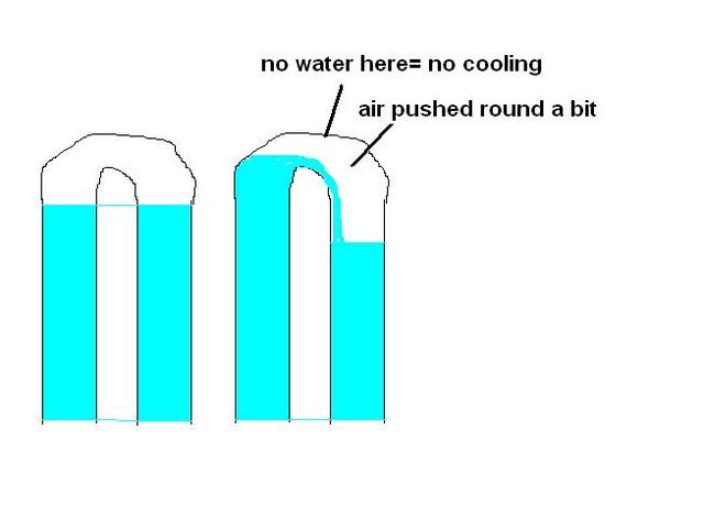

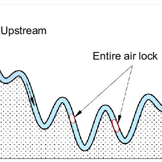

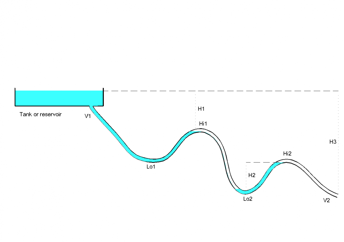

  26. Maybe I should be knocking on wood here but I’ve never ever had this kind of trouble EVER bleeding a brake system. I will say that I’ve alway had help though, experienced or 10 year old kid, think I might have grabbed a crackhead more than once to help. That’s because I tried the prop stick and it pissed me off.
    I would kinda like to use a power bleeder once because it sounds cool but so far there’s not been a need.
    Here’s some of the rules I follow. Maybe they will help you guys. All of this I learned from my dad before I graduated high school.
    #1, I don’t do or make anything like this so I won’t have these elementary air locks. (yeah I posted some of this in the smart fluid thread.
    When you let the pedal back up,,,, where does the fluid go and how does it get there?
    3470E8F5-F255-4982-83DC-4663B7839C91.jpeg 1F4253BB-3085-4D98-85DC-5E75A9FFDB63.jpeg
    don’t go up and over an obstacle.
    does anyone see that as a brake line on a frame rail?
