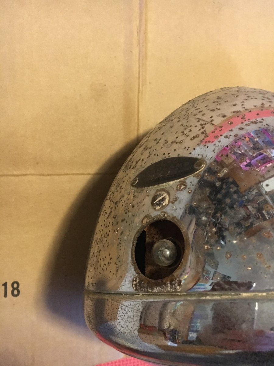

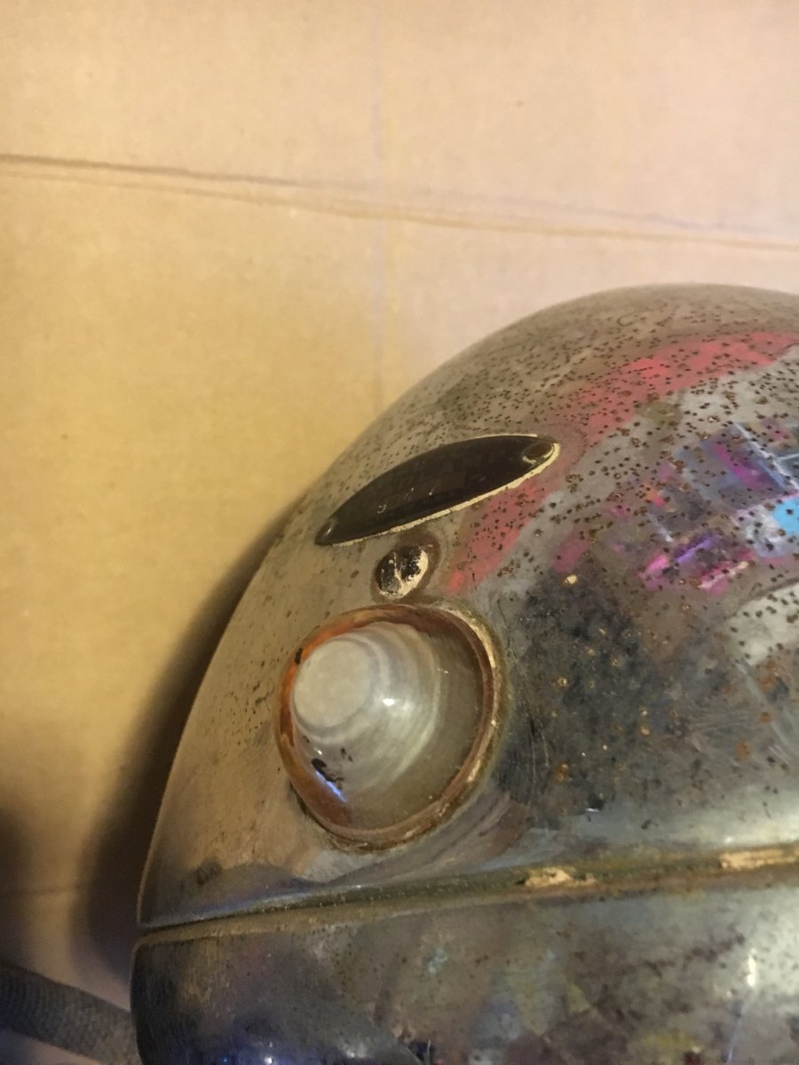

    This may have been talked about before, but has anyone made or adapted something to work for the little dome parking light on top of the 904-A headlights ? i realze they are scare

  10. When you finally find a lens, get rid of the spring retainer, if it hasn't rusted away already. I use a rubber o-ring to secure the lens. I don't know where you live in Connecicut, but when I lived there I went to a commercial rubber / o-ring supplier in Newington, off of the berlin turnpike. And he had what you need in stock for about $ .50 each.

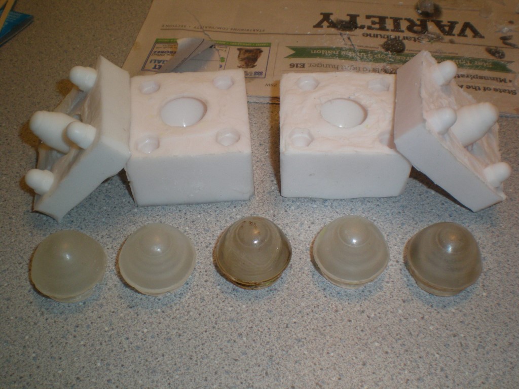

  14. Silicon mold and resin works.

    Wow, great job on the lenses.

    You should make some for sale! Maybe you already do? I might be interested. Surely others would be too as many requests as I have seen for them.
