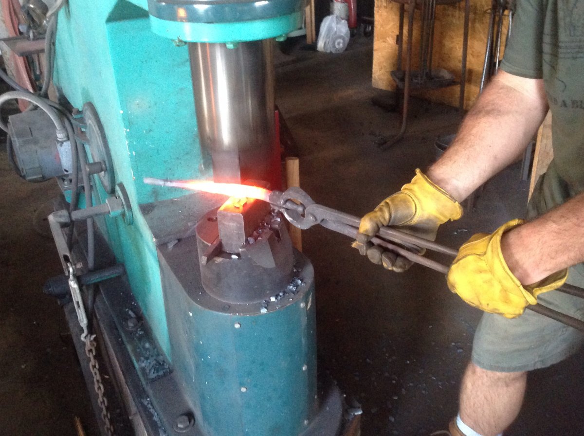

  1. image.jpg i was trying to come up with a decent looking shift shaft for my truck and just didn't want to go with something off the shelf or some screw on extension so I decided to have a blacksmith shape the existing shaft. I can't take credit for the idea of having a blacksmith stretch and shape a gear shift shaft as it came from a fellow HAMB'er, but I'm quite happy with the results. Here are some pics of the process. First blacksmith David Collier, hit the threads of the T5 with a grinding wheel.
    Then he heated the entire length of the shaft to even out the hardness so as not to fracture it during stretching. image.jpg

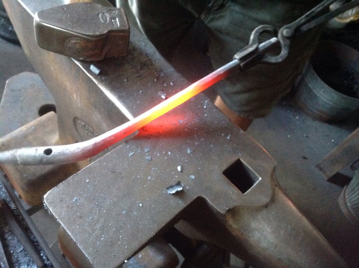

    Then the work begins with the hammer and power hammer.

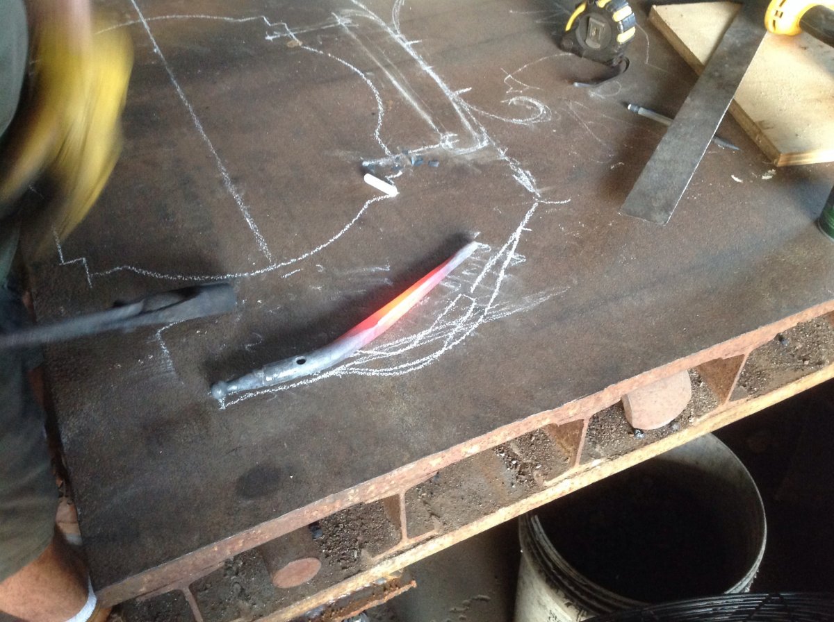

    We traced out the original shape and what we hoped to get when finished. If you look close you will see the original shape and the final length (at hash mark)
    Starting to take shape....
    Got the length desired.
    Putting the bend in the shaft.

    Only one question... did he heat treat it to get the hardness back? If not, you are going to have some trouble down the road as the shifty part in the transmission starts to wear away...

  20. Thanks for all the comments guys. And yes that anvil of his is a beauty. He owns 8 anvils because he teaches classes on forging but this one he said he bought new and ran him $2000. Regarding the hardness issue, I don't think he put any hardness back into the shaft, but he did let it air cool to even out the metal. Not sure if that was done to prevent brittleness? Im not sure I will have any issue with the shaft wear as the shaft sits in a plastic ball socket that I greased up real good and the tip being round makes contact with a metal socket that has a curve to it as well. I guess time will tell? I'm waiting on an adaptor bushing from1954 Designs ( as soon as they answer their emails) and will install my #99 HAMB shift knob!
