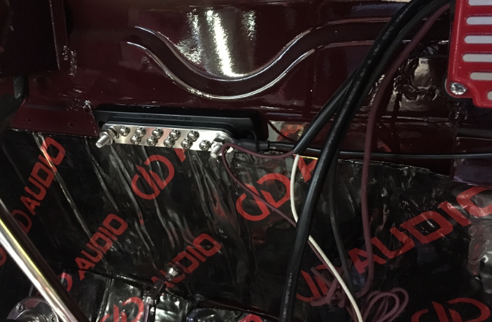

    Grounds are your friends, well not in your coffee but under the dash at least. I added two of these to my car, one other the dash and the other in the trunk. The are marine ground busses and I cabled them to the frame.
