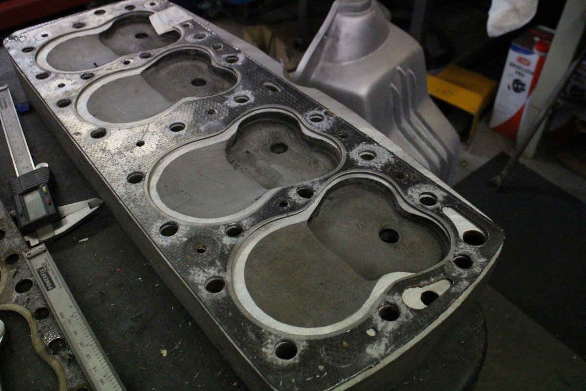

    Offy heads are bigger job. Today I started to work with them. Need to "cut" 2mm from chambers.
    High lift cams are not work with old 40´s-50´s heads.
